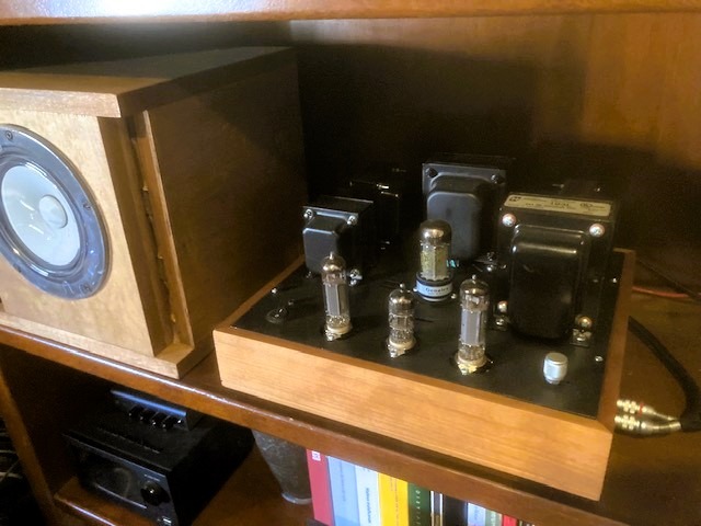

I also recommend RH84. I'm no expert but after building 4 amps including a 300B I have to say the sound is very good indeed with my Dave designed Alpair 11.2 MAOPs (yes the ports haven't been bevelled yet). It is also very simple to build. I tried the first version and also rev.2 with zener and LM317. Not much different, perhaps a vaguely sweeter sound in the first version.

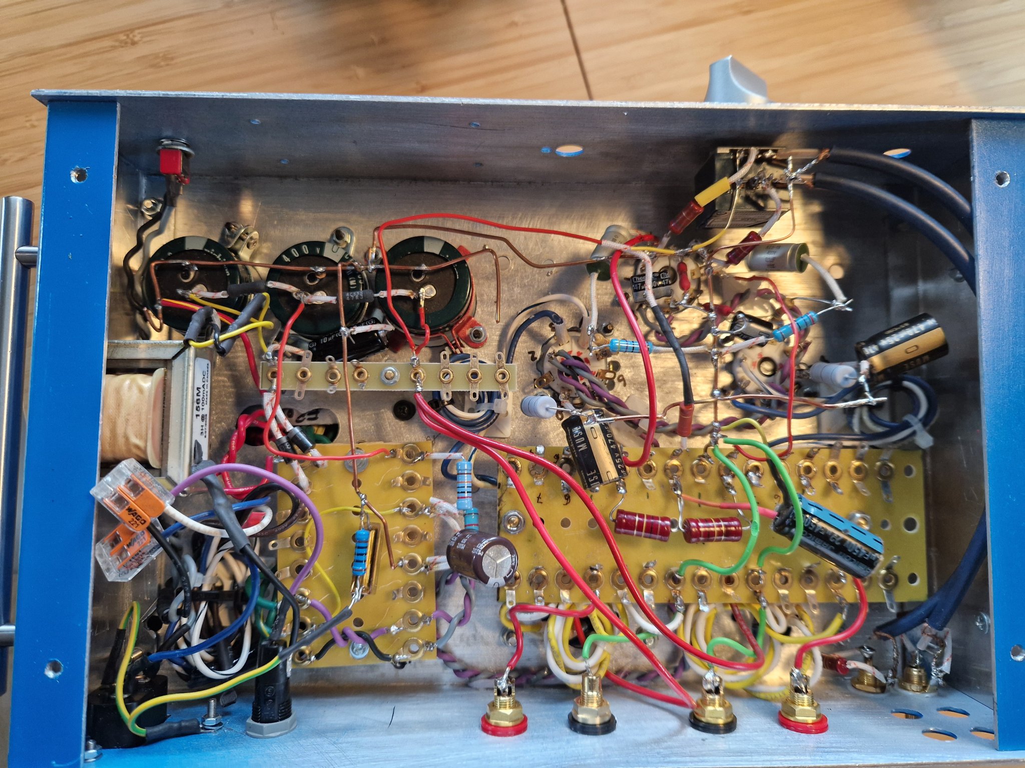

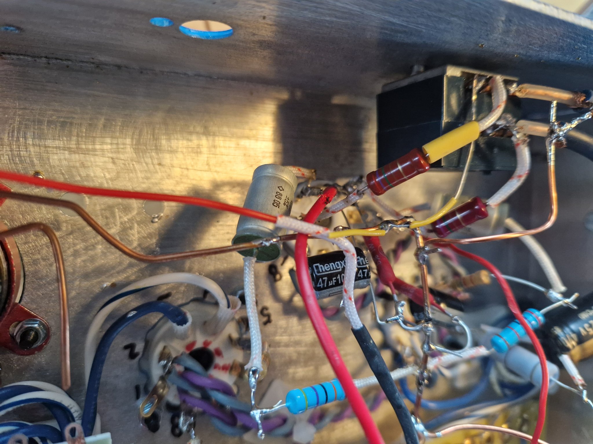

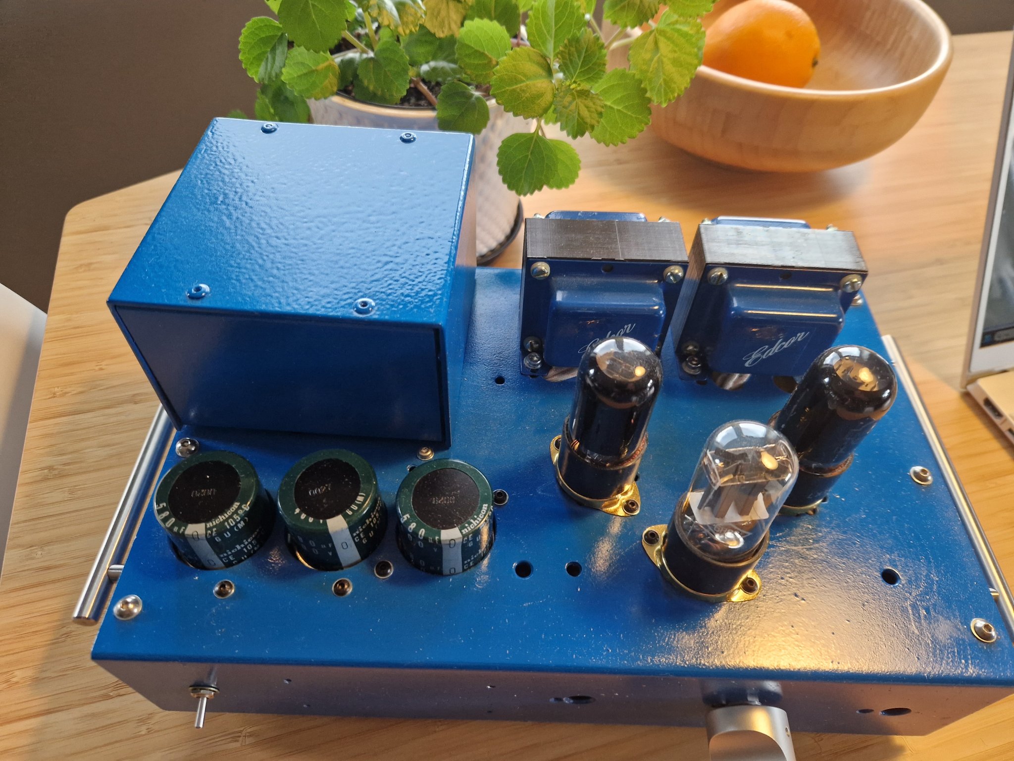

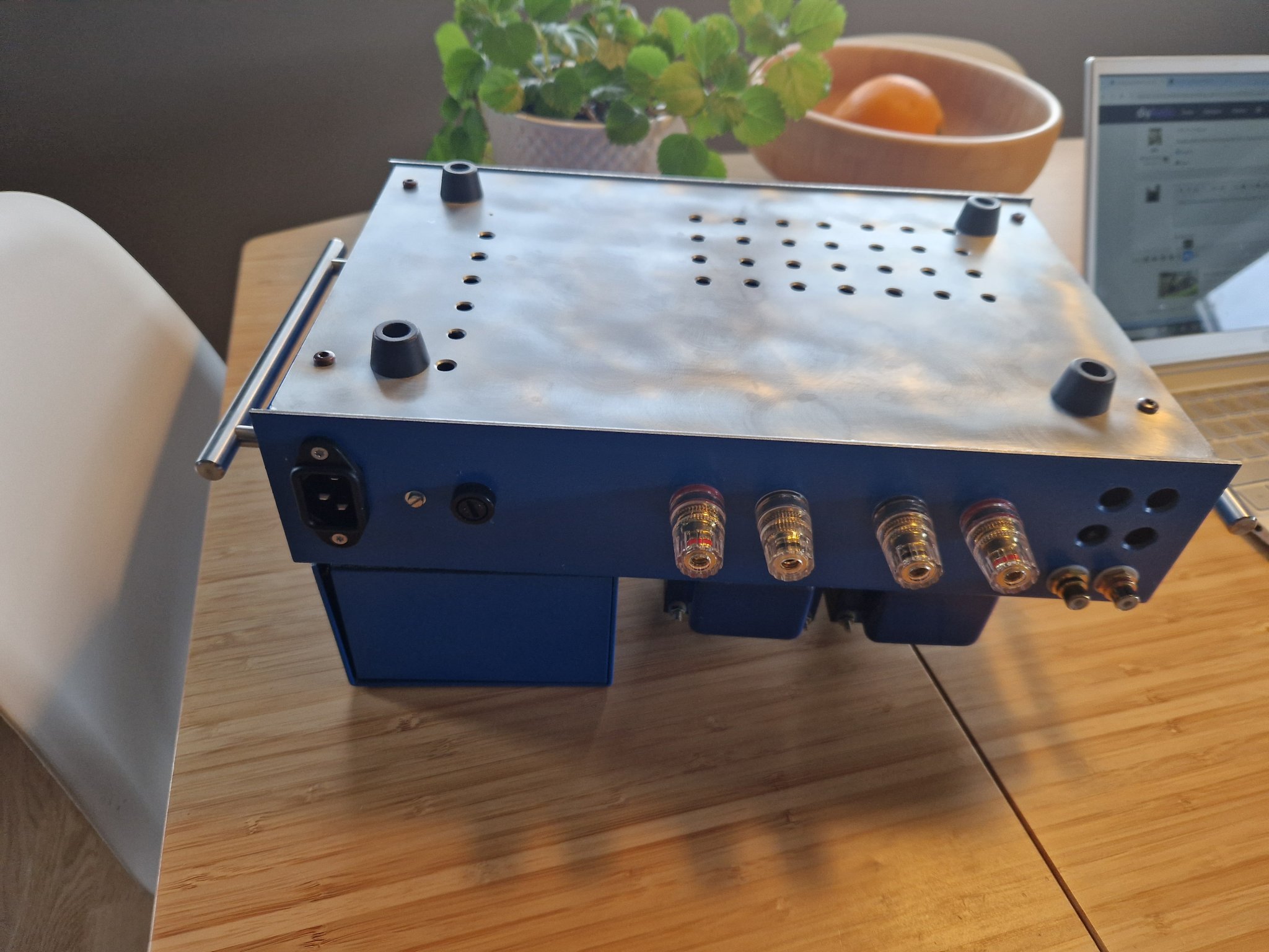

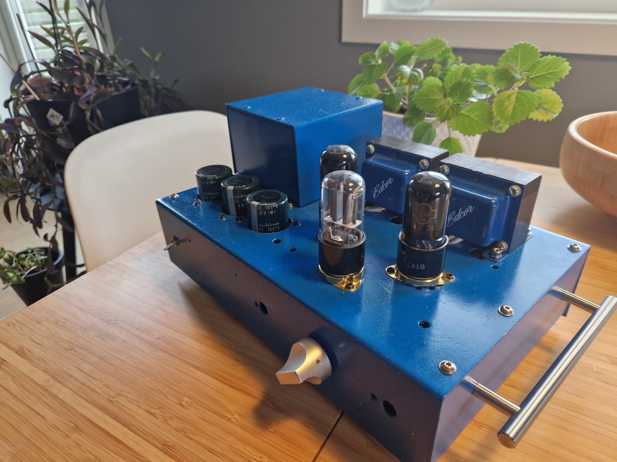

https://www.cascadetubes.com/the-6v6-lacewood-amp-v2-0/ I have built this one. Point to point soldering. Hammond 260E and Edcor output transformers. The intention was to mount an input selector, but it was never done. Sounds very good. Diode rectification, a bit messy? layout?, but the amplifier is without noise and hum. Have had, made many red and green amplifiers, so it turned blue. "The Blue One". Can really recommend DIYers to build it with point to point soldering.

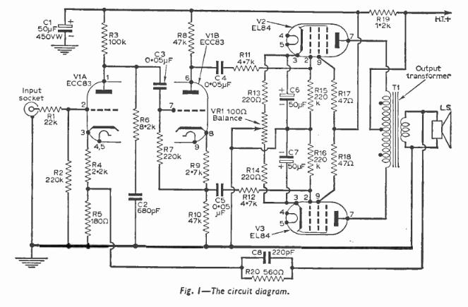

There used to be magazines for exactly this sort of request. Page 390: https://www.worldradiohistory.com/UK/Practical-Wireless/60s/PW-1962-09.pdf
