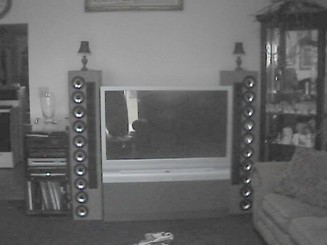

Ya i was thinking of something like that before and then got bitten by the OB bug THEN the TL bug... and then the Point Source open baffle bug. Thankfully my softer side with the loud shrill voice inocculated me from further Open Anything Flu's .
Do you still have your design and drawings and info on what speakers you used ??
Ten 5 1/4" Dayton Aluminums per side;
http://www.partsexpress.com/pe/showdetl.cfm?&DID=7&Partnumber=295-330
6 Dayton Planars per side;
http://www.partsexpress.com/pe/showdetl.cfm?&DID=7&Partnumber=275-085
Crossover was a 4th order Bessel at 2500 hz.
Box Qtc came out to be 0.59 sealed.
I started with passive radiators then 4 different ported designs and ended up sealing the back and going closed. That's before I learned about room gain, port noise and passive radiators also passing along midrange information out of phase with the fronts.
it's 56 inches tall, 11 inces wide and 14 inches deep with 4 baffles inside to break up standing waves and properly load the woofers and also add rigidity to the box. Sides are 1 " thick - Front, Back, Bottom and top are 1 1/2" thick. 1st ply MDF 2nd ply oak plywood.
The new arrays I'm starting to build will be with the new Dayton RS 7 inchers with B&G Neo PDR's. 10 of each per speaker and it'll be about 74 inches tall crossed over at 900 hz.
Why am I doing this if these sound so nice??? I'm going for overkill.
I've turned into a speaker nut!!!
