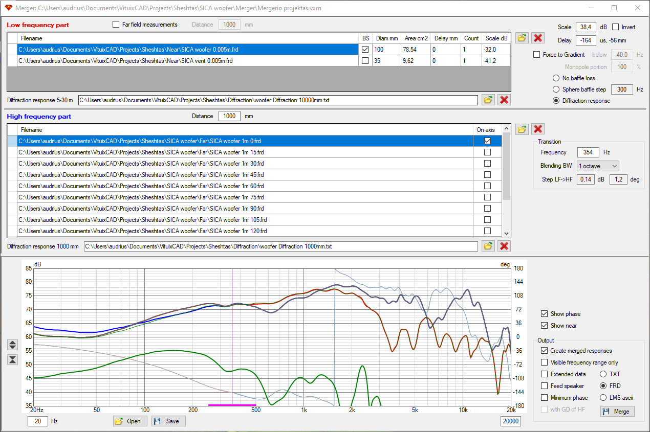

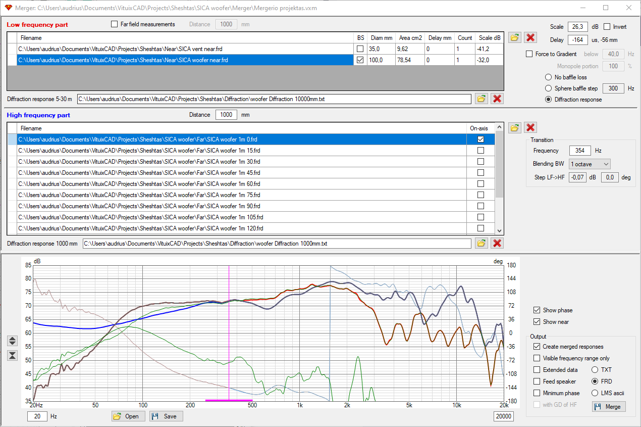

I have saved the merger project, but If I post it - not much is seen. The whole project could be an option, but there may be harder to understand my "mess" than to make 4-8 different measurements.
Screenshots, probably near-wall and mid-room is the opposite, as I did not saved .vxp project for each version 🙁

the responses of both woofer and port are very different for near-wall measurement. there is something odd going on.
the mid-room port output has a clear peak at 80 Hz, but only a very round bump at 150 Hz for the near-wall measurement.
This is definitely a measurement or speaker setup issue, nothing related to vituixcad.
Also there should usually be a slight valley at tuning frequency for the woofer nearfield measurement, unless you have a very low Q bass reflex tuning.
The mid-room measurement has a slight dip, but the resonator still seems to be quite lossy because of overdamping or air leaks.
I would think the" high tuning" and the very round highly lossy "peak" of your near wall measurement indicates there was a problem with air tigthness of your enclosure.
EDIT: are you sure you did not set the gating times too tight for the nearfield measurement at near-wall setup? that could also have a similar effect and the very smoothed appearence would indicate that too!
