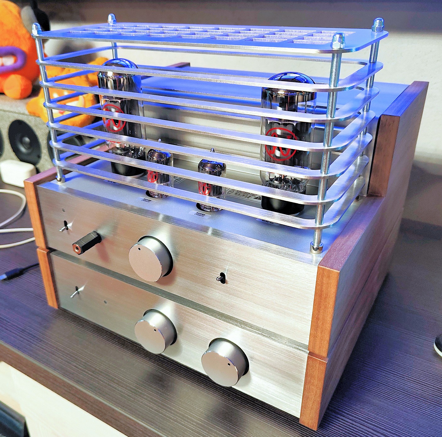

Looks very nice, Gorg. Less industrial than the original, with a touch of 'Metropolis' futurism from the cage. Is that a brushed aluminum front plate? I assume all three plates are on top of the original steel housing? How are they attached?
And the tube cage, aluminum with steel rods? Is it just sitting on the housing?
The headphone adapter, if left in permanently, will turn the speaker outputs off (and instead leave the four 3.3 Ohm resistors connected); is that intended?
Thanks for appreciation of work. Front plates are 1,5mm thick brushed stainless steel. Both front plates are made to be attached instead of original plates with the original screws from the bottom. It is three pieces work - front plate, top flat bar and bottom plate with screws cutouts - all welded from other side to get U shaped panel - like original. The cage is also made off stainless steel. Each frame has holes in corners, assembly is made with threaded rods M4 and steel distance pipes with threads inserted between plates (such distances are made by Hettich Germany company - used here are M4x15 and M4x18). Cage just stands on top and delicate fixing is obtained by very small magnets with force so small, it will not interfere with tubes or internal electronics.
And what comes to headphone adapter - yes, it turns off speaker outputs - I am mainly using headphones for listening - high end headphones are cheaper than high end speakers and give more precise reception 🙂
I see, steel. Did you weld that yourself, or is it a one-off, or does somebody online offer these pieces?
How are the wood sides attached?
I have welded myself with a special flux for stainless steel and ordinary soldering station using just ordinary Pb/Sn tin - heavy work taking into consideration precision and necessity to keep 90 degree angle between parts as such "welding" drags a lot. Wood panels are screwed from inside via holes made in sides of amps.
