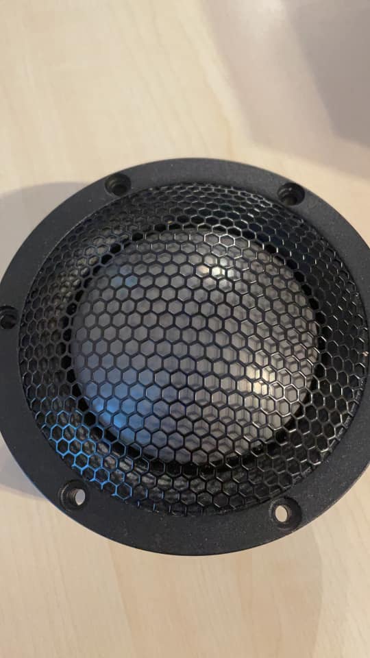

BlieSMa have anounced new 3" dome midranges:
I wonder if I could hear a difference when crossed under 3khz with 24db or steeper slopes when levels are matched. They all seem to work well below that point. Looking forward to the review!
The Al/Mg with the peak tamed would work quite well as a mid-tweeter for a small acoustic guitar/cello/bass amp. Paired with a Hypex plate amp and Purifi driver....clean broadband 110db peaks from a tiny point source package.
Prices have been posted on the DIY Loudspeaker Pad on Facebook for the Bliesma 3” dome mids with availability from Feb/Mar 2022.
380Euro for the Silk/Paper/Aluminium and 650Euro for the Beryllium (each).
Bit to rich for me (have to add import duty/VAT and handling, close to Volt 752 territory for the basic three) so will be sticking with the EM1308.
It is indeed expensive, but honestly I was expecting even more for the berylium version, since the T34B is already around 400€ per piece in Europe, and has a much smaller diaphragm.
We will see if their measurements are worth their price !
Pair of Volt 752 costr 1090 euros for a pair (VAT included).
Bliesma M74S/A/P will cost 920 euros for a pair (VAT included).
So a 170 euros cheaper per pair. it is worth it even if it measure the same as Volt 752 - though i do expect much better performance out of neodimium magnet and modern motor design
Better for less? Winner winner chicken dinner.
