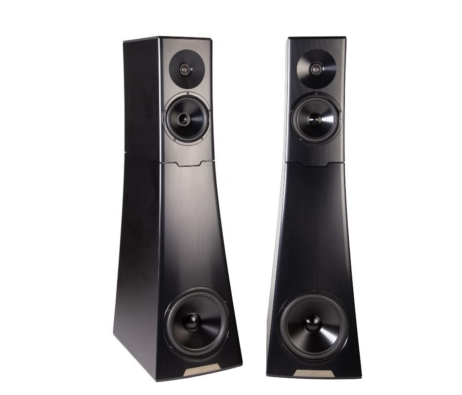

Regarding waveguide. Some time ago, I got the opportunity to listen to the YG Acoustics Hailey 2.2. What stood out was the dispersion... it had one of the better I've ever heard. I don't have any driver data, but the waveguide they use in combination with a flanged baffle was part of it. So a waveguide like that has been on my mind for a while.
It uses a 1", 7.25" and 10.25", mid and woofer is Alu while the tweeter is their textile dome. - very nice performing loudspeaker.

3. Doing a 3-way inspired by YG Acoustic Hailey 2.2 with tapered tube absorbers (Vivid Audio style).
