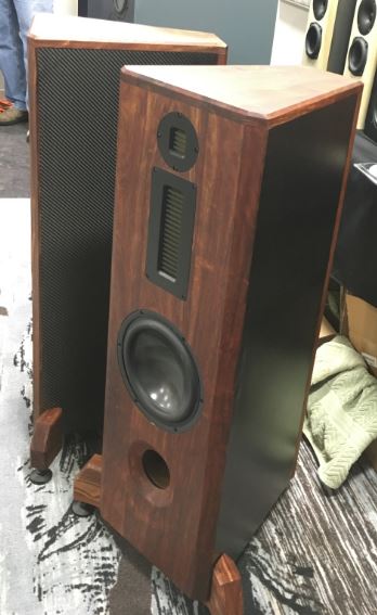

Anyone have some thoughts on good use cases for the AMTPRO-4? I've always thought it looks like an interesting driver, but I have a hard time seeing how to use it since it starts becoming directive on the horizontal axis above 3-4 kHz and it doesn't seem like it would want to go much below 1 kHz at any volume. Maybe pair with a 3/4" tweeter or something like Dayton's AMT Mini-8?
These were at the Midwest Expo in Des Moines last fall. They were some of the finest sounding speakers I've ever heard.
I think you mean vertical axis. After experimenting for a while, I put my pair of PRO-4 drivers away because of this.
The PRO-4 might be good without a tweeter in a 2-way desktop speaker. Sitting at a desk, you'd always be in the sweet spot, so the narrow verticals wouldn't matter.
It seems like a very nice implementation of AMTPRO-4 and AMT2-4🙂
Yes. Maybe I should retrieve mine and try a similar layout. I'd use a conventional tweeter, to get higher sensitivity than the mini AMT.
