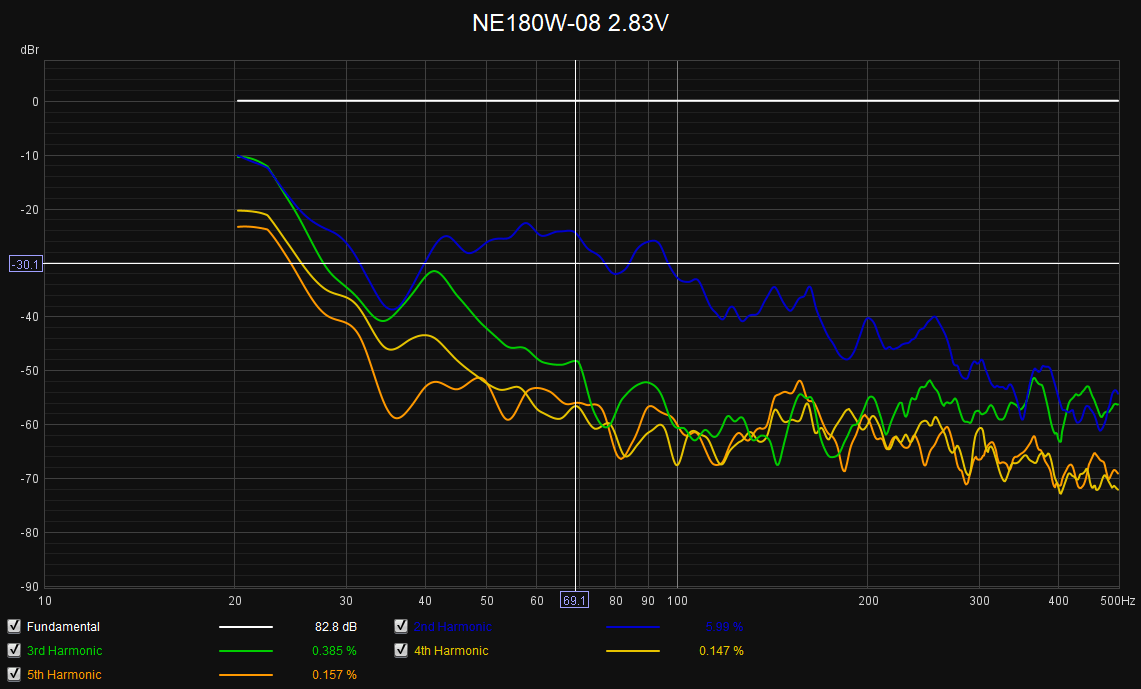

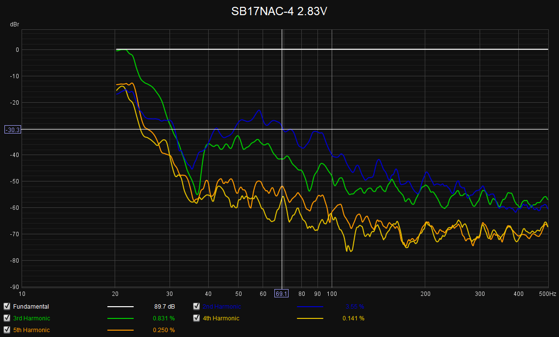

Hey, NE180 3rd harmonic is very smooth and only half of that of SB17!I’m not as enthusiastic about the NE180W-08

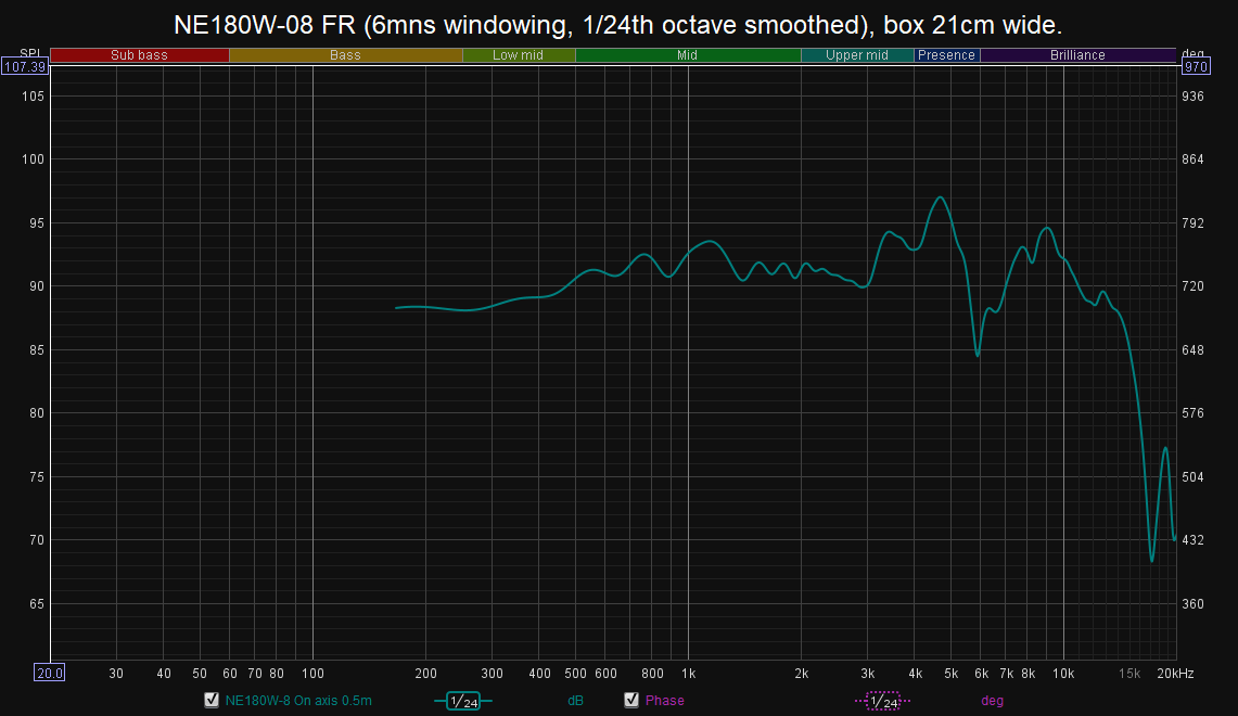

I investigated this driver as a potential candidate to turn into a coaxial due to the 40mm VC. Buoyed by @TMM ‘s measurements, I purchased a single unit. My build date was fairly recent; but it measured more like Zaph and @HiFiCompass ’s samples- not as smooth as Tim's measurements. It would be a challenge to flatten the FR without DSP. The bass is certainly better than the SB17 though.
View attachment 1218110 View attachment 1218112 View attachment 1218111
Both measured in same box (0.7 cu ft sealed with baffle 17" H x 8 1/4" W, and same conditions (50cm, 6ms window). These are not anechoic quality measurements, but gave me enough data to not move forward with it.
All in all, measurements more similar to Yevgeniy's than Tim's.
Anyhow, of little consequence now. I wasn't sure whether it's worth my input on this- it's NLA.
@Juhazi
Yes, SB15 & 17N(B)/CAC has better linear distortion performance than NE149/180, but not as good non-linear distortion performance below 200Hz.
