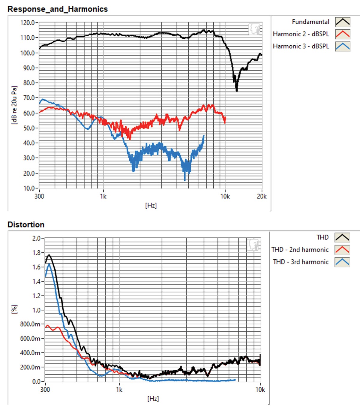

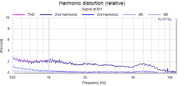

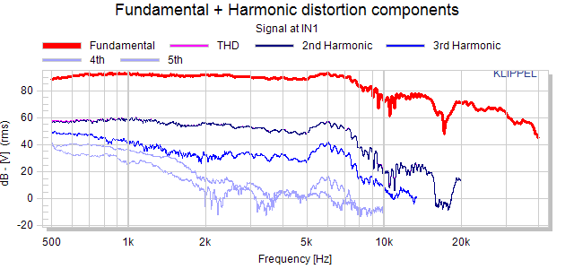

Hey guys, I've been enjoying reading you for months now and I have a question on how to measure drivers, and let's take TB Speaker 75-1558SH as an example.
Review by Voice Coil can be found here
FR/THD measurements :
I'm not an expert, but THD is very low...cool!
But, when I compare the measurements TB sent me by mail :
Hmmm not as good.
So I asked why, why such a difference between the two :
So different way to measure lead to different results. But where is the truth? Anyone already has this mid-dome?

The truth is at hificompass.com🙂.Hey guys, I've been enjoying reading you for months now and I have a question on how to measure drivers, and let's take TB Speaker 75-1558SH as an example.

Measurements from different sources can never be the same due to different hardware, software and measurement conditions.
Sound pressure levels are very important here as well.Hey guys, I've been enjoying reading you for months now and I have a question on how to measure drivers, and let's take TB Speaker 75-1558SH as an example.

Go have a look at hificompass website and see the difference at different voltage levels and how the different distortion harmonics shift from each other.
This is why just one THD graph at one SPL doesn't say much at all.
But yeah, in general, measurement conditions say a lot, especially when done @ 1 meter
Nearfield measurements would at least give a very similar shape.
Never trust a linear THD scale 😉 (log makes way more sense)
Voice coil measures at 2,83V as far as I remember? TB probably a little more - but 2% is a lot for such a driver. The old ones where better and they should be very similar. TB only measured from 500hz on, so the interesting part is missing. I don't trust their measurements at all, tested a few drivers and never got close to what their datasheet sayed. Maybe better now with a Klippel system?
But the Voice Coil measurement shows to less K2 in my opinion. These "weak" domes always produce some K2 - so the truth will be somewhere in the middle.

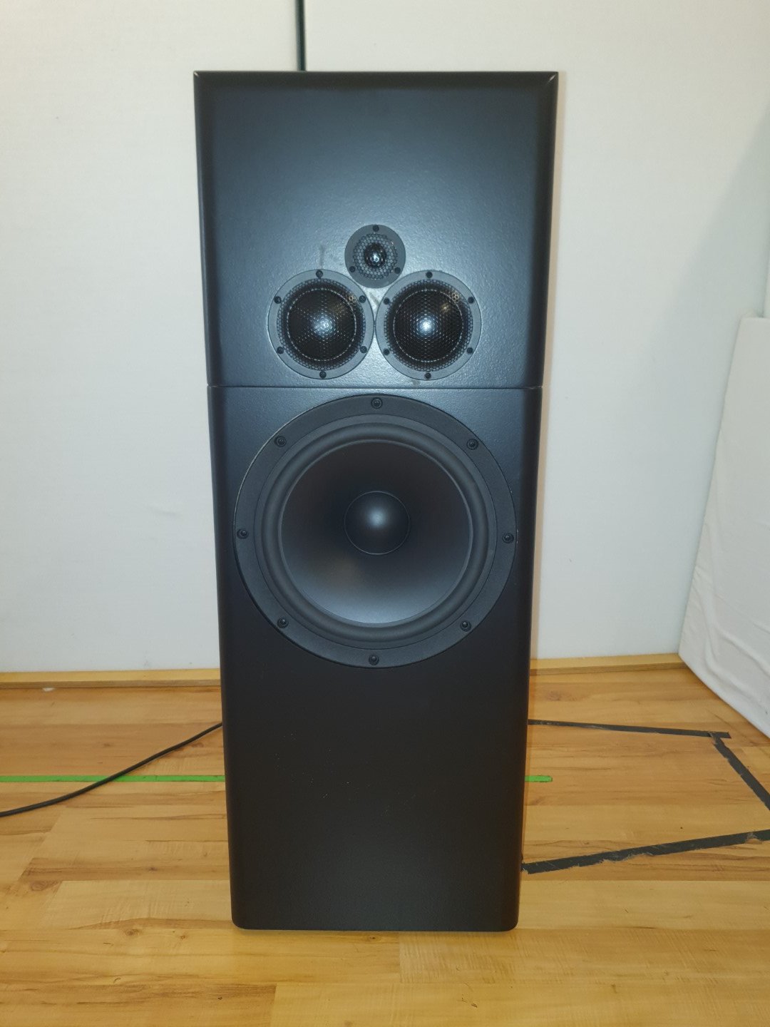

They are great drivers. Here a picture of my test setup of a listening comparison between silk and alu version.
Ahah! nice way to compare!

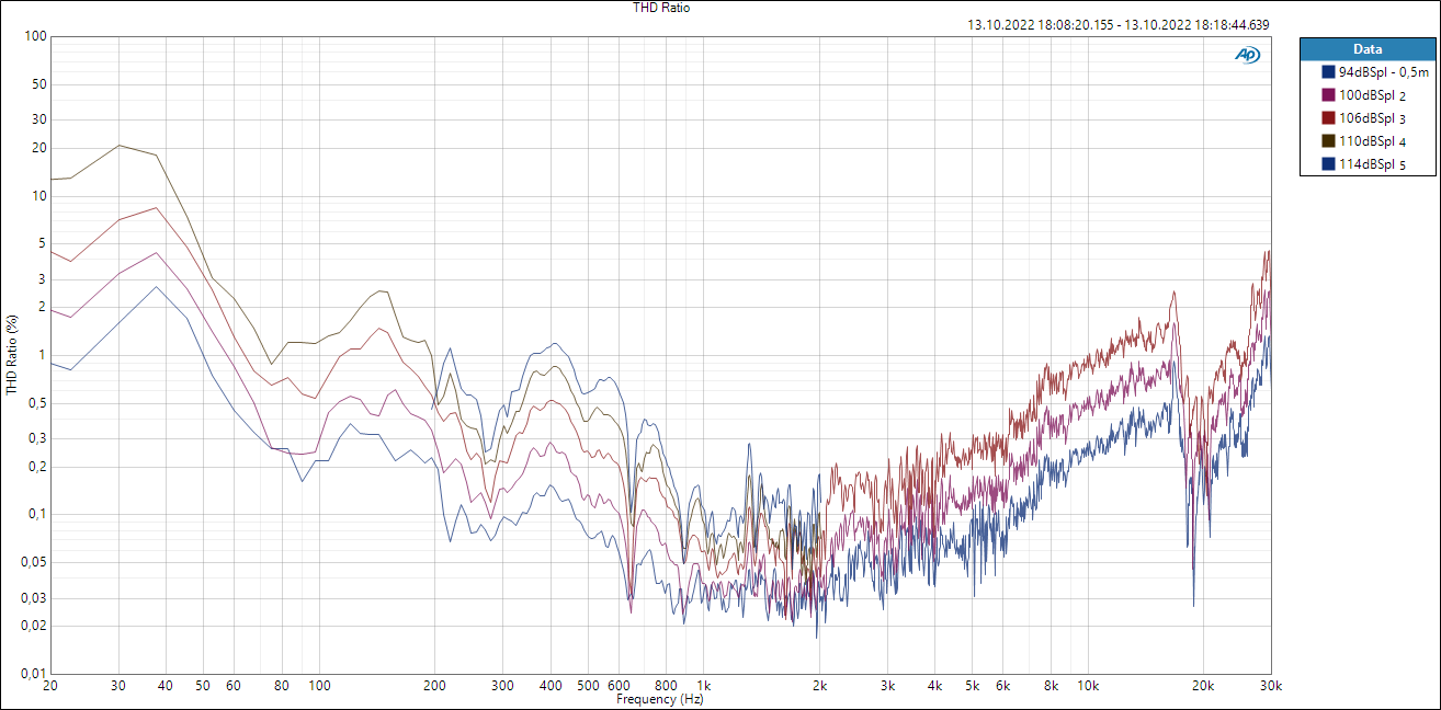

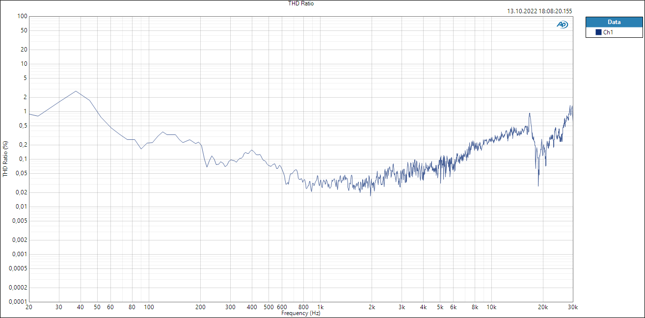

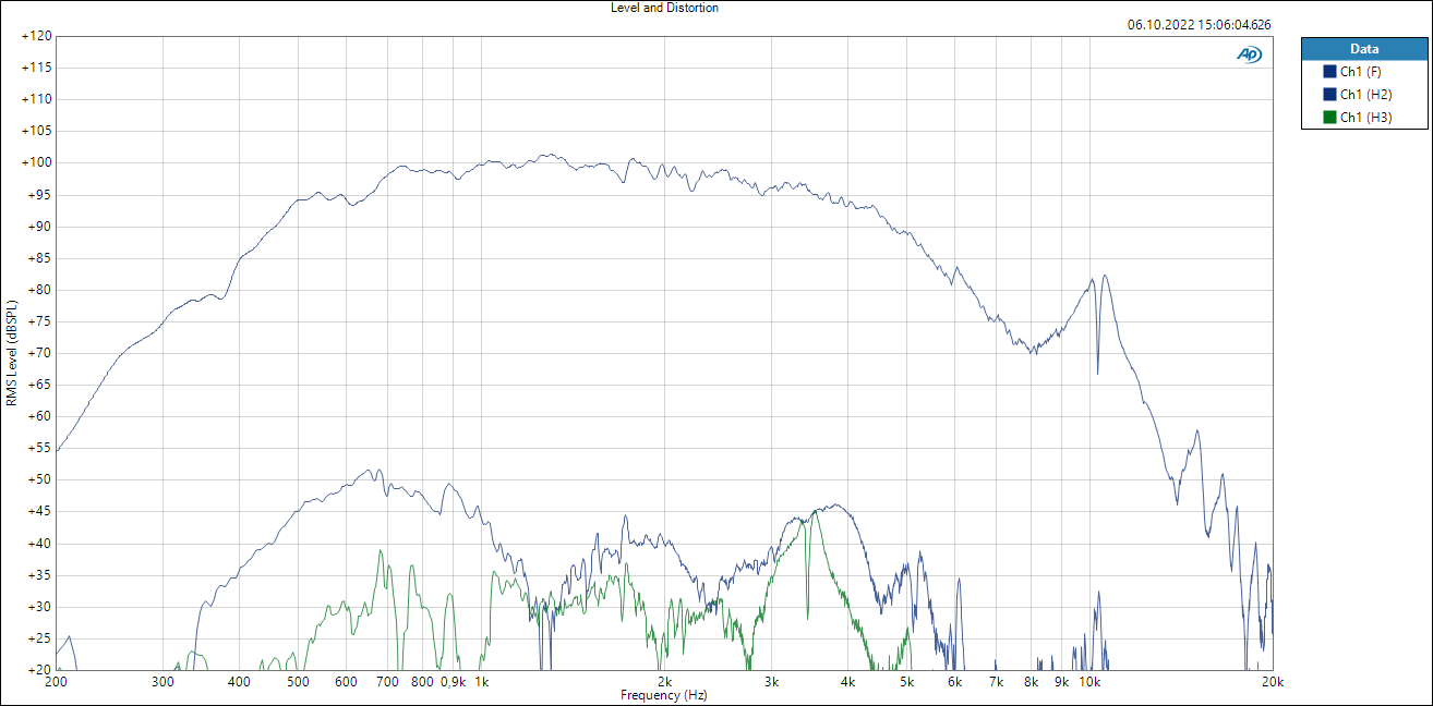

This is THD at 94dBSpl at 0,5m with 2 alu Bliesmas in MTM + TT configuration. And up to 114dBSpl - but remember it's 0,5m distance. Crossover at 450Hz when I remember right.
While there IS higher THD it's still very low compared to normal drivers. It's just insane low at 1kHz!
And it's mainly K2 what you can see at my other measurements, K3 sticks 10-15dB lower, even at low frequencies. (last measurement is from 1 ALU 3")
