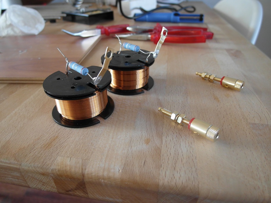

I just did my filters. I stranded the pret-inned inductor and inductor wires together, then I ran the one of the joints through the pre-tinned hole of the lug from the binding post and soldered that as well.
I will probably not win any prizes but the joints have the same shine as the solder wire, I can still see the stranding, the ohmmeter says it's good and I can lift the coil with just the lug or the resistor so I guess it will do nicely.

secure your coils so that vibration does not strain the copper lead outs.
repeated straining will fatigue the copper and eventually it will crack.

The coils will be fixed with very strong (and vibration absorbing) double sided ashesive tape and the joints will not need to carry more than the weight of the resistor so I guess that should do it.
It's for a 3" full range speaker so the vibrations should not be too heavy anyway.

Those connections did not get hot enough and it appears you may have tried to 'paint' with the soldering iron. When it gets hot enough, solder on the terminal will not have irregular areas and the surface will have a smooth contour with no 'high spots'.
It's actually hard to ruin parts by soldering if the tools are good. Bad tools get too hot and can't deliver heat fast enough so you tend to stay on the joint to long. Worse tools don't even deliver enough heat on any connection.
I use Weller Magnastats for many years and they are OK. I'm told Hakkos do better for less money. I currently run Metcals and will not give them up. After a Metcal, everything else is a soldering 'tusk'.

Do you suggest reheating the joint on the terminals to allow it to flow more evenly?

My iron is an entry level 30W. Upgrading to something more fancy is not really an option for me at the moment.

If it were mine I would but it might get tricky unless the lug will stay in position even when the solder is liquid.

The joints do look better on the other side of the lugs.
The filters will be in an accessible position so I guess I wil leave them as is for now.

I used a $7 radio shack 25watt iron for decades. They work. Are there better, easier irons? Absolutely. Is the RS iron useable? Sure it is. Good soldering technique will make up for a crappy iron most of the time. With those crappy irons I only ever damaged switches with too much heat, and only about 4 in 30 years. Soldering is a skill that takes practice to master. Keep at it. You'll get better with time.
