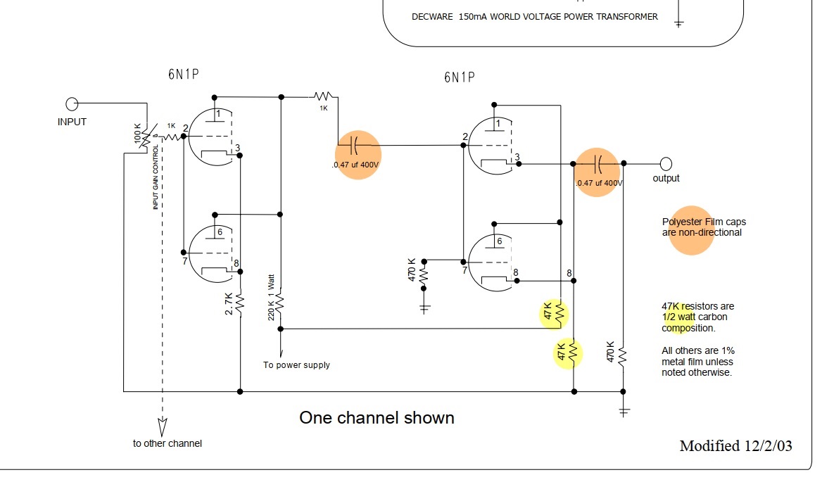

If you want to build a sketchy version of the Zen amp, you could build a sketchy preamp to go with it.
Unfortunately, the parallel cathode follower output has an un-bypassed 47k plate resistor.
Sketchy, yes.
47K/mu = 47000/20 = 2350 Ohms.
That 2350 Ohms is in series with 1/Gm.
1/Gm = 1/2200microMhos = 455 Ohms. 2 cathodes in parallel gives 227 Ohms.
The output impedance is 2350 + 227 = 2577 Ohms.
That is probably much higher than you were shooting for.
So, bypass the 47k plate load with a proper bypass cap.
I will not spend more time looking for errors on this schematic.

I knew that was just a link, and not your circuit.
The web is full of strange schematics.
Some have un-intentional errors (typo, omissions, wrong connections, etc.).
I even do that too.
Some have never been built, have never been tested, or have been completely abandoned.
Caveat Emptor.
User Beware.

I would take 6A3Summer and Audiowize’s advice! Having reviewed Decware’s schematics in the past, they made me pause for all the reasons they mentioned.
