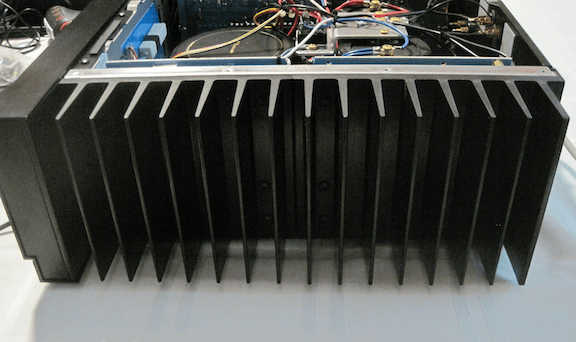

Yes. The heat sinks on it are very substantial.Your PA-5 has impressive heat sink temperature uniformity!
