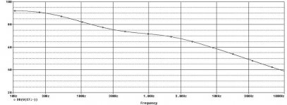

Anyways out of my PSpice Analyzer (ehehe sounds just like your Agilent analyzer) i get this frequency response...as the total freq resp MM + MC.
The two curves totally look the same to me...look at the file.
Ad far as this is concern it would look like the inverse RIAA i am using is not correct.
I wish i could have one.

Not sure what driving impedance the inverse riaa expects but it's unlikely to be 150ohm. You may need to modify the 1.91k resistor respectively.
thanks a lot for your adive.
I tried to change the output resistor from 150ohm to 1.9K with no effect and tried to change the 1.91K in series at the capacitor on the inverse RIAA block but the odd point on the middle band was just magnified.
Did i miss something?
Did you mean to change something else?

Hi Stefano
Two possible issues:
1. The Hagerman inverse riaa expects 50ohm of source and you have 150ohm. Reduce 1k91 to 1k8
2. Not sure what is the capacitance in parallel to 88.7k in your circuit. Not enough resolution for my ageing eyes. Should be 2n7 in parallel with 33n and it looks like 27n.
In fact you can check this riaa in the feedback of any opamp, no need to be this complicated discrete circuit and results will be the same.

Thank you very much analog.
Your eyes are in a perfect shape 😉
I just changed the value and now the inverse curve response show a deviation from the ideal response of 0.08dB which is in accordance with the original specification.
Now the cure response at the output of the inverse RIAA filter is exacly like the response tortello kindly posted on a previous 3d....not too bad for such a stupid tool (i mean spice...eheheh not the agilent...magaaarriiii!!)
