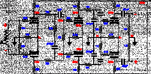

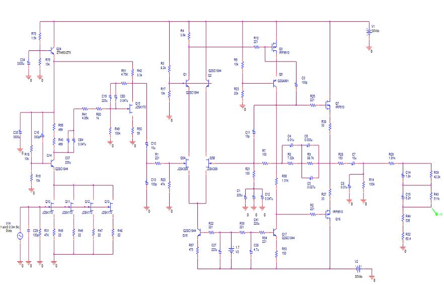

I am simulating the ONO with PSpice.
Since i don't get really straight how and if the RIAA circuit works i connected at the output the Inverse RIAA circuit taken from the webpage:
http://www.hagtech.com/pdf/riaa.pdf
by doing the frequency analysis i get some weired results going on.
To see if anybody might give me some tips to understand what's wrong with it.
Here is the circuit used

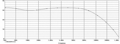

And this is the plot of the magnitude at the output of the inverse RIAA block.
Why don't i get a flat trace? Is this normal?
I guess there is something wrong ether on the RIAA filter or on the inverse RIAA i am using.
May anybody out there help me out with this a little bit?

Stefanoo, maybe you should progress in small steps? Read about RIAA and what it's doing? Then you'll understand that you never get a perfectly flat response with real world parts.
If you calculated the deviation from the perfect line you would find only 0.5dB and compare that value to the Ono-manual.
Oh and if you want to understand how the Ono works, try to understand the basic building blocks first (I mean the various basic circuits like common-gate, common-drain, common-source). Spice won't tell you how the Ono's working, infact you will often see that Spice isn't working properly at all - but how should you know if you don't understand the circuit?
The K389 is fed by a current source, so more or less independant of max IDss.
Have fun, Hannes
EDIT: Oh I'm sorry! Your axis is already in dB! See, Spice already playing tricks with you 😀 By the way 30dB gain is a bit too less, even for MM.

unfortunately it looks like 3.5dB of deviation from the flat response
fits nicely to
and
Everything clear now?
Have fun! Hannes

Anyways, for the deviation from the ideal/flat response, i still think the RIAA regulation, in my case, is a little bit odd due to the 3.5dB of deviation.
Anybody wants to say something about this?
t h a n k s in advance.
Hi Stefanoo,
of course 3.5dB is far too much and nobody would ever sell that. Just as I told you to look up the value in the Ono manual, it says there +- 0.1dB from 20-20kHz. So your spice-sim is goofy.
All the best, Hannes

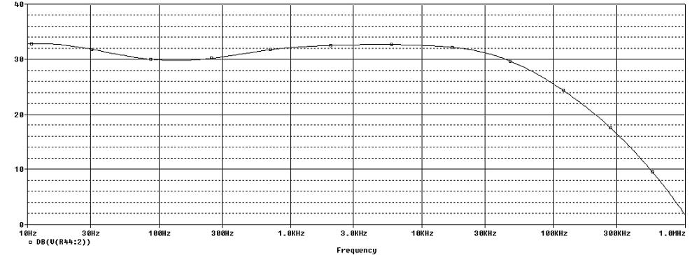

These are REAL frequency response measurement of the Ono I built for a friend of mine.
They have been taken with my Agilent analyzer, and are the f.r. of all the stages, from MC input to output. The other channel is exactly the same!
One is the real RIAA (plus gain) frequency response, the other with David Manley's inverse-RIAA network.
As you can see the line is quite flat, ant the two -2.5dB points are located to 5Hz and 100KHz.
Of course, so high frequency behaviour is to be evaluated with RIAA > Inverse-RIAA combination...
