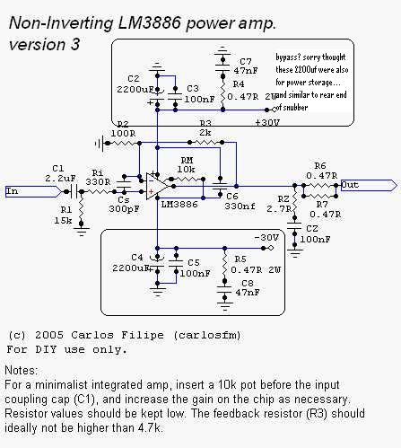

Hi slightly other thread/topic, I know, but tossing a question into that 35 page thread is daunting...:(
What I don't quite get is that in the whole Unreg snubber PSU thread, you leave the 1000 - 2200uf caps from V+/V- to GND and use the 10000 uf, with parallel 100nF, makes a lot of sense... if you follow the argument. One problem I have is that in Carlosfm's 3886 amplifier stage version 3 (which both of you stated was for use with snubber PSU...), you still have the 2200uf with 100nf in parallel from V-... only with a lot of what I guess is bypassing? circuitry added... what gives?:xeye: If I fit the 100nf's, do I chuck the 2200uf's?
And another question: I have a mono (300VA 25-0-25 tfm) power supply for the six LM3886's, but with six pairs of (10000uf) caps feeding them all. And 2200uf at the chips, no 100nf though. Surely my Impedance and Inductance and ripple must be very low after this lot? I think the sound is cool, no harshness that I can hear, but why be satisfied...

Hi, sorry for garbled thread... it just indicates a garbled head... :cannotbe:
In the pictures edits of carlos' schematics I try to show what I think... of output stage...
And here is what I think are the snubbers, I gather they are completely different things even though they sit right next to each other, should be as close to the pins as possible and have more or less the same layout, some different values... :xeye: The 4700uf and big R is a cheaper Inductor or filter... u could use a big ferrite core coil, to do the same... would be faster that way...
