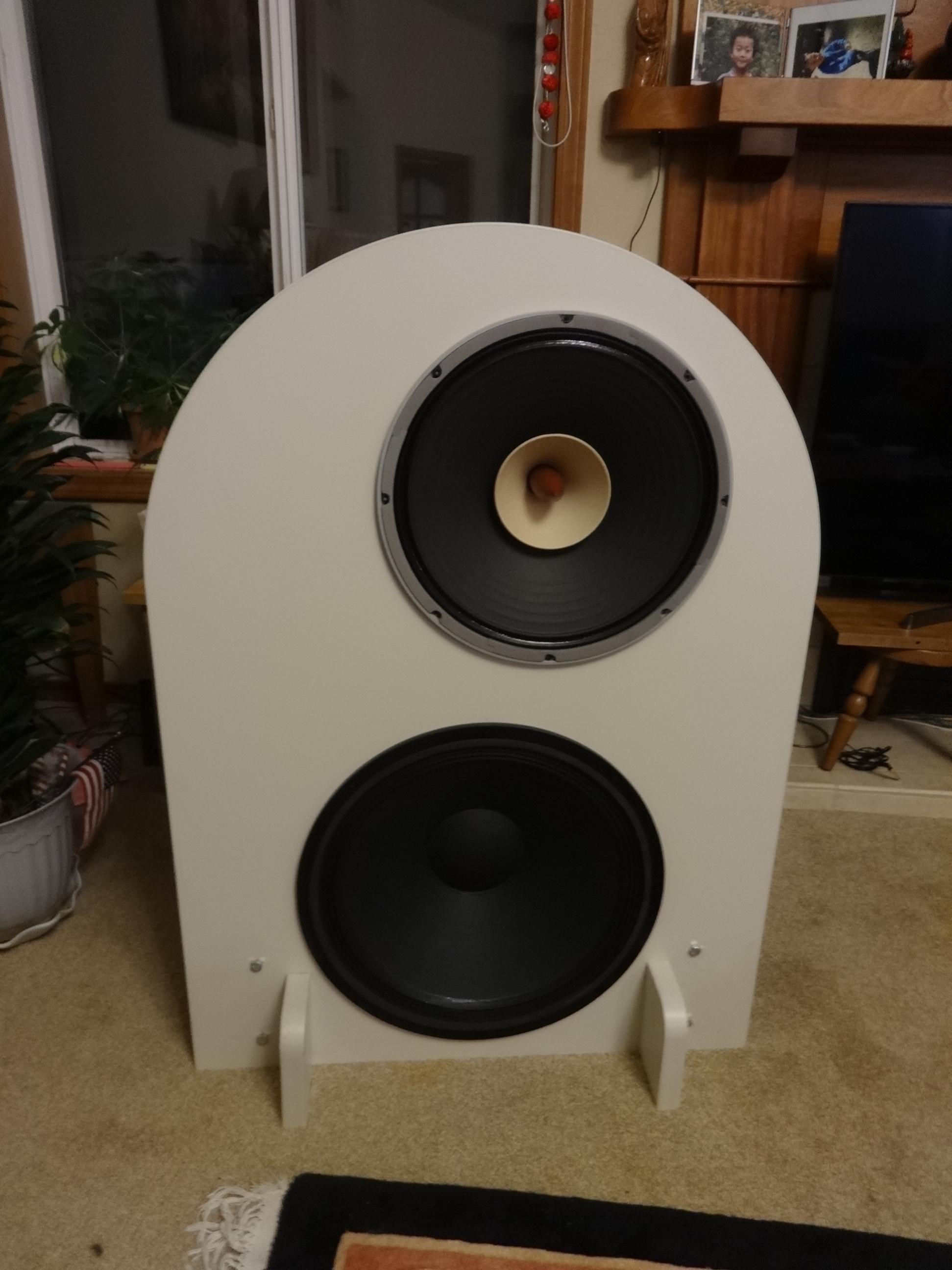

I like mine on OBs, crossed at 100Hz to Goldwood 18"s. I had an impulse for convolving that worked with Daphile - made them sound even better - but Foobar tells me something about the sample rate isnt compatible...so I probably lost the files and suppose I just got used to listening to them as-is.
Frankly, after a year if ownership I never seem to be disappointed. Even movie and TV soundtracks (from the likes of PBS..) make me chuckle at how good they can sound - which of course contributes immensely to my enjoyment. Not sure if the wife/kid even get it in the same way I do. Oh well.
Percussion and Piano (a percussion instrument) seem to be their forte...besides throwing a really nice panoramic soundstage from the sweet spot. Glad to read others seem to like them too.

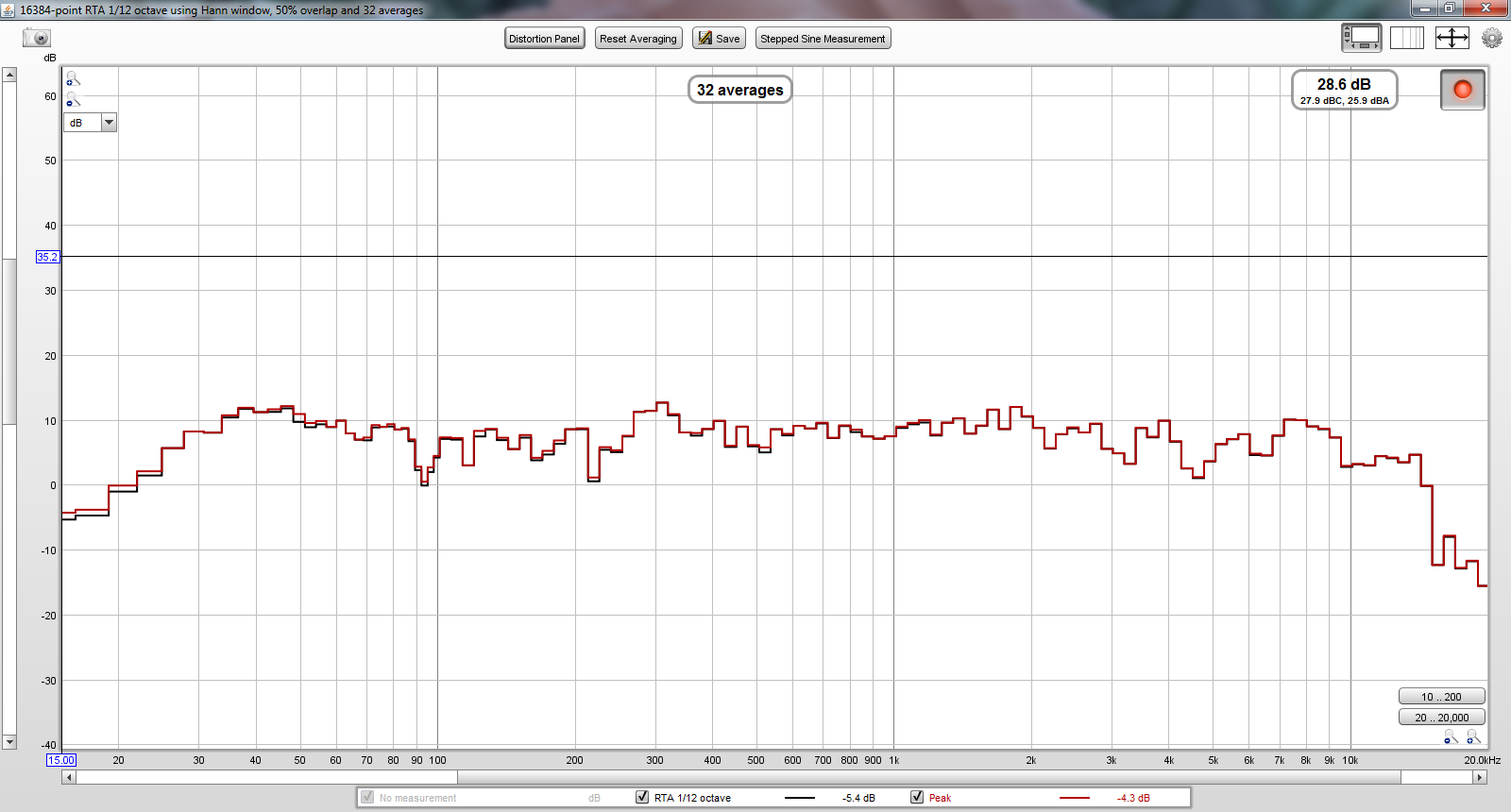

I have been looking for the concept of the best sound for a long time. I tried different options-OTL amplifier ESL + bass, Klangfilm KL405+ tweeter, but then suddenly I found out the best-bass + mid up to 6Khz + tweeter. There are two options-Altec 420 + tweeter or I have Jbl 123A (2213) + BMS4524.
Box about 600L - 115cm x 80cm x 55cm filled with padding polyester 3/5.
