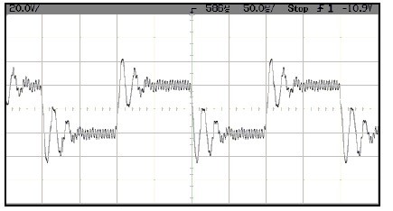

My amp has two cascaded output filters. The values are:
20 uH + 440nF
4.7uH + 220nF
Then a zobel network (120nF in series with 18 ohm/2W)
The feedback is taken from the output of the first stage (second LC filter not included into loop).
I tested with 220nF capacitive load, and output is similar to this (the figure is extraced from an IcePower 250ASP module from B&O):
What most worries me is the ringing with a power resistor (that must have some inductance, of course).
Is there something more that I can do to improve phase margin?

I played a bit yesterday. Generated an inductive load by adding a 47uH inductor in series with my load. Inmediately quite a bit of ringing appeared at high power levels, much more than with the resistors only.
Then I played a bit, and found that with the simple addition of a heavier zobel network (5 ohm + 330nF) all disappeared and now the waveform is quite clean. (Before, I had 120nF + 18 ohm).
(I was also looking at an "old" B&O Icepower 500A that I had at hand, and found that its snubber is 5 ohm + 820nF. The resistor is a TO220 package, and from my simulations it has to dissipate above 30W at 20KHz full power!!! That explains the limited high frequency audio it can deliver continuously as said in the datasheet)
