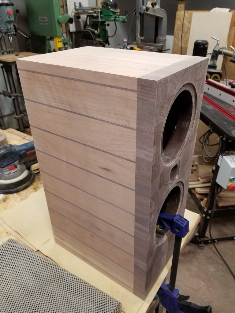

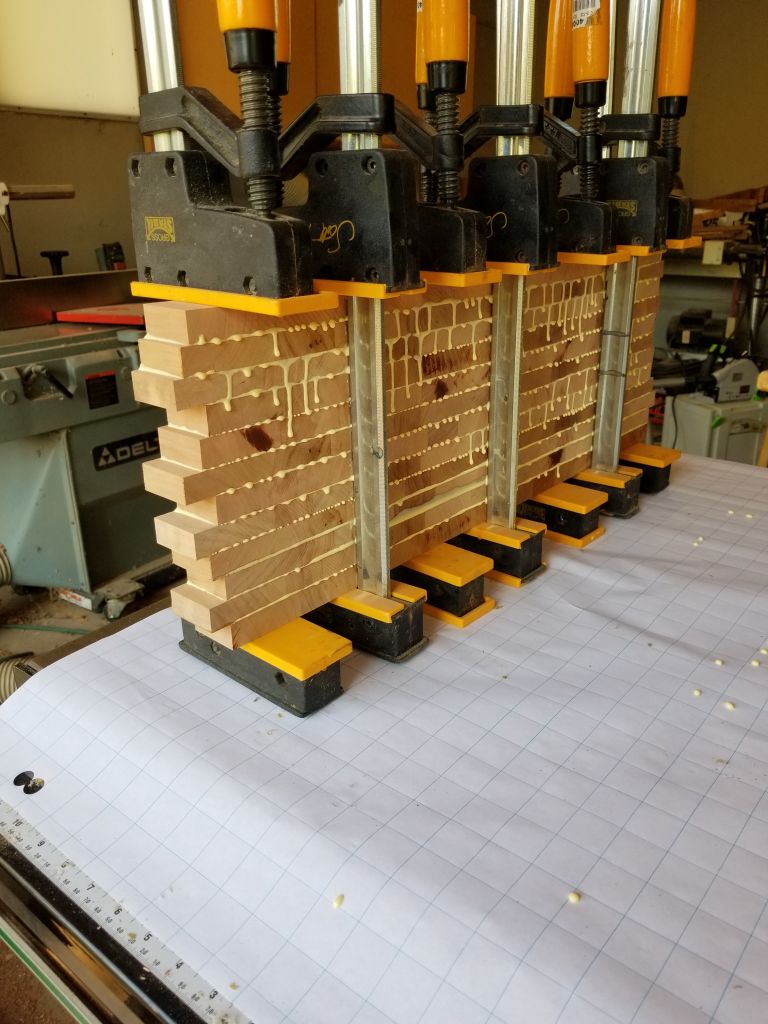

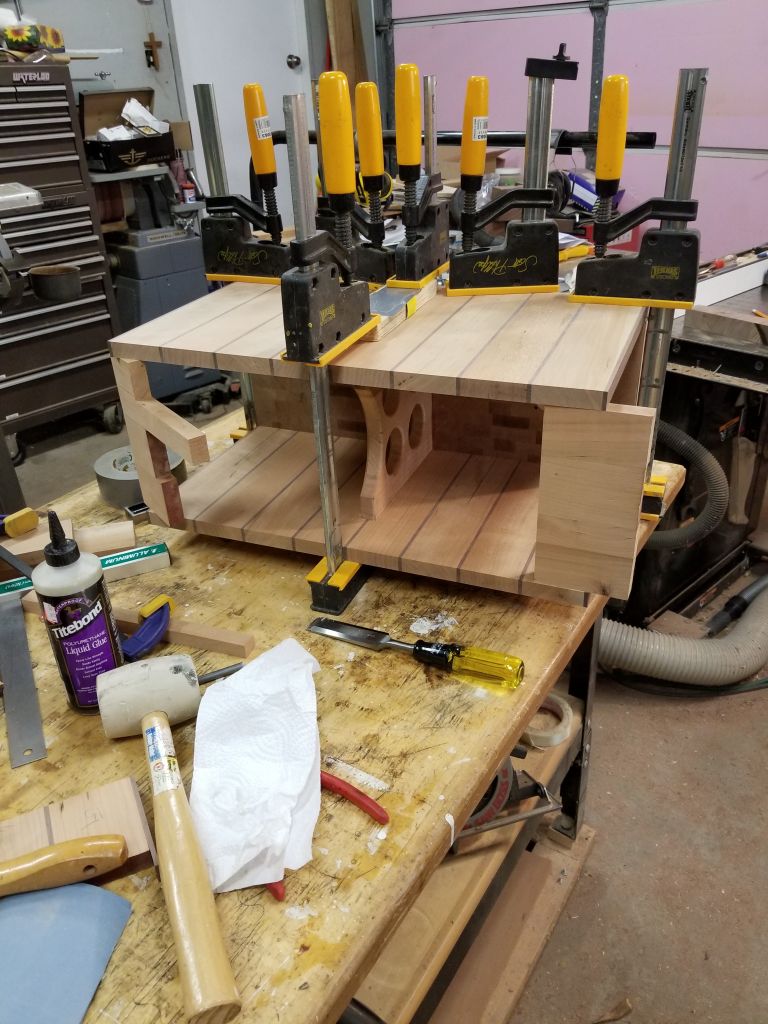

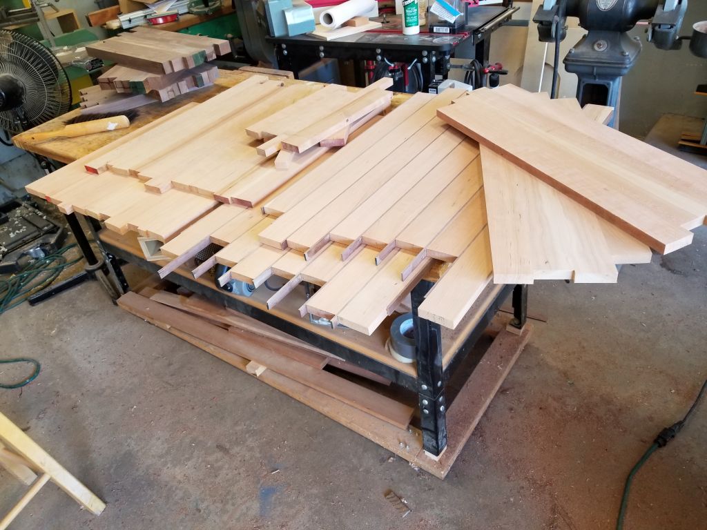

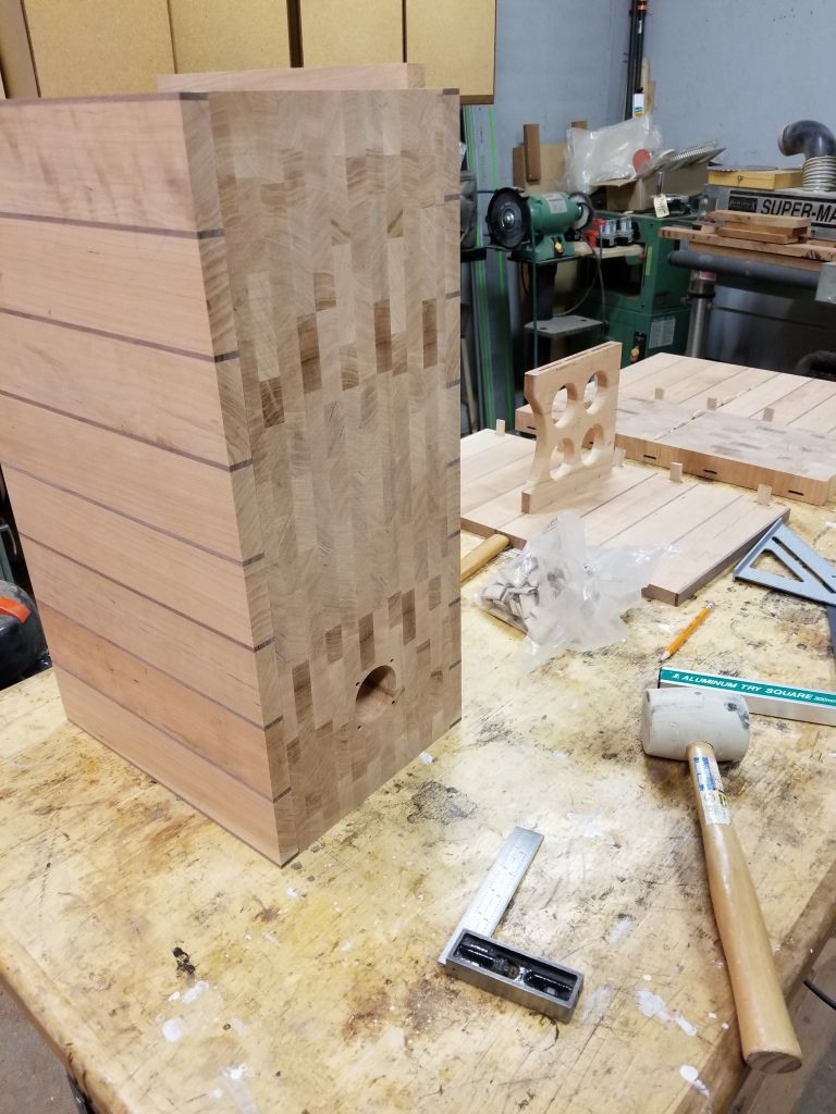

Some pics of my Solid Cherry & Walnut MTM build
Joined 2018

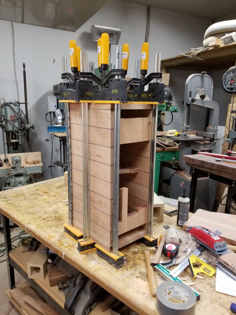

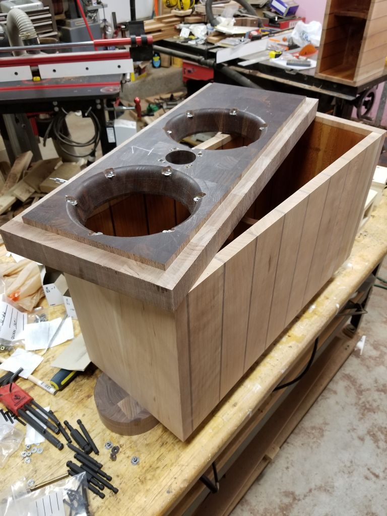

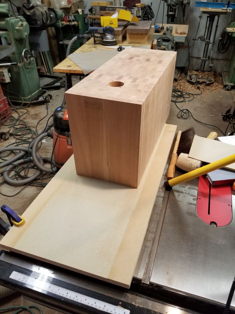

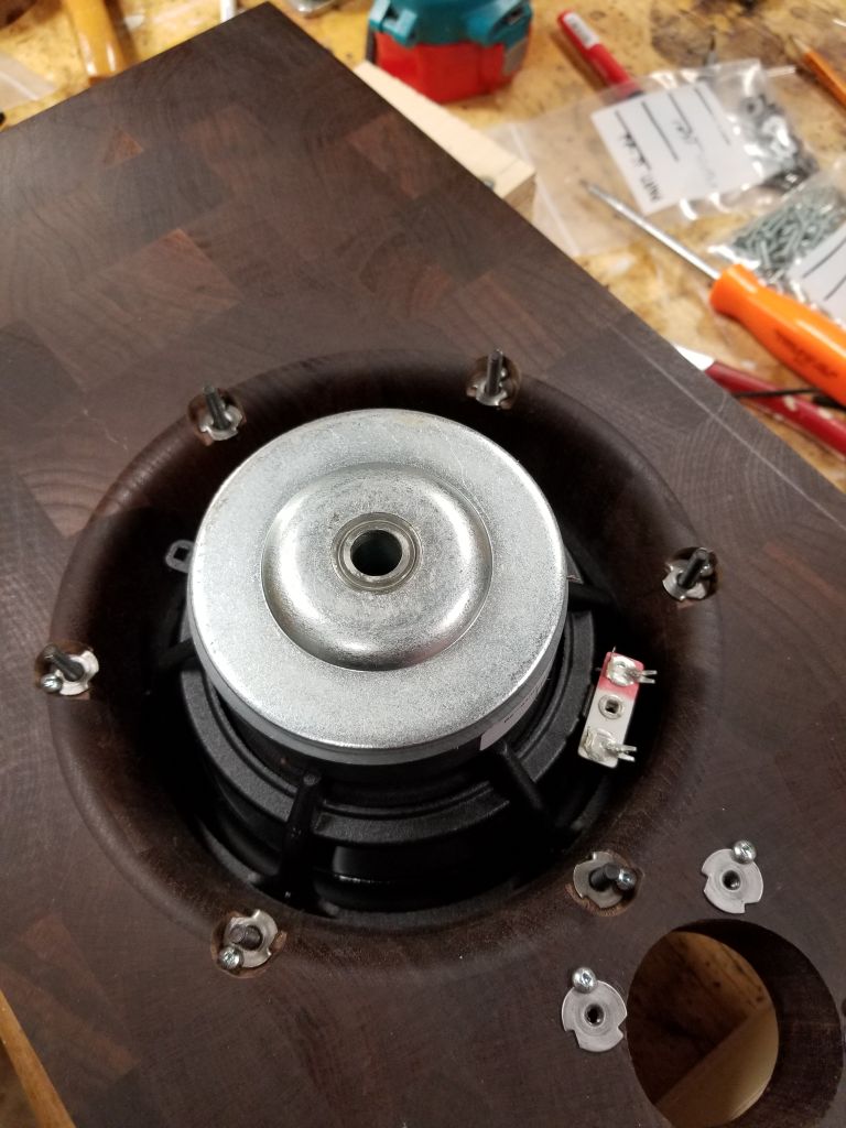

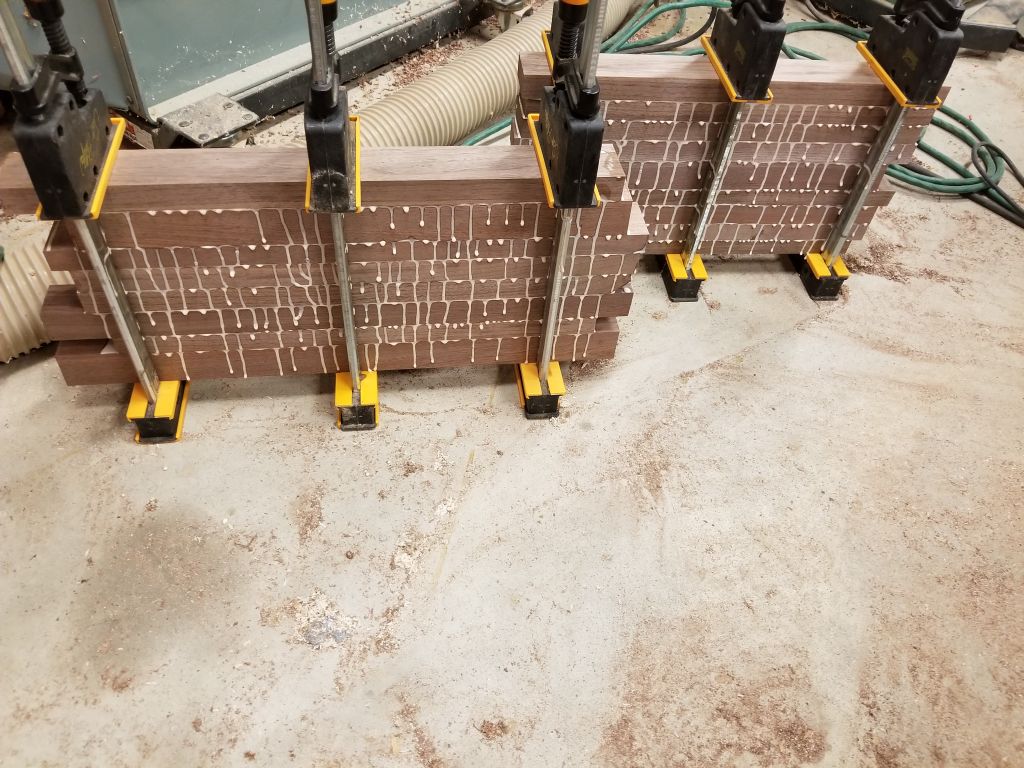

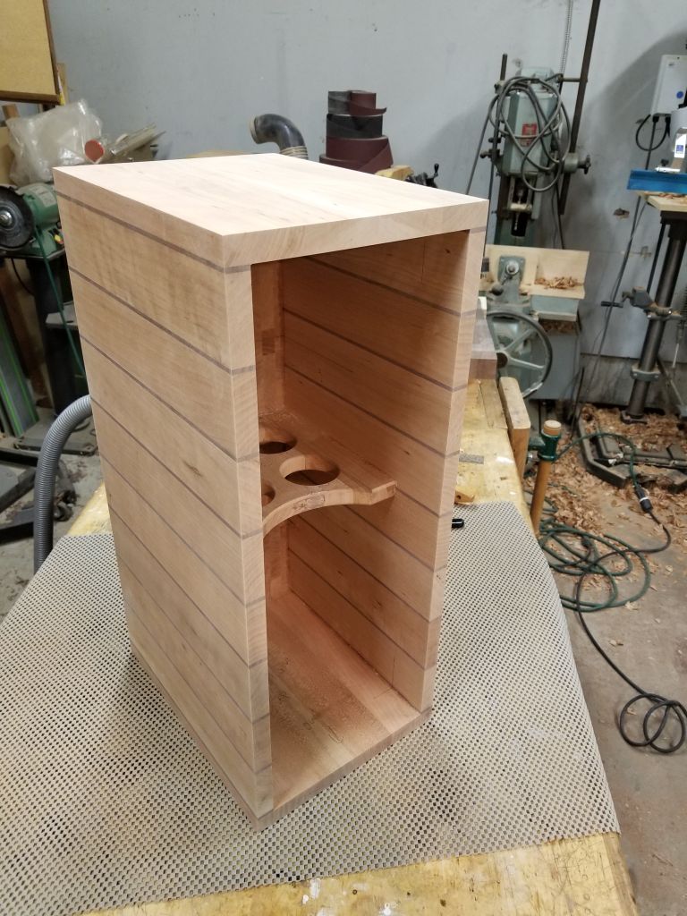

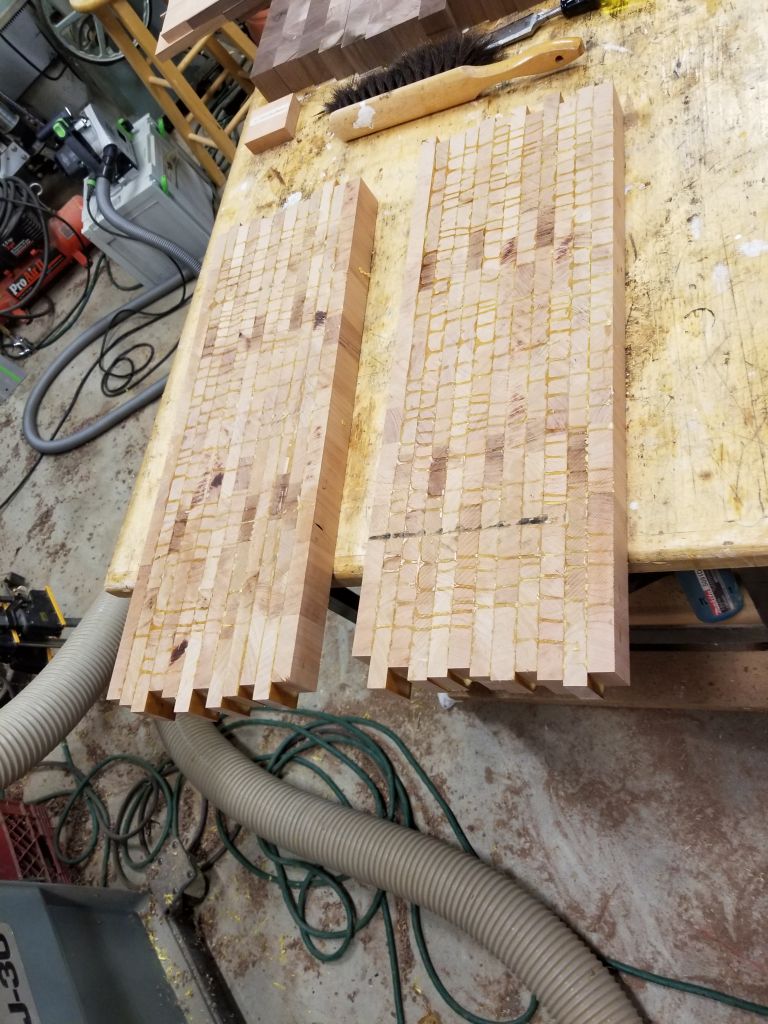

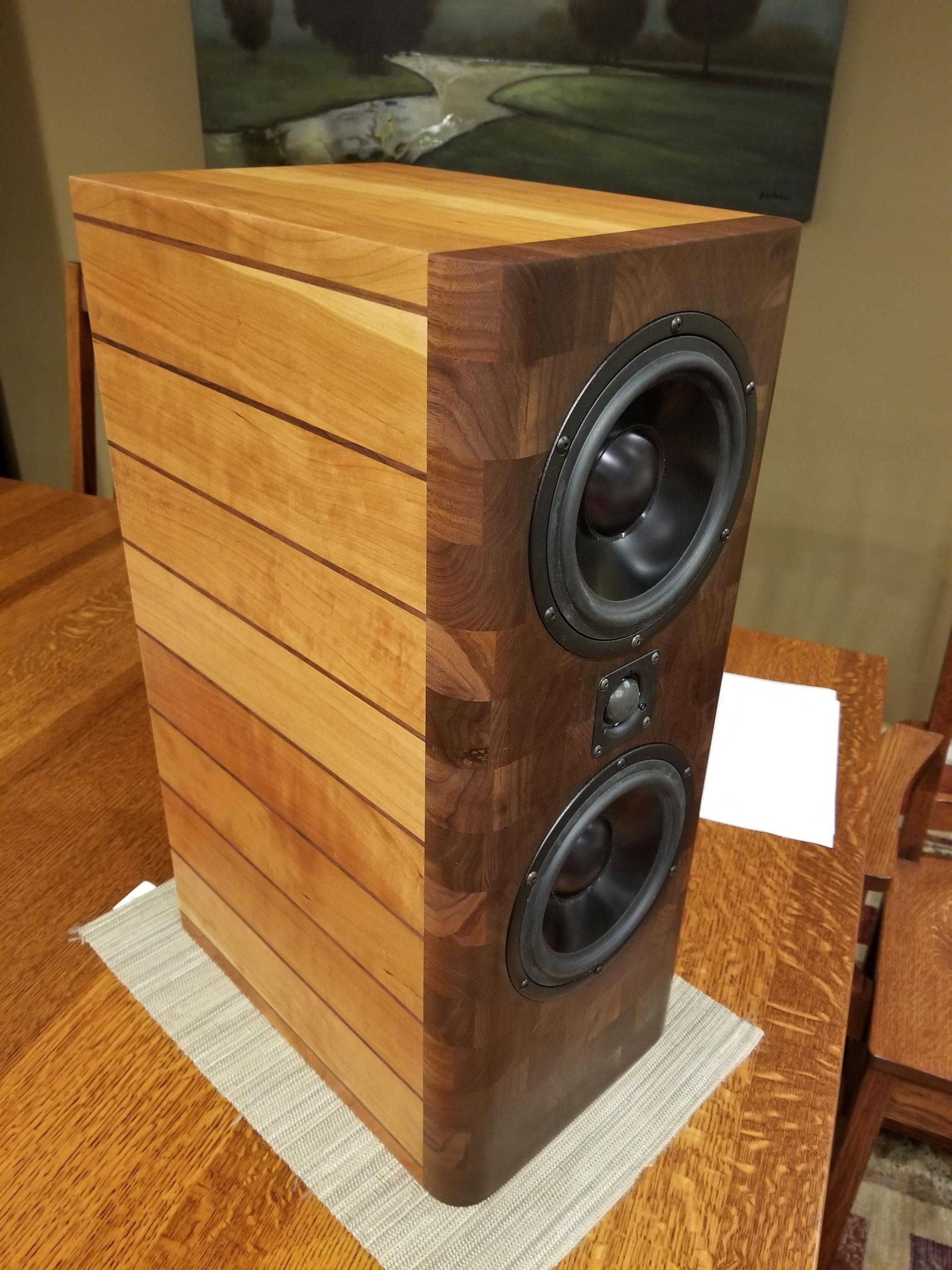

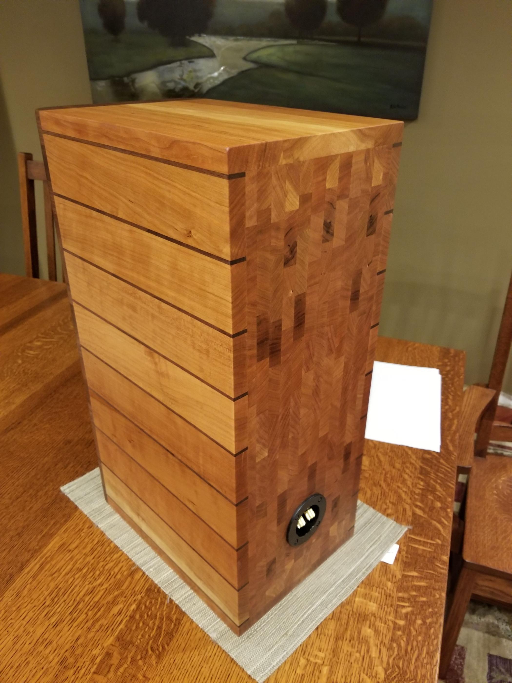

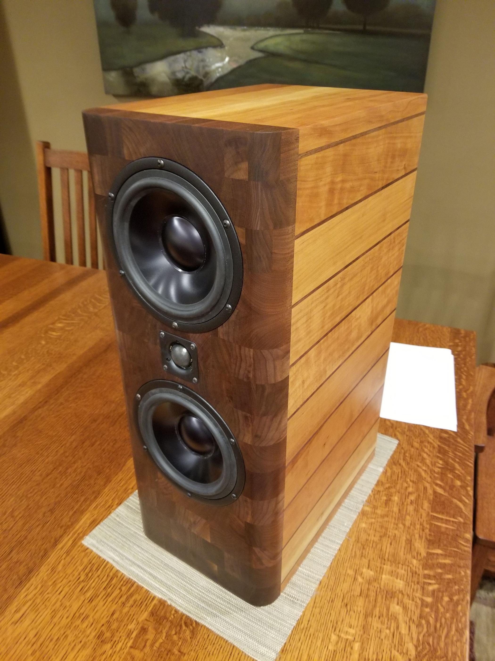

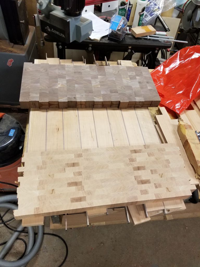

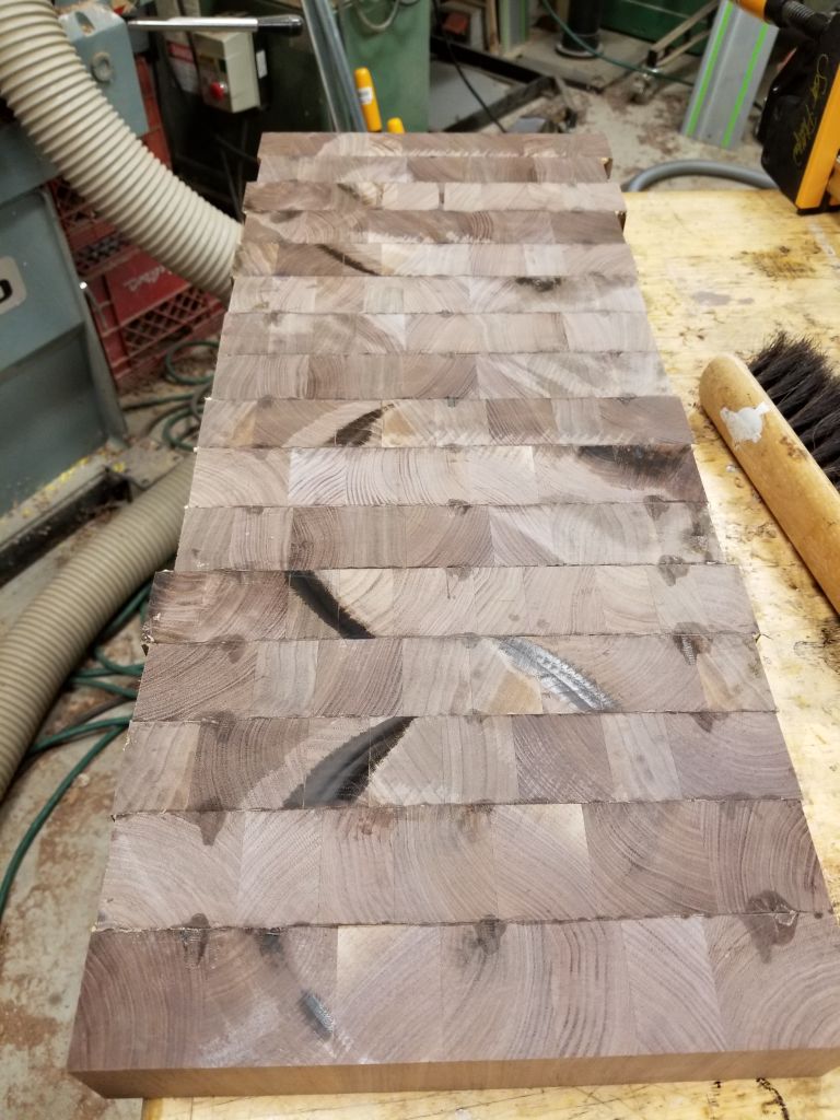

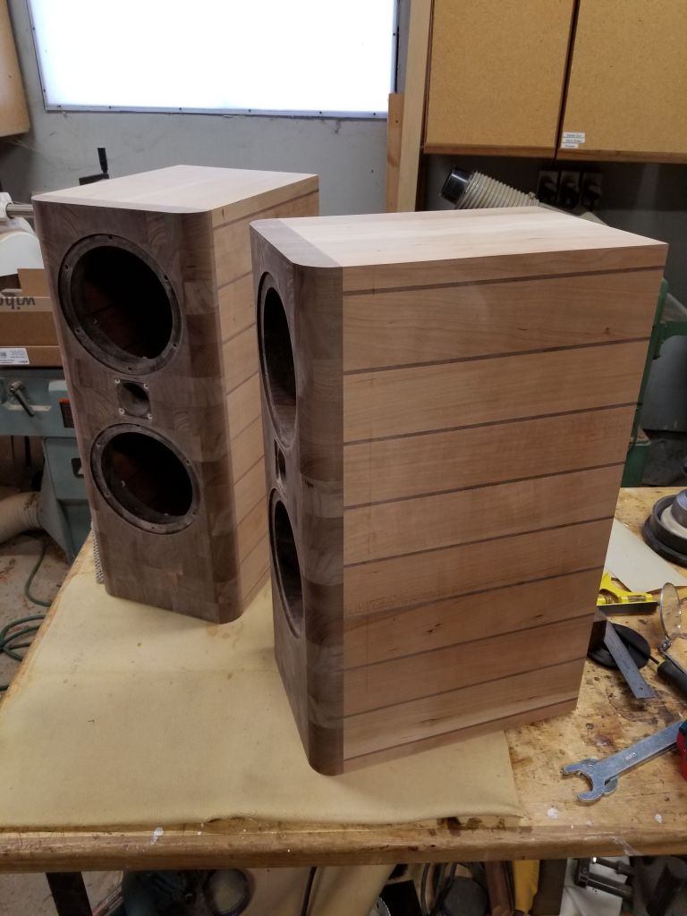

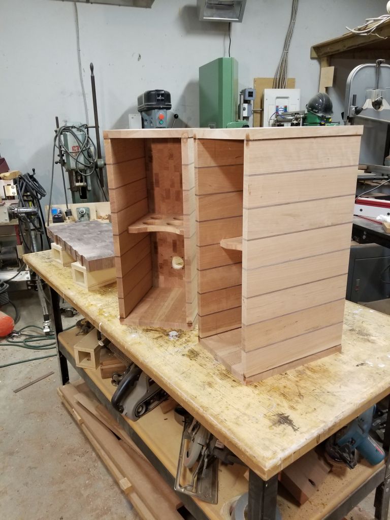

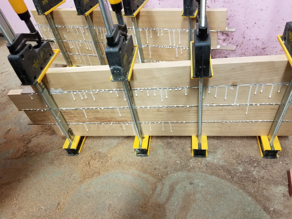

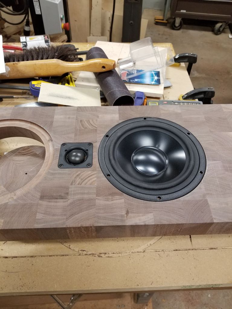

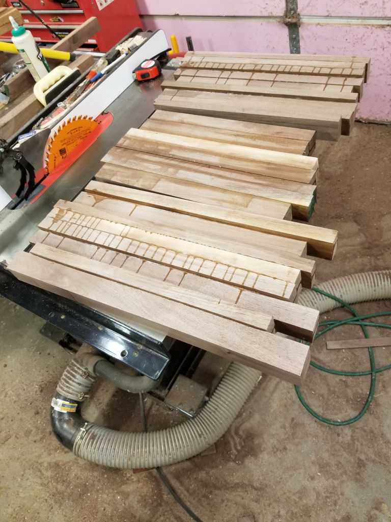

Here are some pictures of my solid cherry & walnut MTM build.

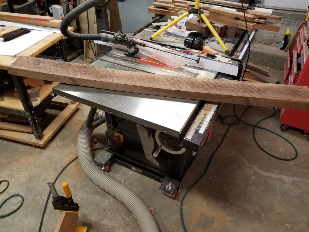

You are not supposed to build a speaker out of solid wood because of crossgrain wood movement.
All the wood grain in this speaker goes the same way.

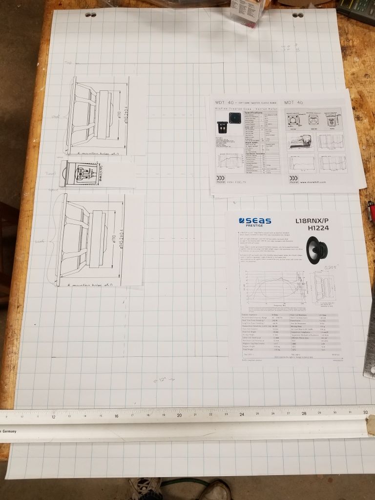

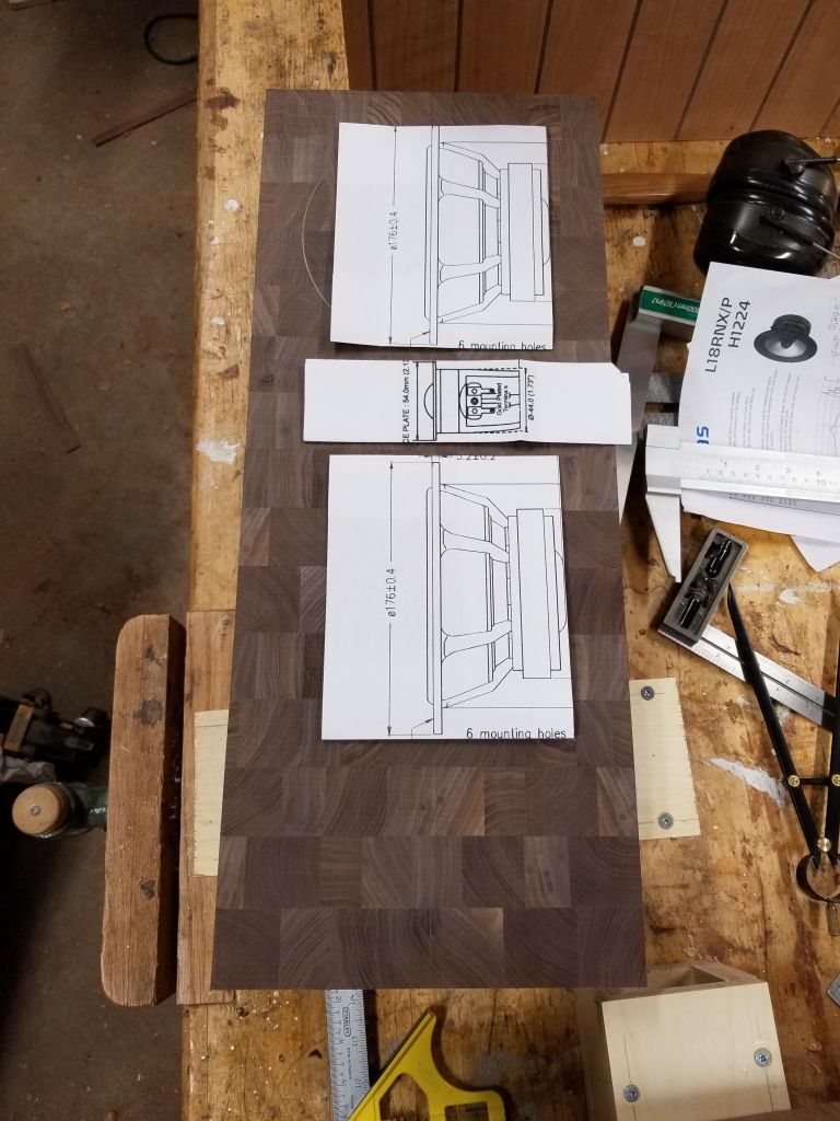

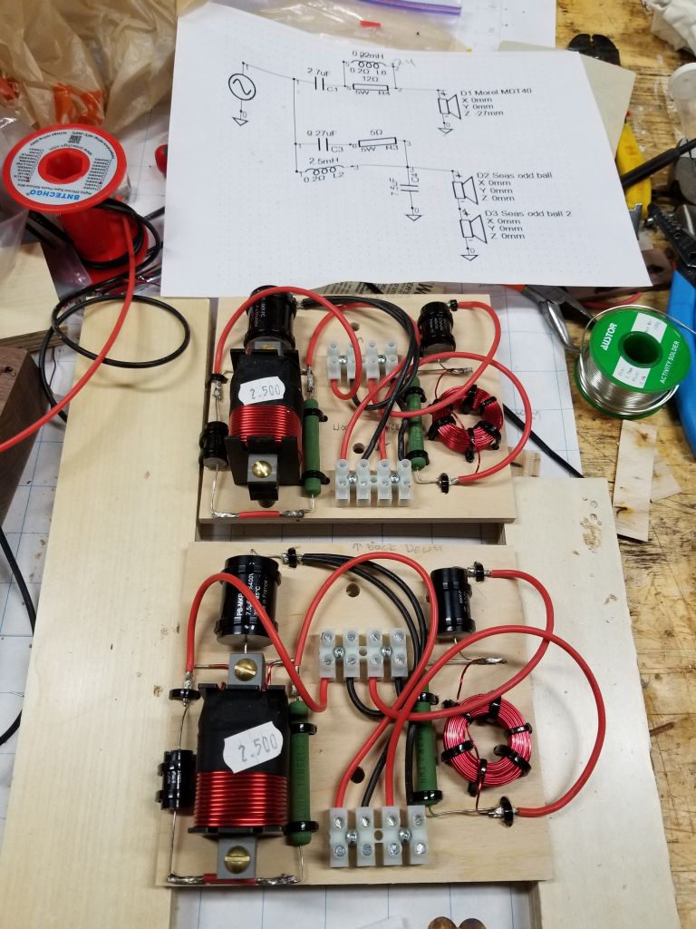

Drivers are a pair of custom Seas 6-1/2″ L18RNX/P based Prestige 4Ω Woofers and a Morel Morel MDT-40 1-1/8" Compact Dome Tweeter.
Crossover is at 1900Hz.

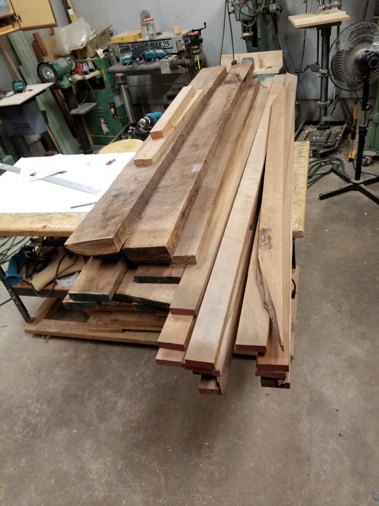

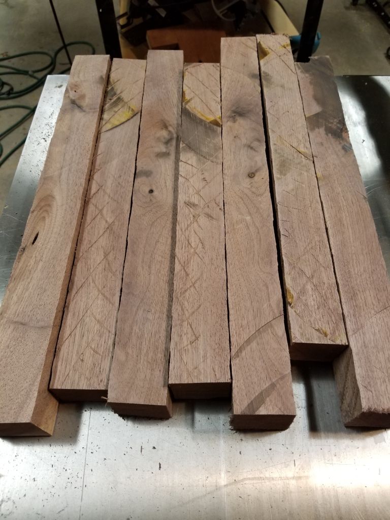

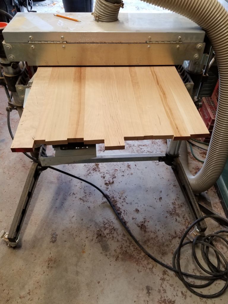

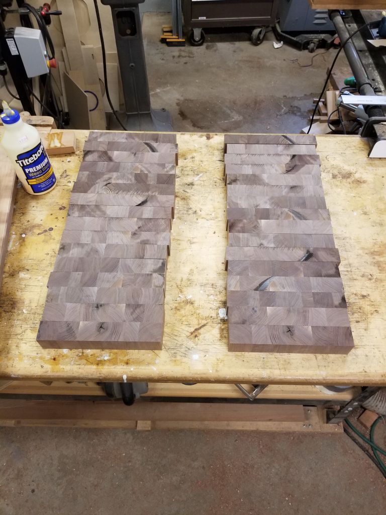

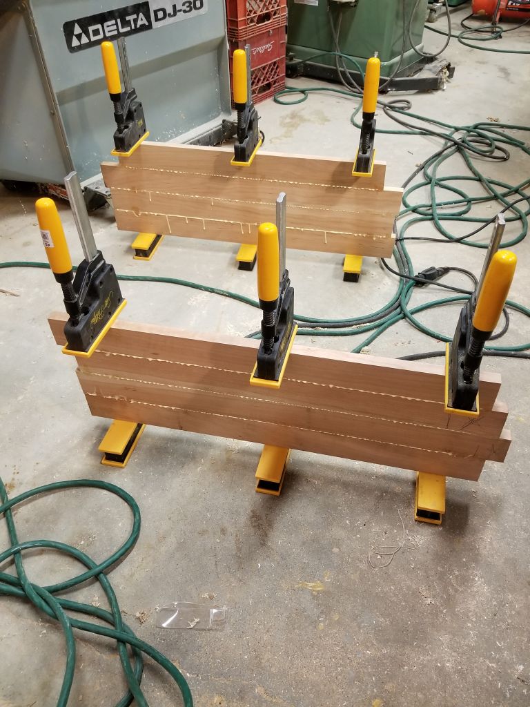

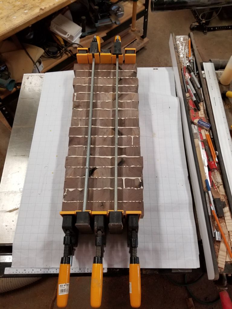

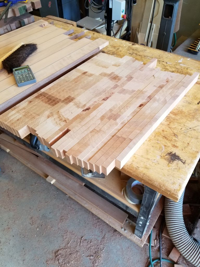

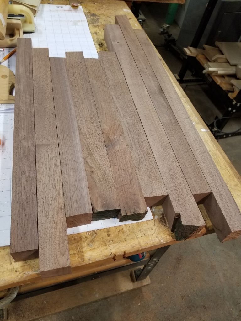

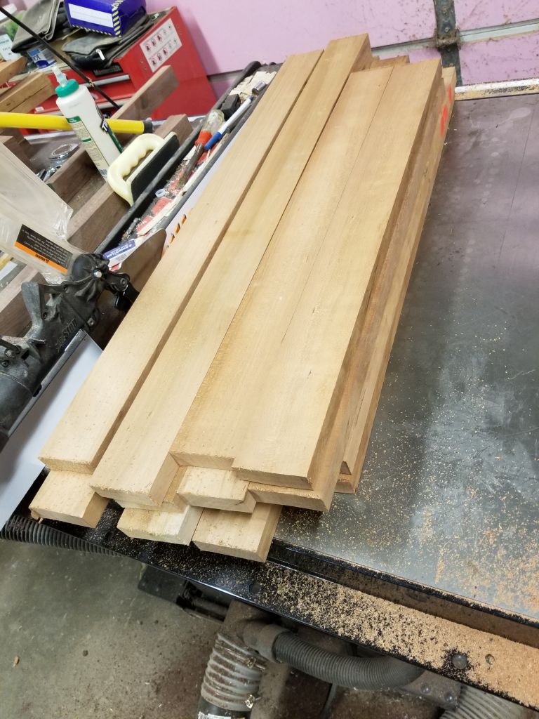

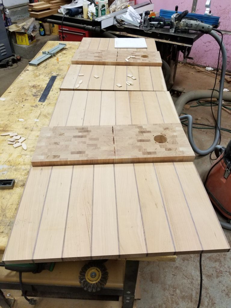

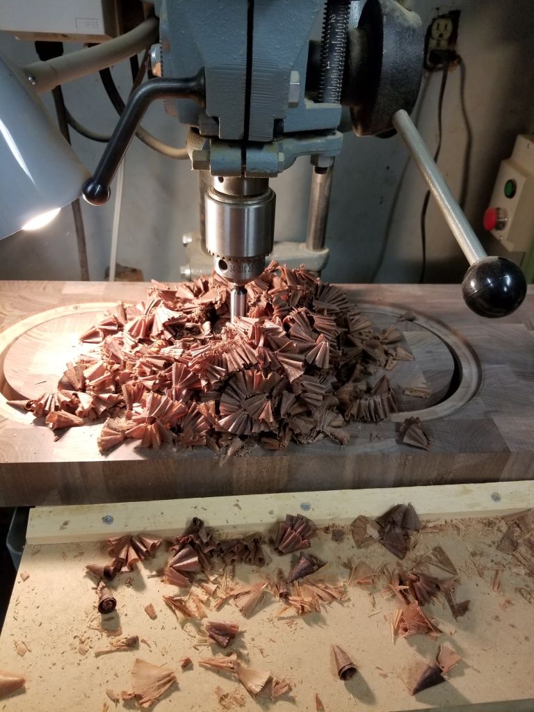

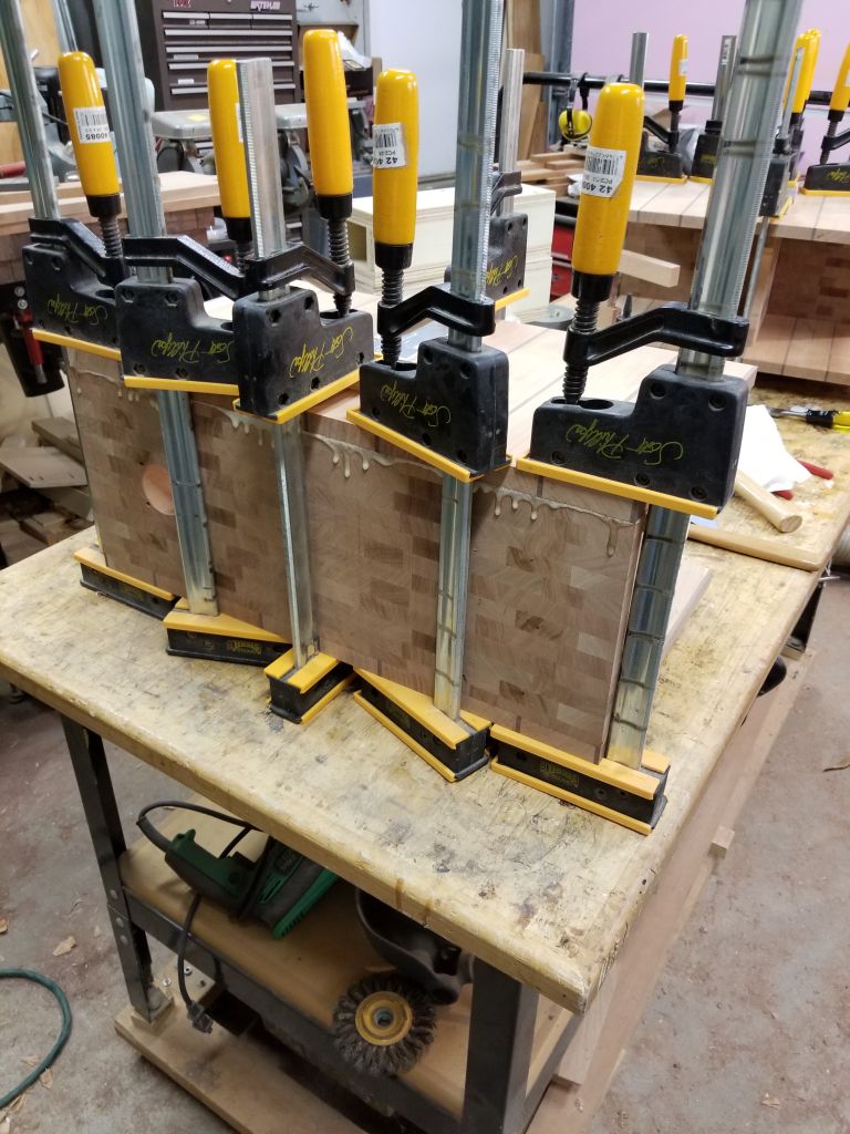

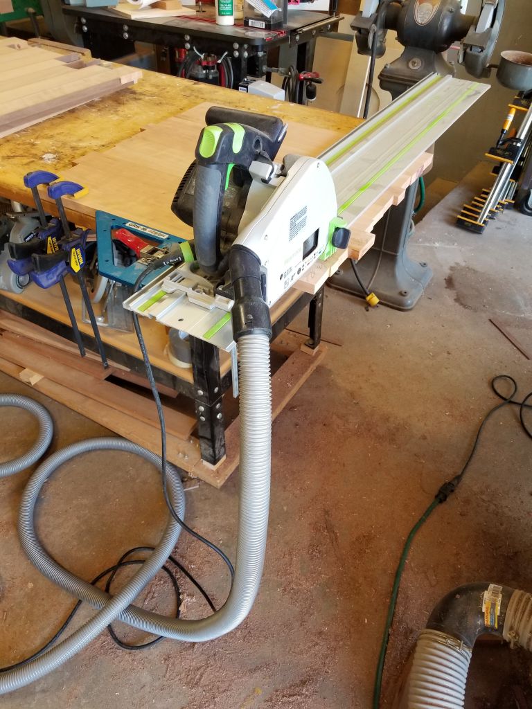

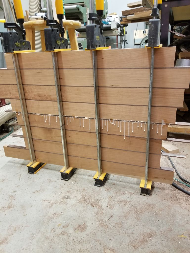

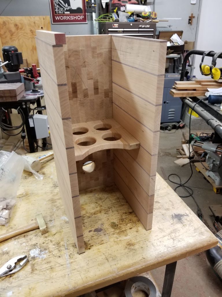

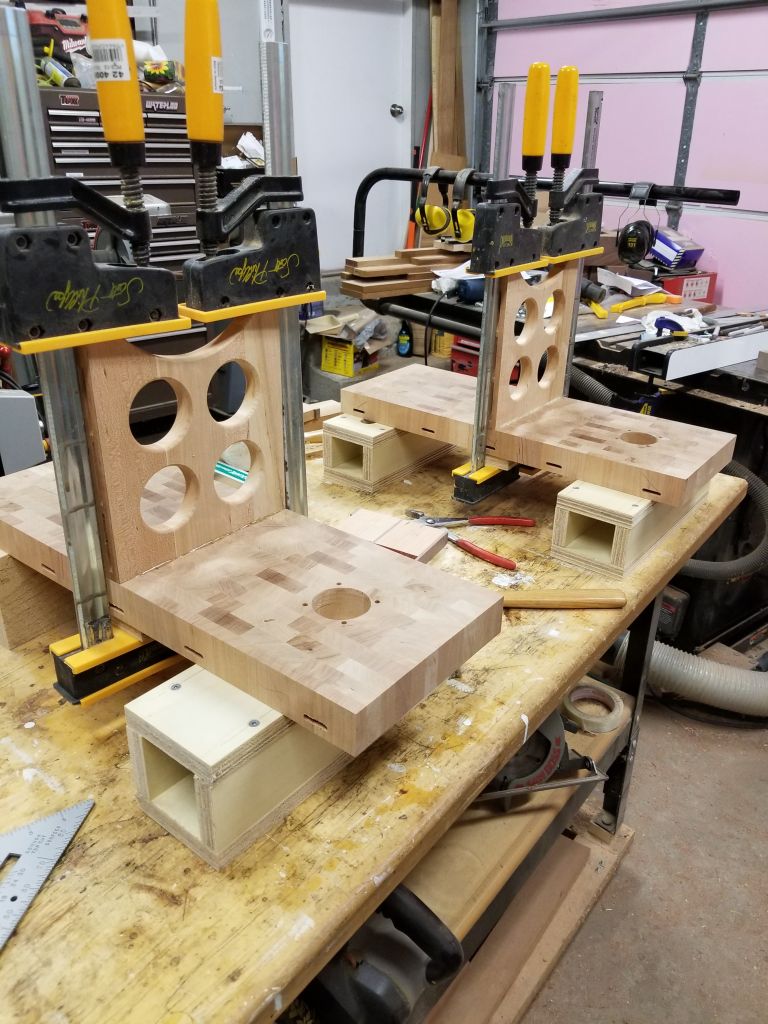

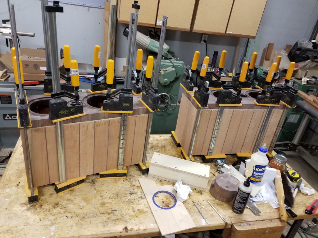

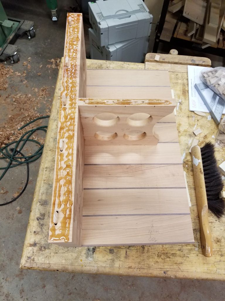

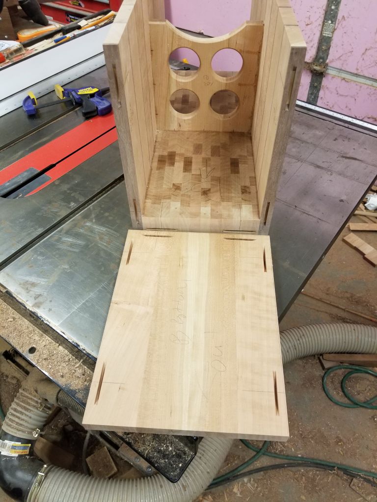

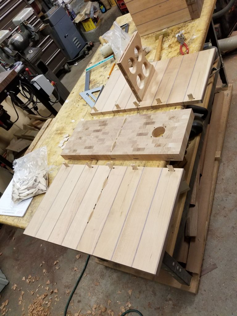

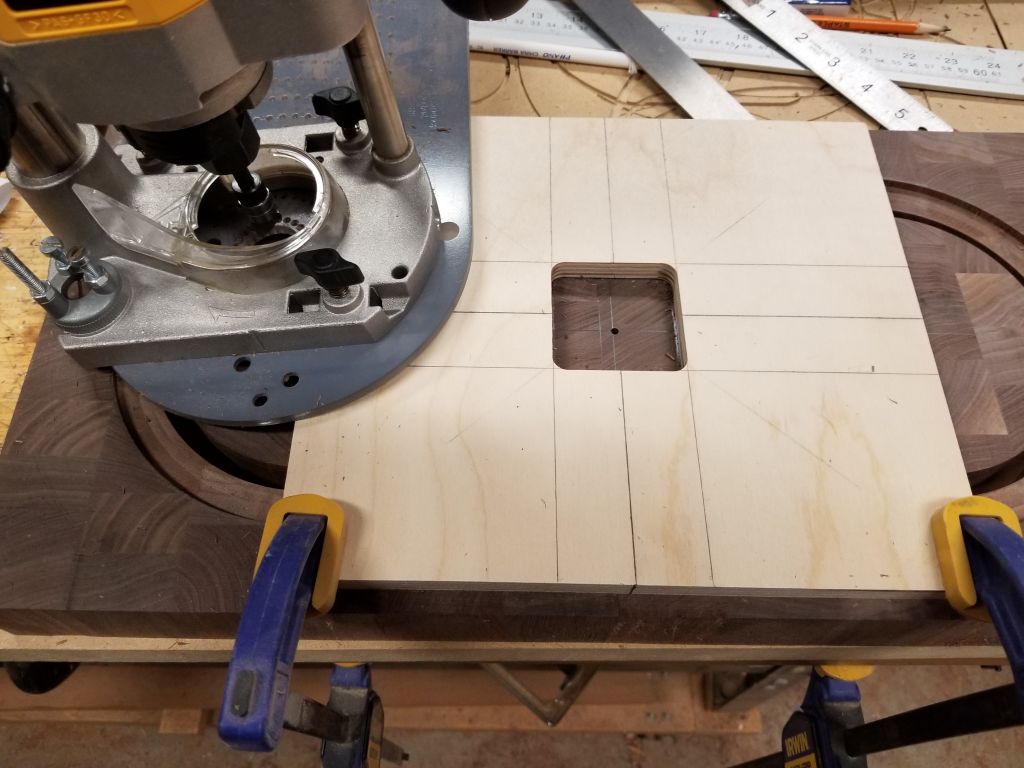

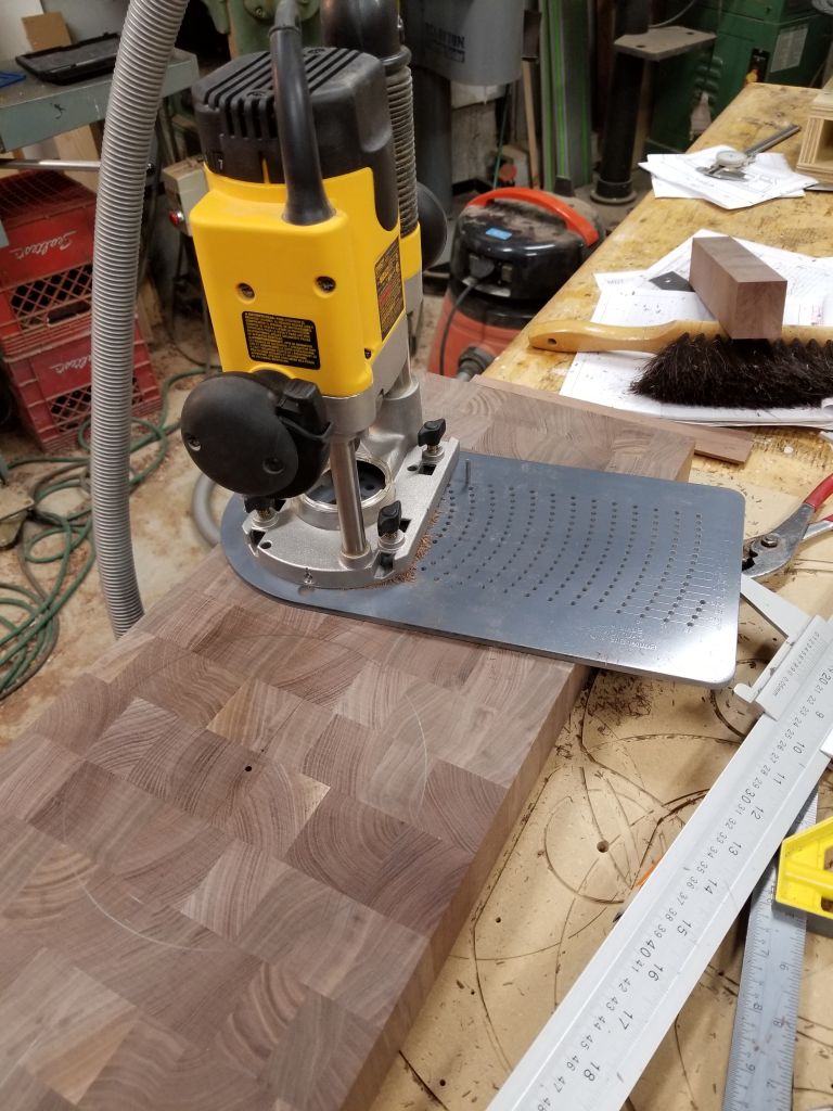

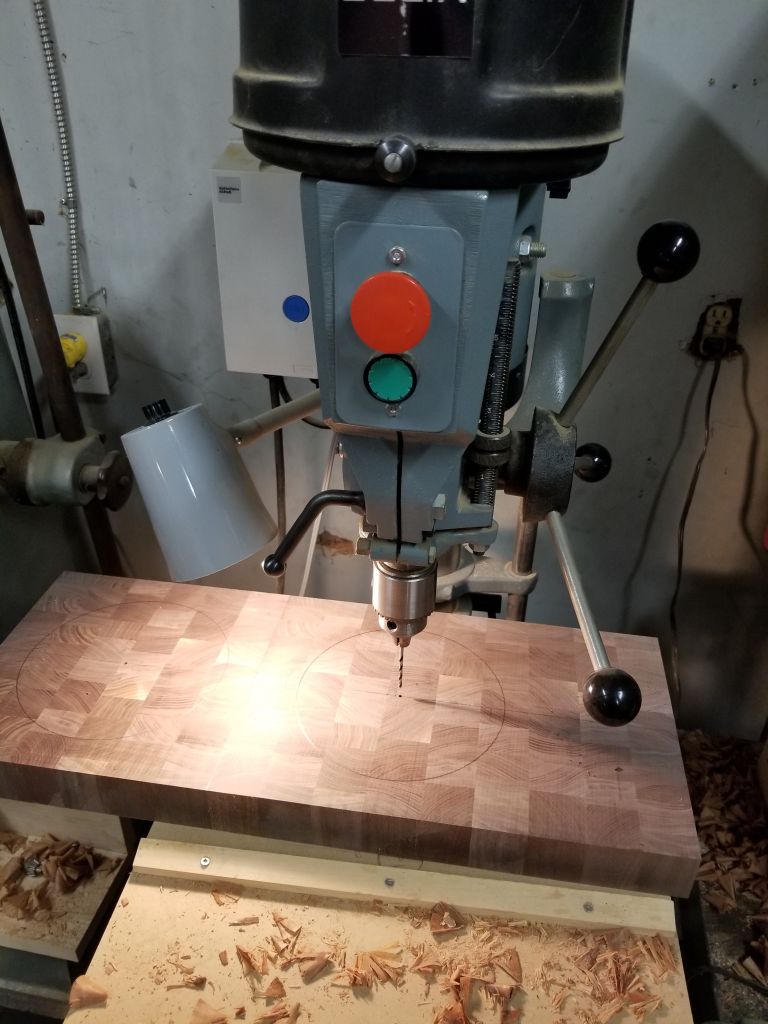

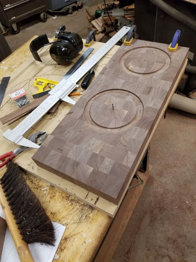

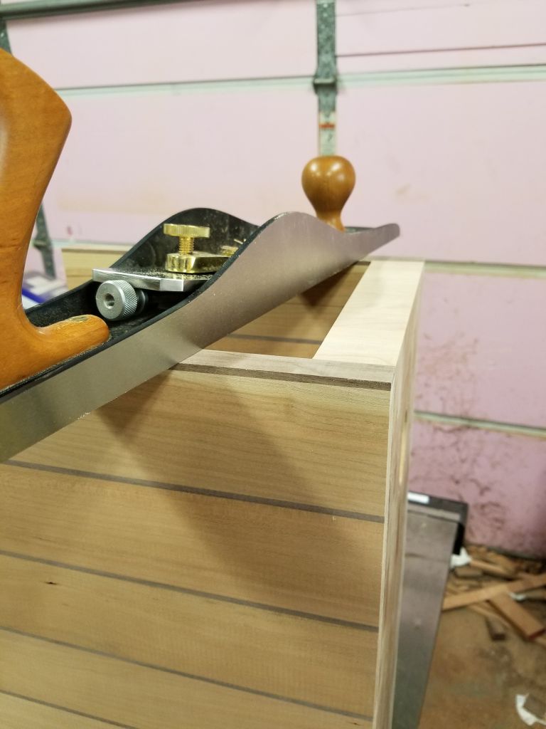

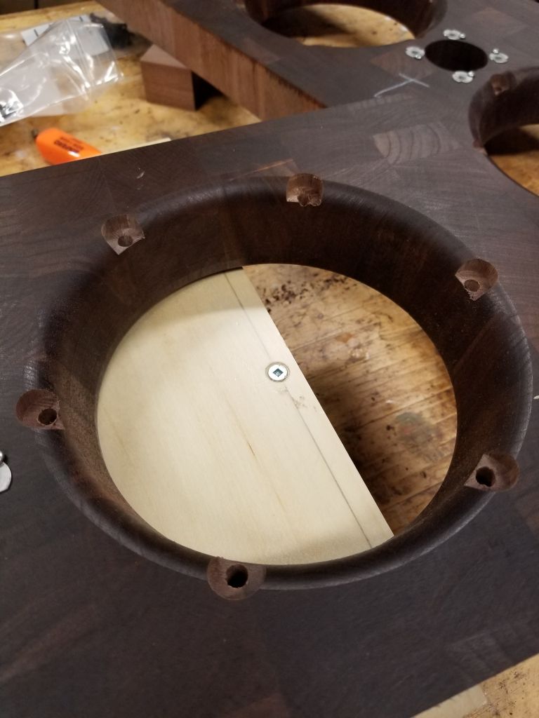

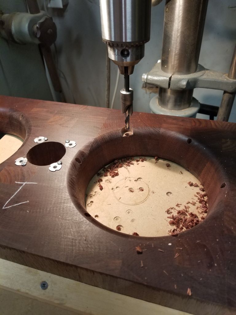

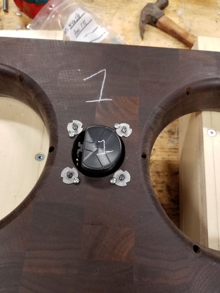

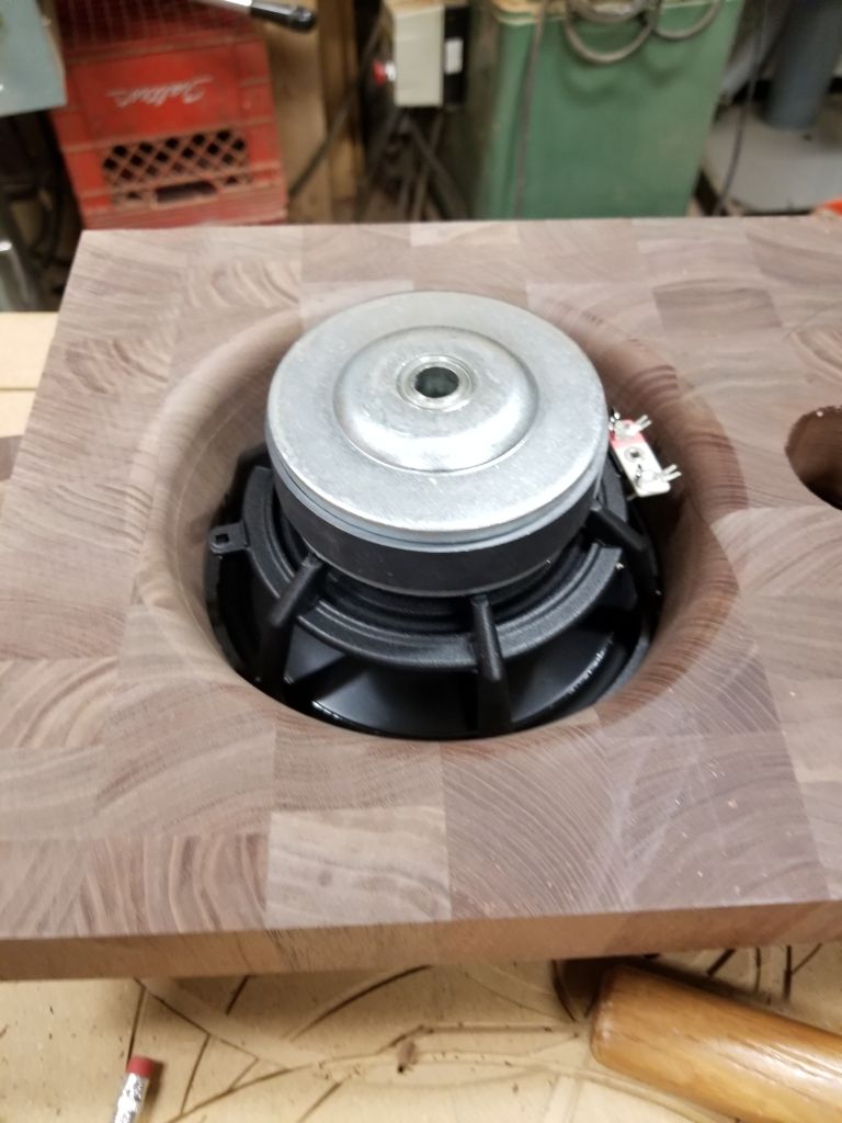

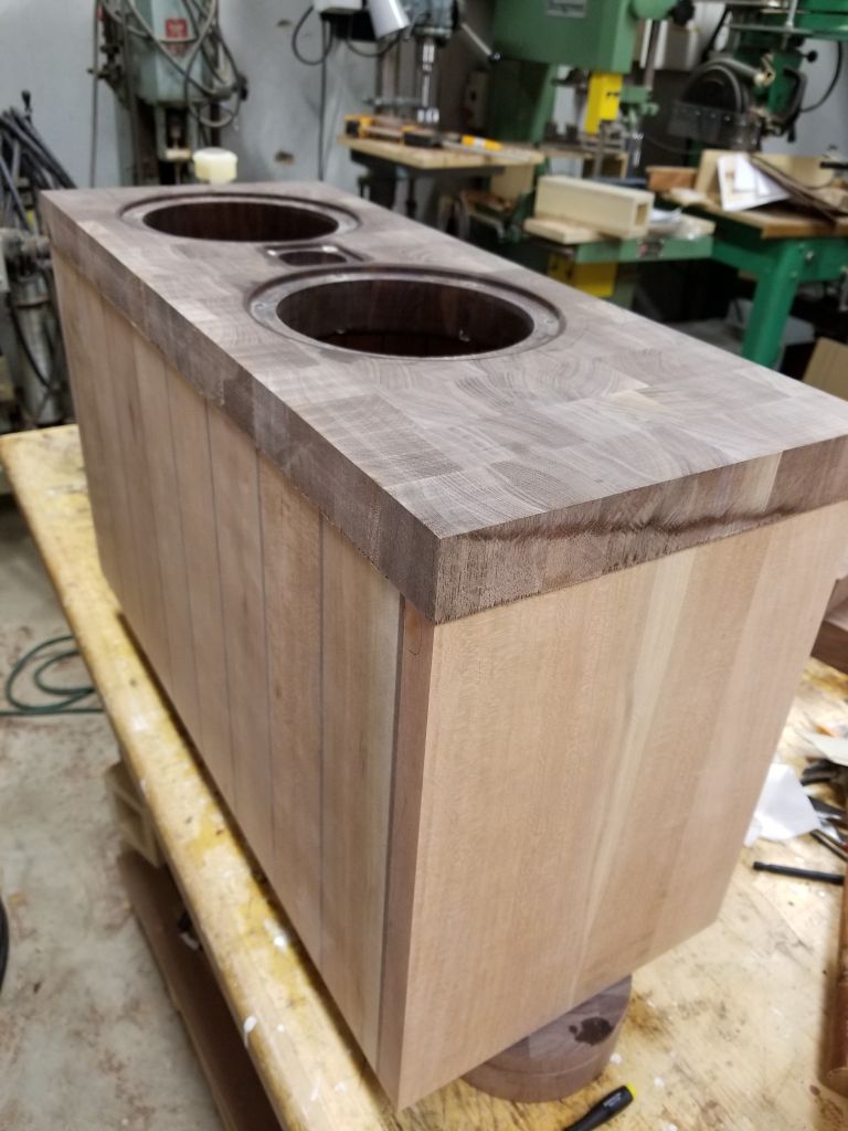

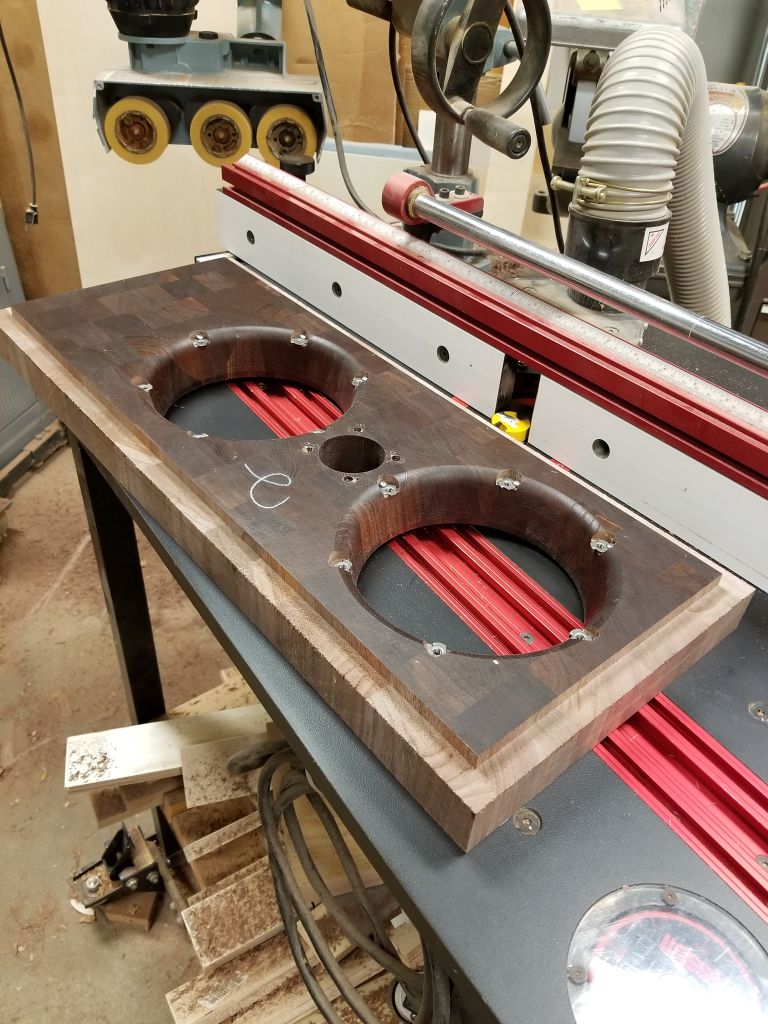

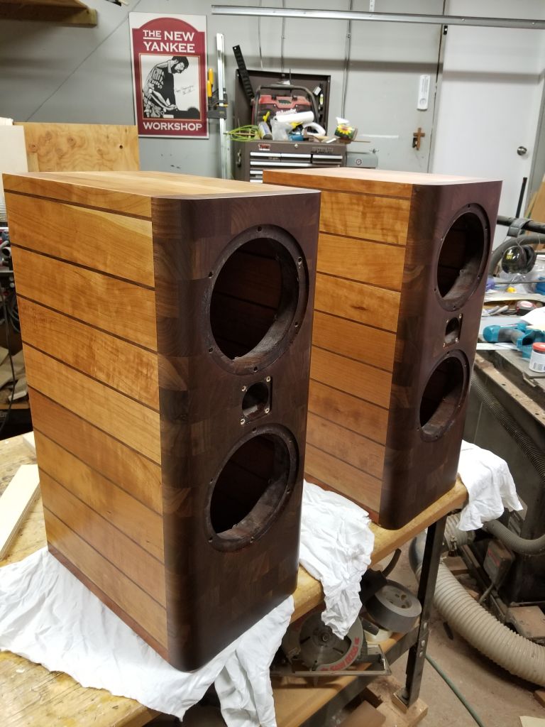

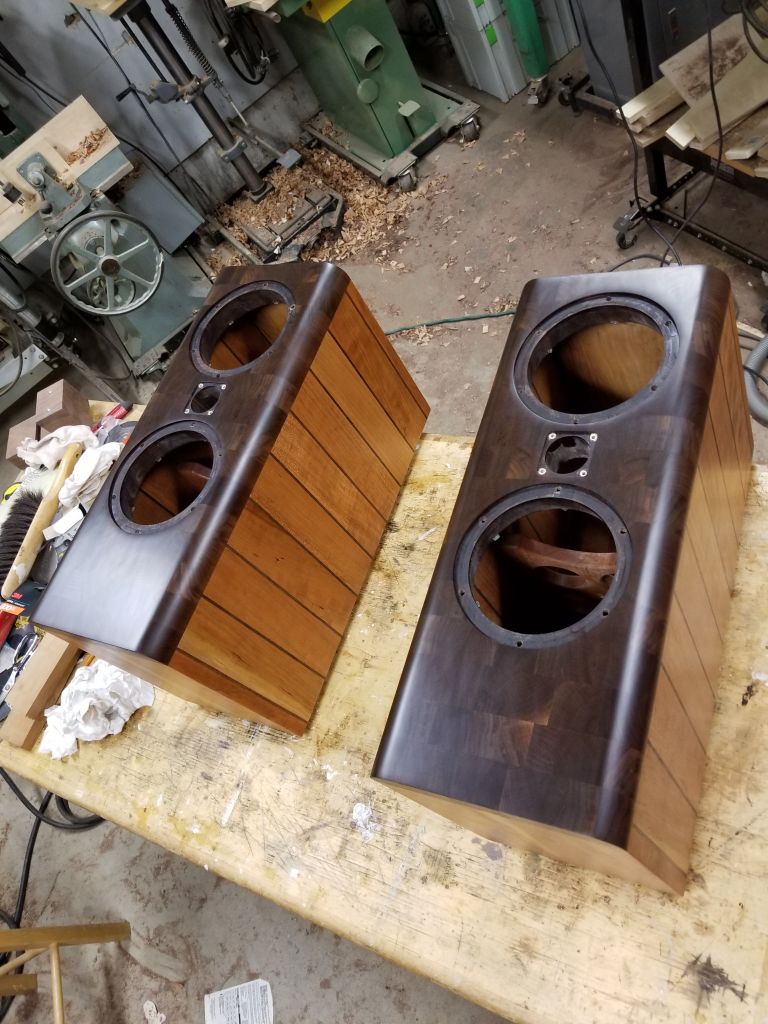

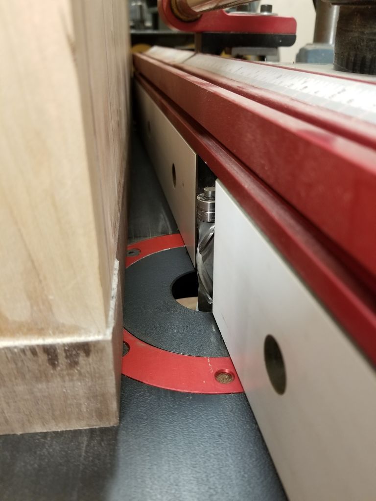

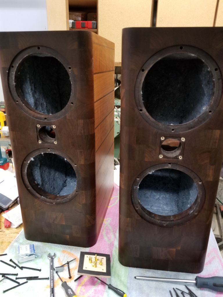

Amazing! More pics of the wood finishing, please! What did you use there? Danish oil or something similar?
For a finish I use a 1:1:1 mix of satin oil based polyurethane:boiled linseed oil:turpentine. Brush on, leave for 30 min to an hour depending on heat and humidity, wipe off. Speakers got two coats inside, three coats outside. This is a finish for dummies. Super easy to do. Just make sure you dispose of the rags correctly by burning them or hanging them to dry, otherwise they could self combust (I am serious about this!).

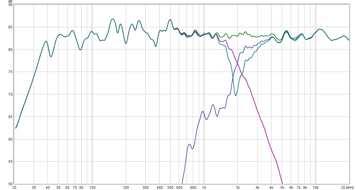

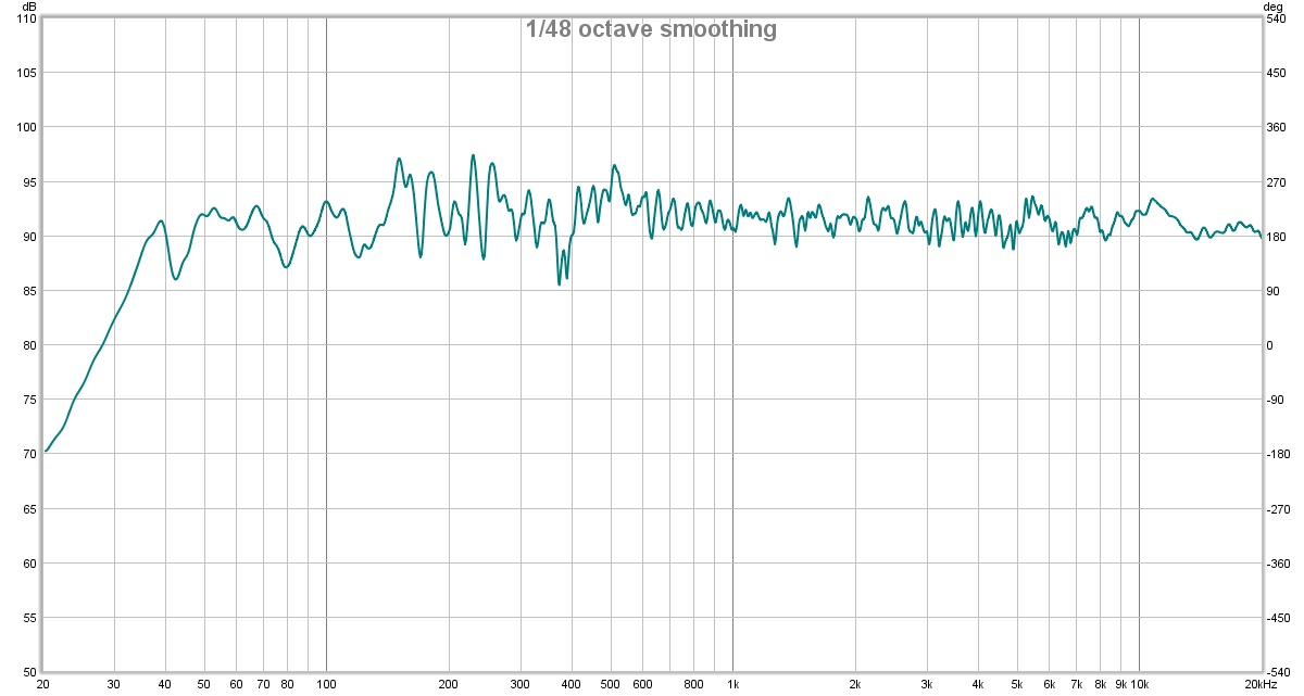

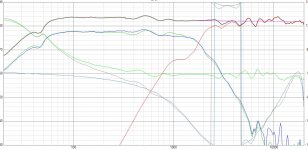

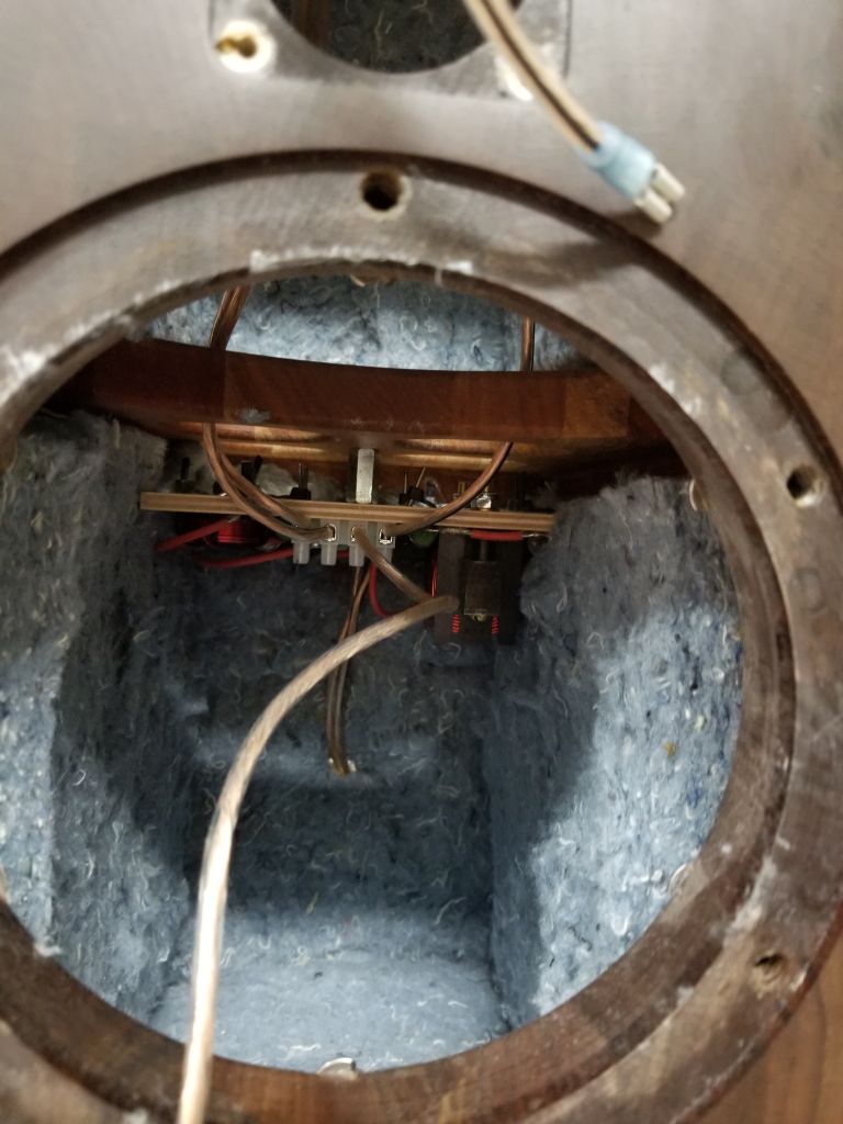

Are those real measurements? If so, how did you make them? What kind of room? What microphone did you use?
Hello,
Yes, those are all real measurements. I used a UMIK-1 and REW for the measurements.
They were all taken at about 25" on axis to the tweeter.
For crossover purposes the woofer was also measured at 1/4" and merged with the 25" measurement, baffle step compensation was added with,
FRD Blender and Minimum Phase Extractor
My living room, which is a good size room.
David.
Hello,
David.
Interesting. I would have expected a much less flat response when taking the measurements in a normal room but perhaps that's the applied smoothing.
Well done!
