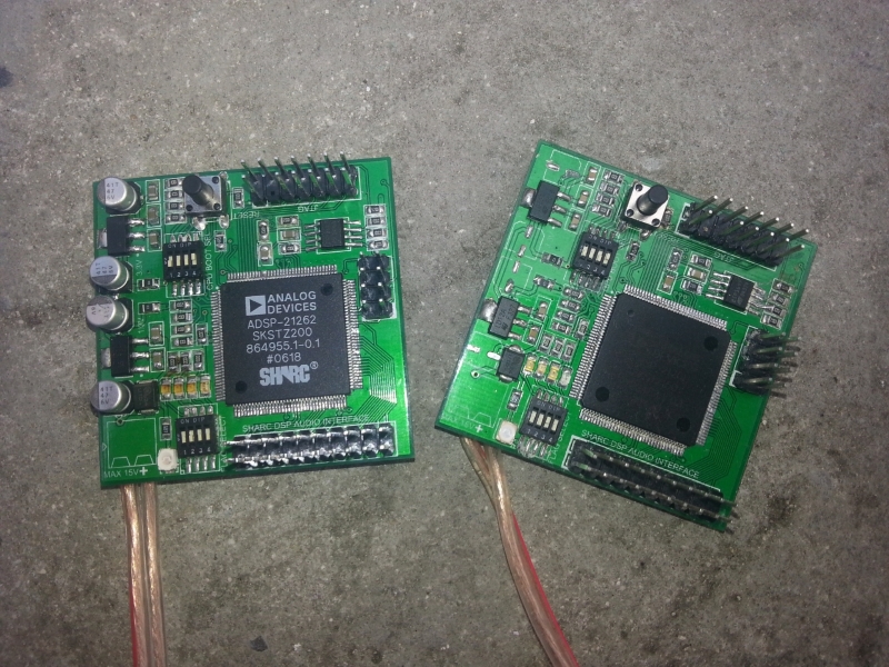

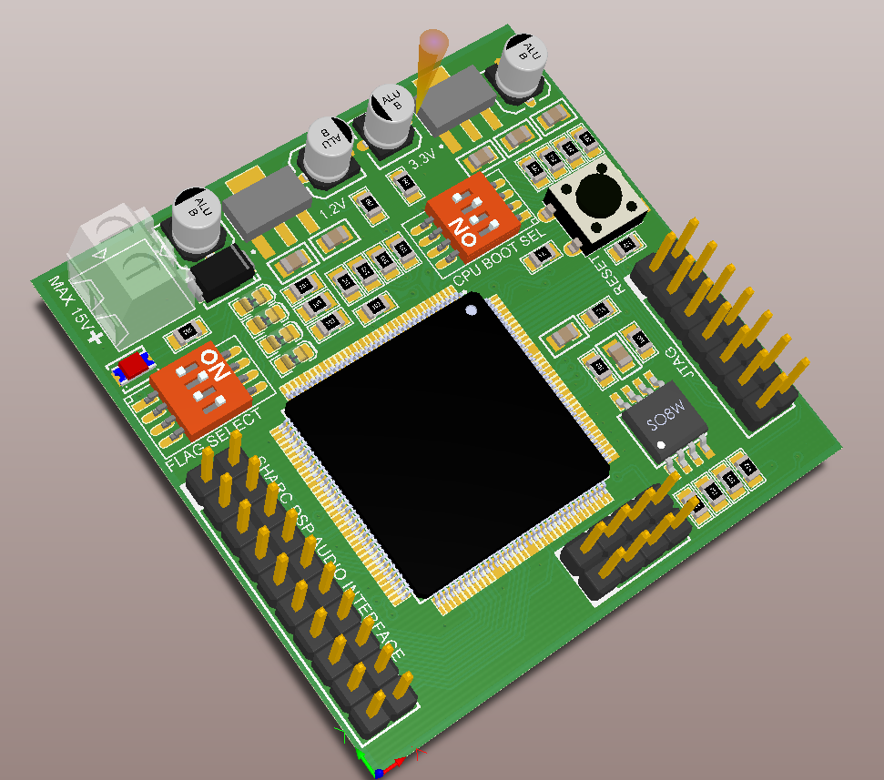

Perhaps we should start a open source project here?, I have already made a plan to replace ChocoHolic gain stage for he`s D amplifier and use a signal controller to perform misc tasks such as limiting, supervision monitoring such as temp, osc frequency and other supervisory tasks in code, its really really easy, and can do done with a *any* uC take your pic, and the ticks employed are far from esoteric... at the moment I have a 8-channel SHARC dsp project on my desk I want to complete first, so far I successfully booted the device, made a PCB however my relationship with it is occasional.

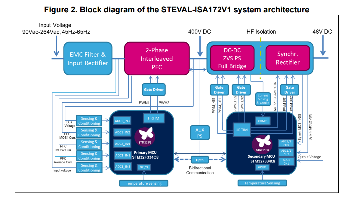

In non-trivial converters the comparators also need DACs with flexible I/O wiring for scaling reference voltages. Op-amps are usually required to buffer the DACs and make current sources. In a PFC the conductance adjustment usually ends up needing a DAC. In most chips there are no such features. Particularly some chips are designed from the assumption that everything must go through ADC/math/PWM. Re-reading may be useful. Additionally, in complex converters with more than 2 strokes (switch states) there is a need for sequencing PWM control modules, each module allowing to blank the comparators or timers of others, that in some chips is just not possible at all without lots of external masking logic. The people designing the chips have little or no idea of the problems that have to be solved to control converters really optimized for low part count and low natural resource usage.

During development I thought my solution was a bit high on the part count side, since the control circuit uses about 70 parts and the power section about another 30, all mostly small parts, only 2 big magnetics, but then I saw this PDF and noticed that they use far more parts, particularly more big and costly parts, 7 big magnetics.
This is a great example that proves my point of view. No real improvement in SMPS with these new DSP chips, not even cost improvement. No advantage at all in using a DSP to simulate an op-amp and a comparator doing an average current loop. And simulating more complex control eats MSPS and MIPS far above the capability of low cost chips.
