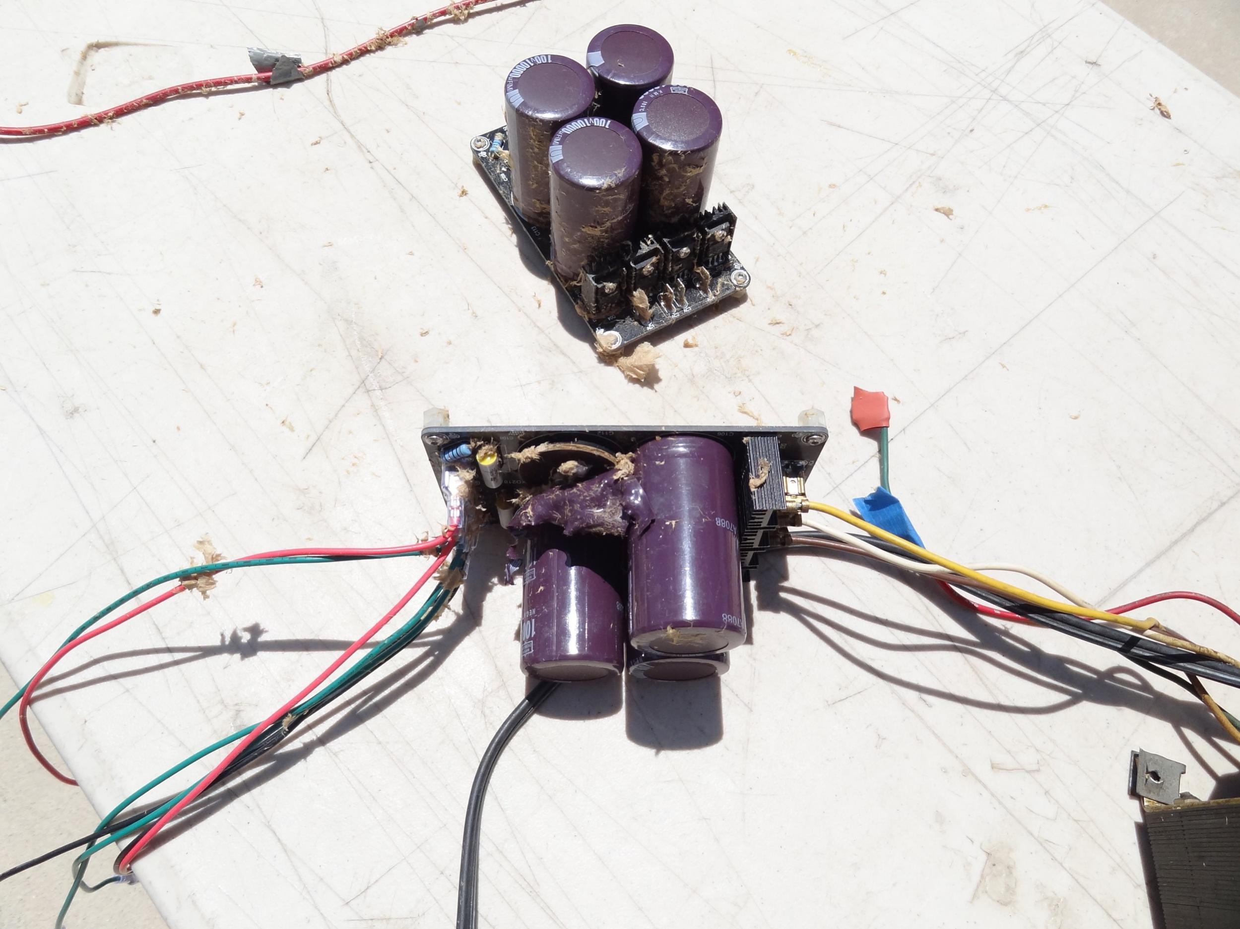

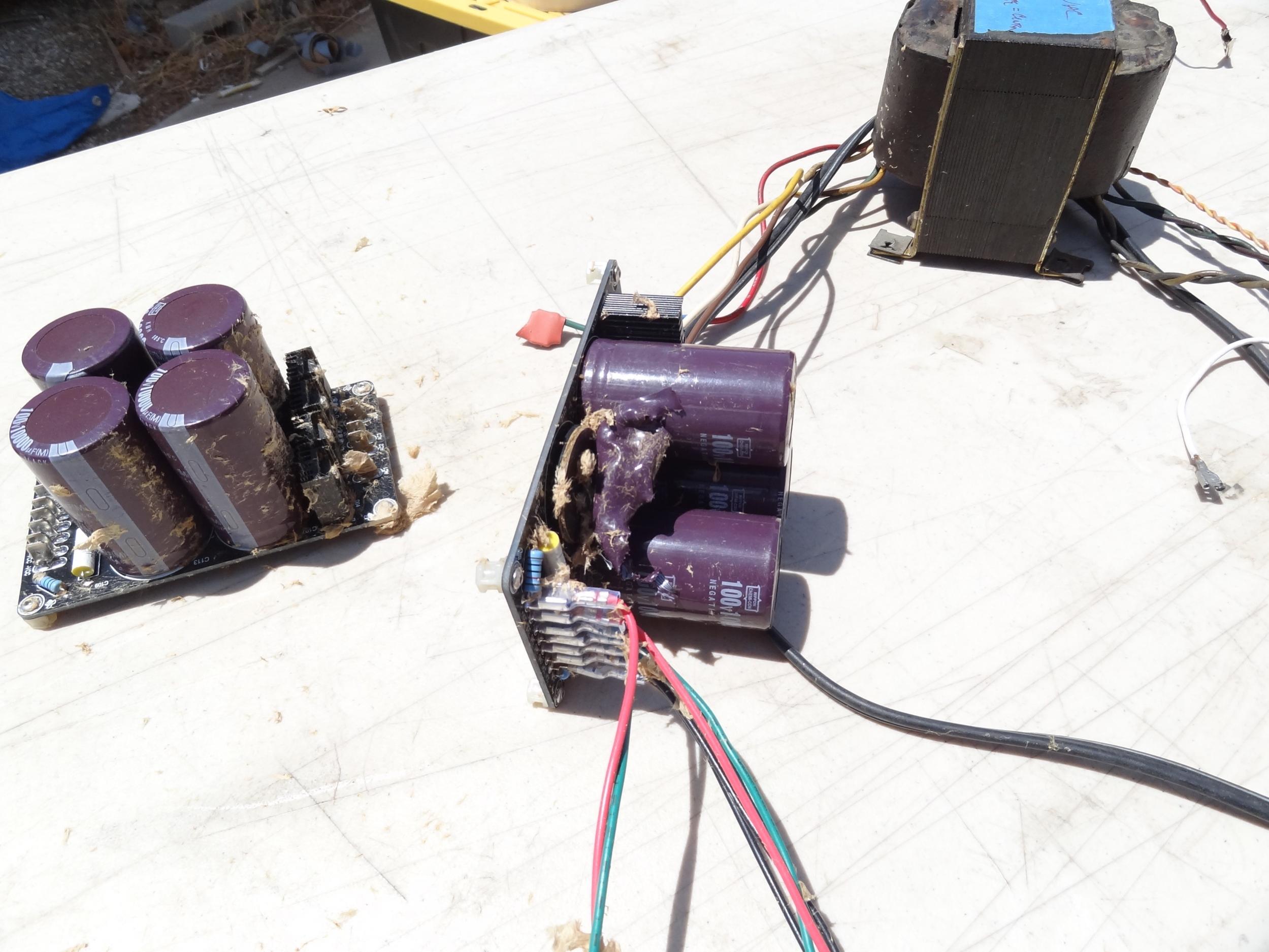

Here's the story. I had my eyes on these PSU units for quite some time as the price was very good and seemed like a nice complete unit. I have been putting together a Slewmaster setup with two seperate sets of OPS so I can compare different topologies and so wanted identical power supplies for both systems. So, I ordered the two units in the picture. They came yesterday so to test I hooked them up one at a time to my transformer which is a 55-0-55vac, through a light bulb tester. I noticed the light bulb continued to glow slightly so I felt the caps and noticed one was warm. I tested the second unit and it seemed OK. So, I hooked up a separate bridge with a 27K resistor to try and reform the cap and see if that would solve the problem. I left it hooked up over night to give it a good chance. This morning when I checked it, the resistor still showed about a 6V discharge. I disconnected it and gave the normal hookup another try. The cap got warm again so I disconnected it. I hooked up the other unit and turned it on. Everything looked OK and I didn't feel any heat so I left it connected to test. After 5 or ten minutes the one cap exploded. Wow, I've had them pop open and let out smoke out but never explode like this one. I'm just glad I was doing this outside. I had suggested these in another thread so I thought I had better let folks know so no one else would buy one. Maybe they would be OK at low voltage but they are advertized as 100V units so they should at least handle +-80vdc.
I am attaching a couple more pics from different angles in case someone thinks I have made this up.
I have sent an email to the seller to see if he will make this good. I searched ebay and there are a few guys selling these. I am tempted to send emails to all of them and warn them that these are not what they seem.

Wow... we are involved in a dangerous hobby 🙂
I hope nobody's injured.
I had 2 caps exploded during test exercise about 30 years ago. That was totally my fault. I was much younger and much less careful, so I messed-up the polarity of two 10'000uF caps. At some point the outer covers (the "cans") just shot into the sealing with a loud "bang", like two bullets, and those small paper pieces - or debris, if you want - were all over the place.
I still remember that smell... Still happy I was not over the PSU at that moment 🙄
Everything that does not kill us, makes us stronger... and more experienced 😀

Yes, but no way to invert these. It comes as complete unit with bridge installed. Just hook transformer to AC terminals and go. This had a bad cap. Weird thing is both caps that seem faulty are in the same location on board.Who knows, probably all caps are bad and just the weakest went first. No matter now, I will not try again, too dangerous!

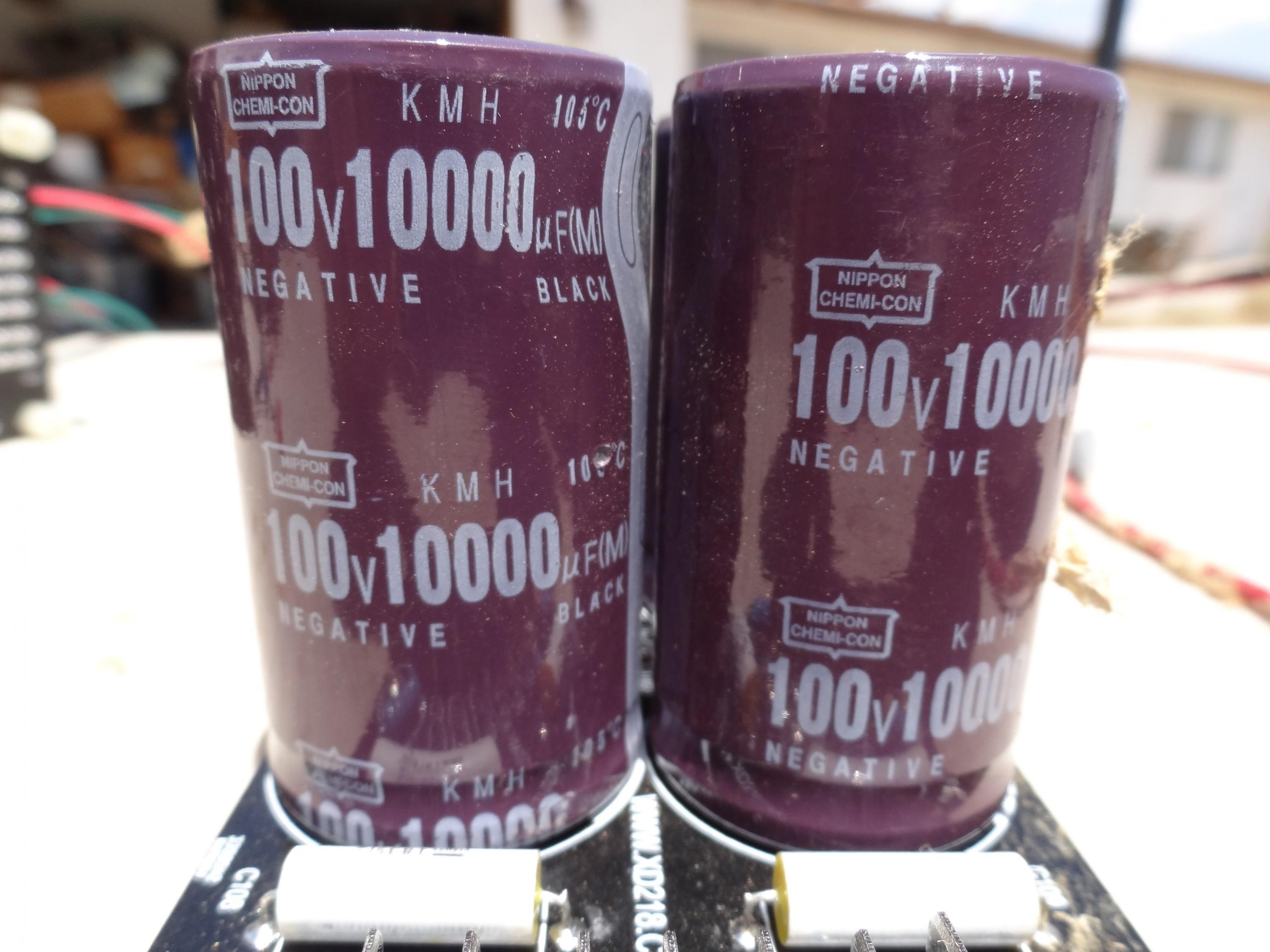

This is the ebay add.
4 10000uF 100V High End Power Amplifier Board | eBay
Some of the adds call the caps Rubycon. This guys just calls them Japan Ruby. The caps themselves say NIPPON CHEMI-CON. See the attachment of actual picture of the ones I have.

Regarding the PSU units I bought I just received this from the ebay seller.
Paypal also responded that I have received a full refund so at least this seller appears to be a stand-up guy.
