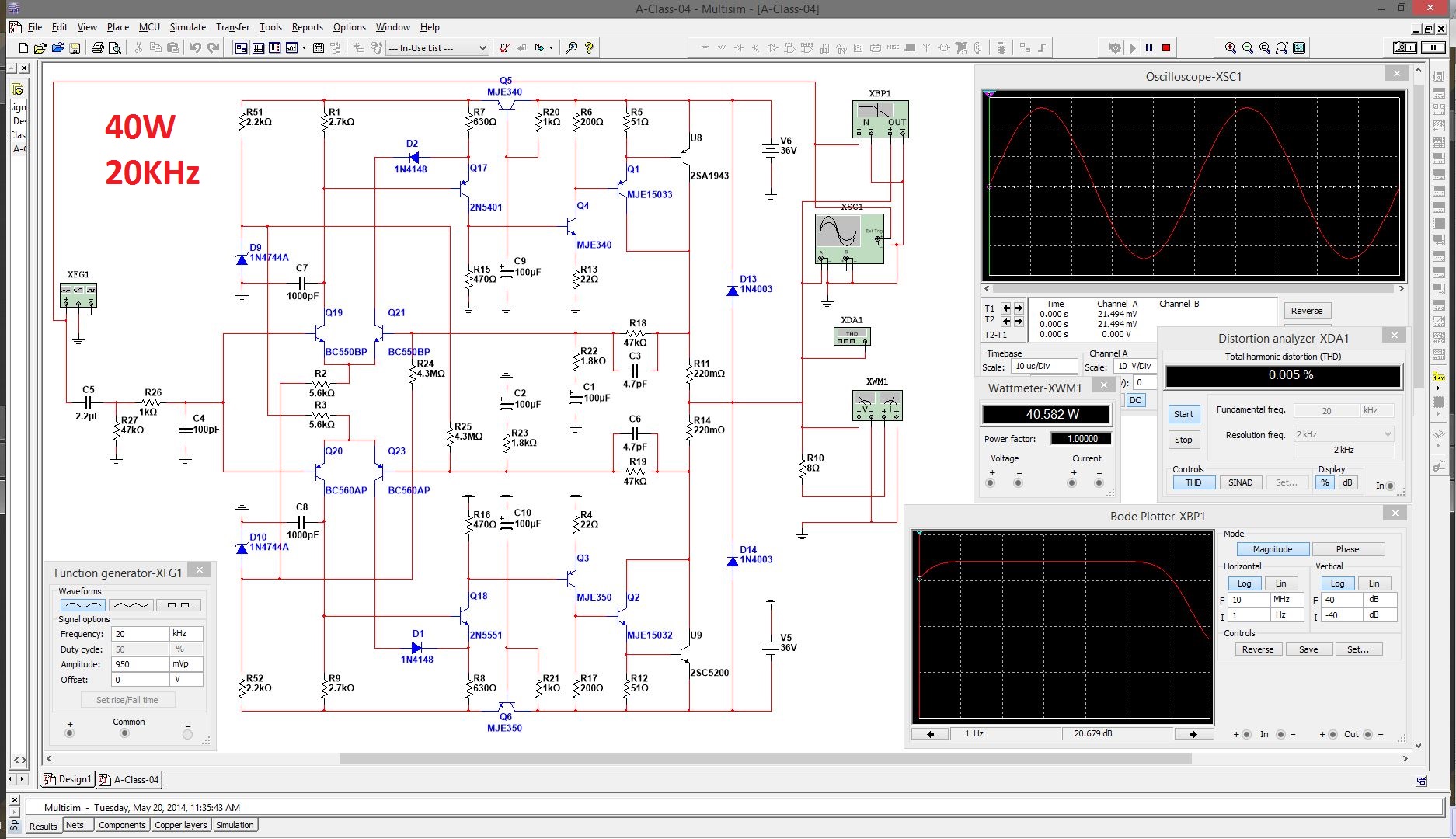

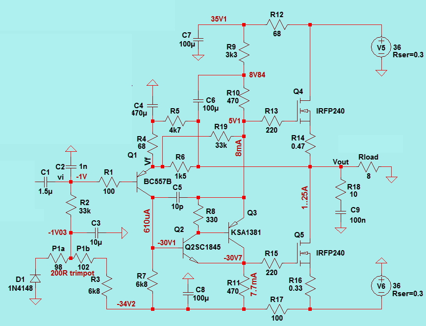

So, Uncle Charlie, in a genuine provocation challenge you...... because you are a challenge lover....to make a better Class A amplifier.
- First of all..... i would say...you gonna fail😀
- Second i would say....gonna waste your time🙂
- Third thing i would say.... no one can do it😱
Several have tried...even the best from the best...the cream from the cream...this one has efficiency (30 watts RMS output)...and low distortion.... i can reduce distortion (THD) to less than 0.028%.
Great designers made good stuff..no one made so good as this one.
Let's see if you can beat this one....hehehehehe.... will fail.
You love open designs to tweak....here is your moment.
Conditions guys...1.9A each rail.... 36 volts each rail, THD less than 0.03%)😱
Picture shows an old friend of mine.... Akio..... one day i will tell you the one designed this one together uncle Charlie..... Morita is already dead.
This will be funny....sorry...Uncle Charlie already started to laugh...ahahahahahahahahaha!
regards,
Carlos

Please, post your Class A design
Post your simulation, your prototype if you have courage to build it and post movies and pictures about inspection using scope or spectrum analyzer
Enjoy...do you believe you can do it?
I doubt ( hehehe...arrogance is good to challenge) and challenging you to prove you can.
Voltage, current and power can be plus or minus 20 percent...no problem.
Picture was an advertisement made by São Paulo Government, to say people should cross street in the correct place...because there's a high speed lane to buses down here.... this advertisement was latter removed as looked too much shocking, but i have used and published in many amplifier threads, showing that i trust competition will be crashed easy by my amplifiers.... arrogance drive some people mad, others understand as challenge and build the stuff to see if they are really good in an attempt to crash Uncle Charlie...usually they do not do that..because my amplifiers are really nice.
Please, be aware that exist fake capacitors, to my amplifiers i suggest you to buy good, reliable brands to avoid to fake something this guy from Indonesia have faced.
regards,
Carlos

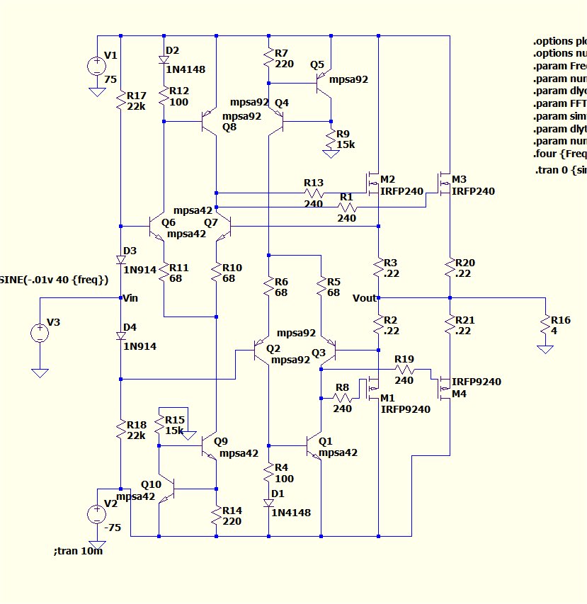

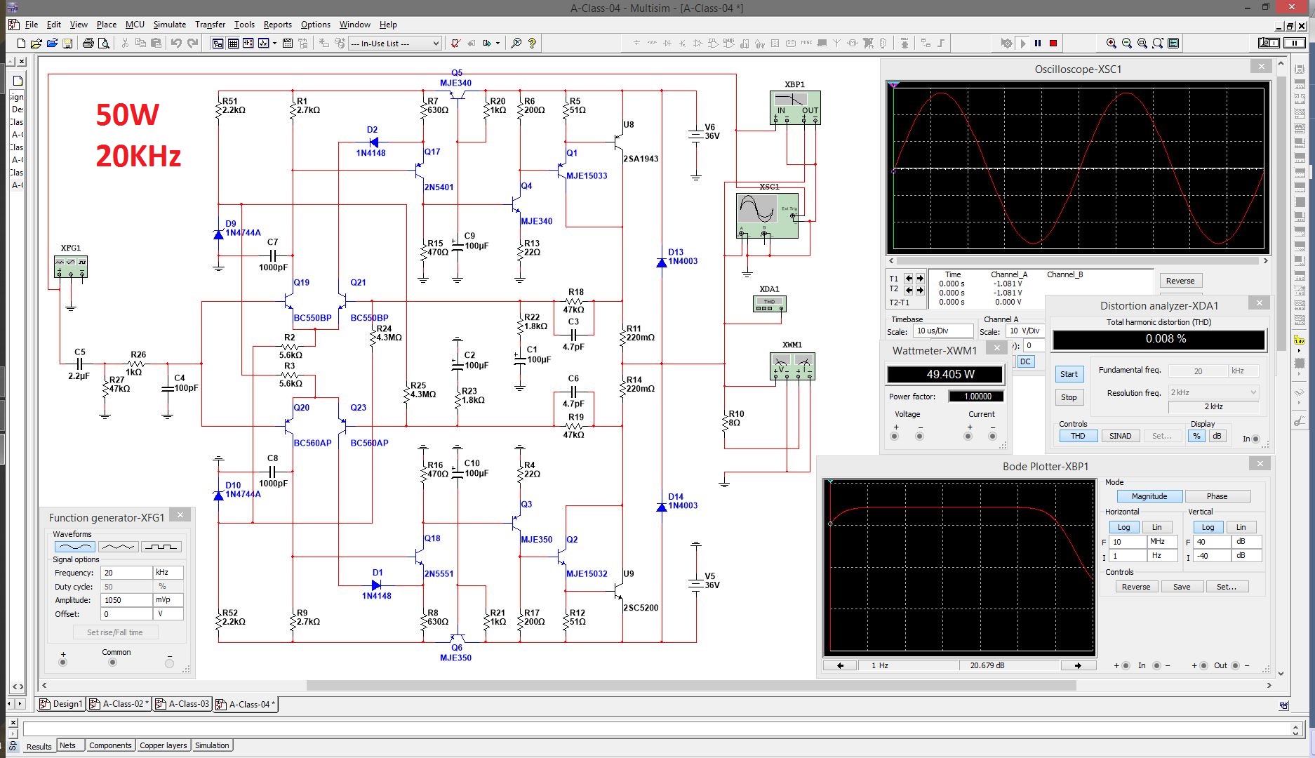

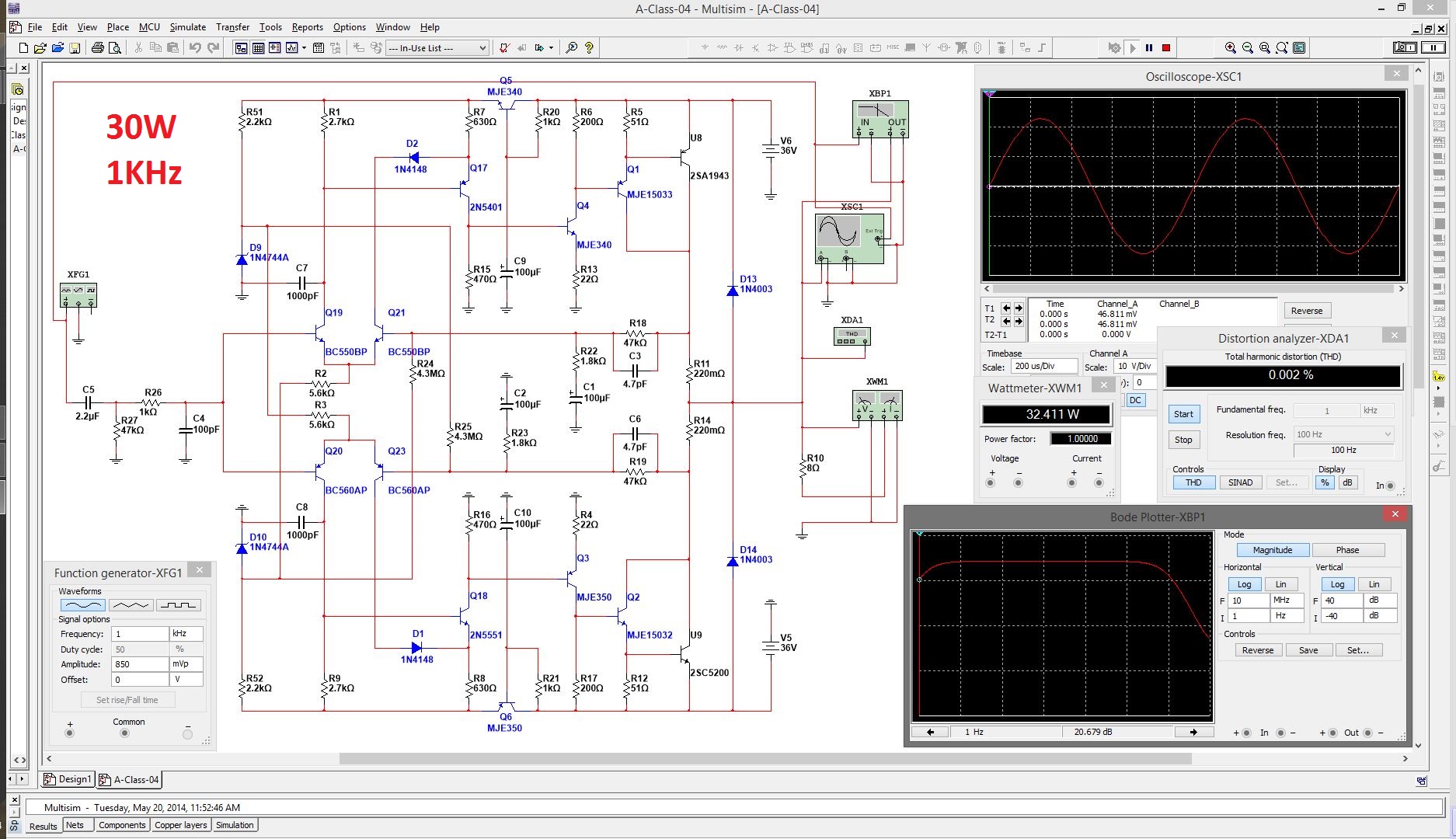

If you decide to build..then have attention
The trimpot adjust the off set.
The iddle current you can adjust into the source resistors... reducing the value the current increase and the distortion reduces....increasing them you reduce current and reduce distortion...the circuit is already optimized...0.47 ohms up and 0.33 ohms down.
These guys that "thinks" they have knowledge will believe this is an error...hehehehehhe....no error.....it has a purpose.
This monster goes hot...aprox. 100 watts....but efficiency is awesome to a Class A..goes more than 28 percent easy.
I am not that special as a designer, but the guy did it with me is a monster ...the guys knows a lot...and one day i gonna tell you the name and you will be very surprised...one day...do not know the day...one day....first let's wait designers come to try to beat us...hehehehehe..this gonna be funny.

We left something missed for you to fix
Symptom is overshot...but for sure you know how to fix this....it is basic in electronics.

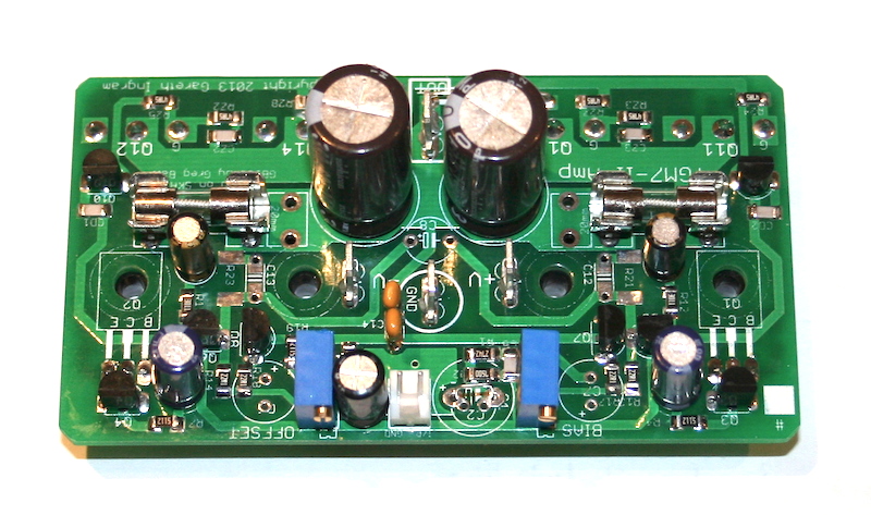

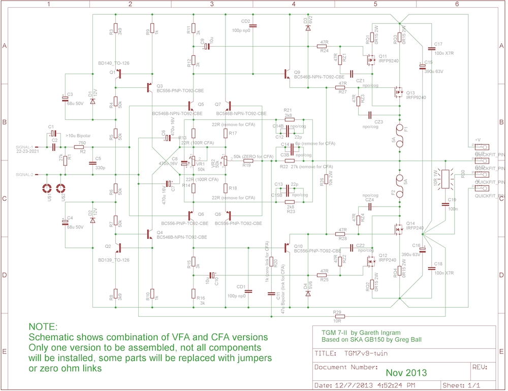

I like the bias trick with D1. I have also been playing with this for a super simple singleton amp.
Nice simple design BTW!
Class A , no problem ...
Most (all) of the standard AB input stages already are class A.
Just run them on a class A output stage.
(below output stage)
- the standard blameless is .0001%
-A leach is .0006%
-a symasym is <.001%
-the 2 CFA's are also <.002%
ALL PPM without the "dirty" class AB 😀 .
90% of THD is the output stage switching.
PS - the "challenge" would be to get that Genesis output stage
stable (error correcting OPS) .... it really beats any of the others (in a big way) ...
I even heard the real thing !

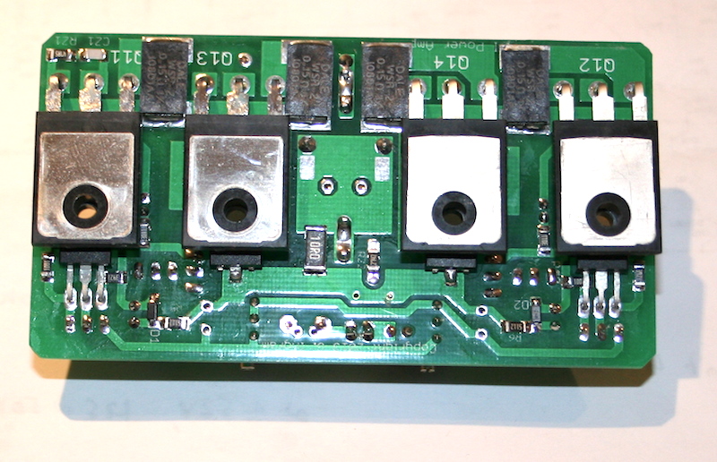

my opening bid is my TGM7 biassed into Class A.
You see the big man, he's gonna smash the competition to the TGM7

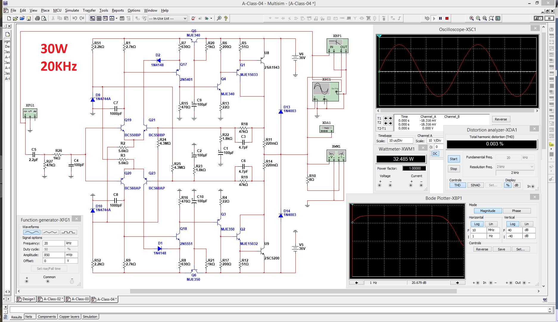

Hi Carlos and All, here is my design.
I played with this design during some time, you just made me finalizing the model 🙂
The overall concept is the same as used in the one OS showed in #12, also similar to Musical Fidelity amps, however it has got some specialties here.
THD is shown as follows (8 Ohm load):
1) 30W, 1KHz;
2) 30W, 20KHz;
3) 40W, 20KHz;
4) 50W, 20KHz.
Otherwise, the pictures are the same. Zobel network is not shown.
Not prototyped yet. Maybe later 😉
Valery

Thank you very much dear friend....nice schematic
You are welcome to "cook" this amplifier till it become more mature.
Приветствия доблестных русских людей
Above sentence means "Salutations to the valiant Russian people"
You amplifier is a promise of a great unit!... awsome low distortion to high frequencies in such level of power.
You see folks!....some guys have courage and can face a bear with a smalll knife..others run away and cry for mum.
regards,
Carlos

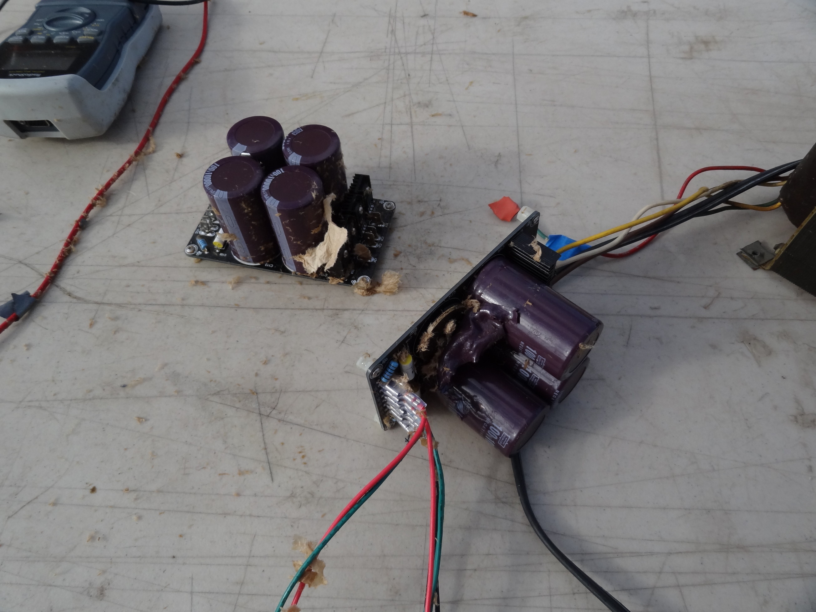

Happened with you dear Terry?
Picture tells us the story, but if happened to you let me know......
Why this question?.
Because in the internet people use to distrust in some images..they say (from time to time) the stuff we post was made in photoshop software (as an example).... knowing the source (you for instance) i can confirm the stuff is real.
Have details.....capacitor with XX volts insulation and supply was xx volts and then.... even this way exploded.
I do not distrust on you....no way..absolutely, i feel you down here...from Brazil i have captured...i know who are you....an entire Highly decent family..... the problem is the internet..... the facebook for instance..where my friends use to post "photoshoped" stuff...so...they may think this may be one more.
You can see my image when i have just arrived from Planet Rabbit.
Thank you very much by the image, the interest to help folks (this is you... a sensitive religious man)
regards,
Carlos
