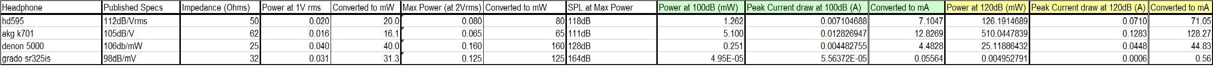

apples to apples
Due to the fact that manufacturers can't seem to agree on how to publish Headphone sensitivity. I have put together more meaningful data for the headphones previously discussed.
If there are mistakes please let me know, and I will update it.
Anyway see the attachments for the results.
  • apples to apples.zip
could you explain your reasoning?
Thanks for your calc effort. Something wrong in the Grado calc?
Not if the published spec are correct (ie 98dB/mV). When you think you have 2000mV from a cd player then it becomes pretty obvious these things will be very loud at max output from cd player.
I suppose this is why they can be run out of an ipod without issues.
To get the most out of these headphone I would be investing most of my money in a very good attenuator, and a very good power supply (ie yours), since you will be attenuating over 95% (actually it is probably more like over 99%) of the signal from the cd player.
Or the published specs might be total bull poo.
