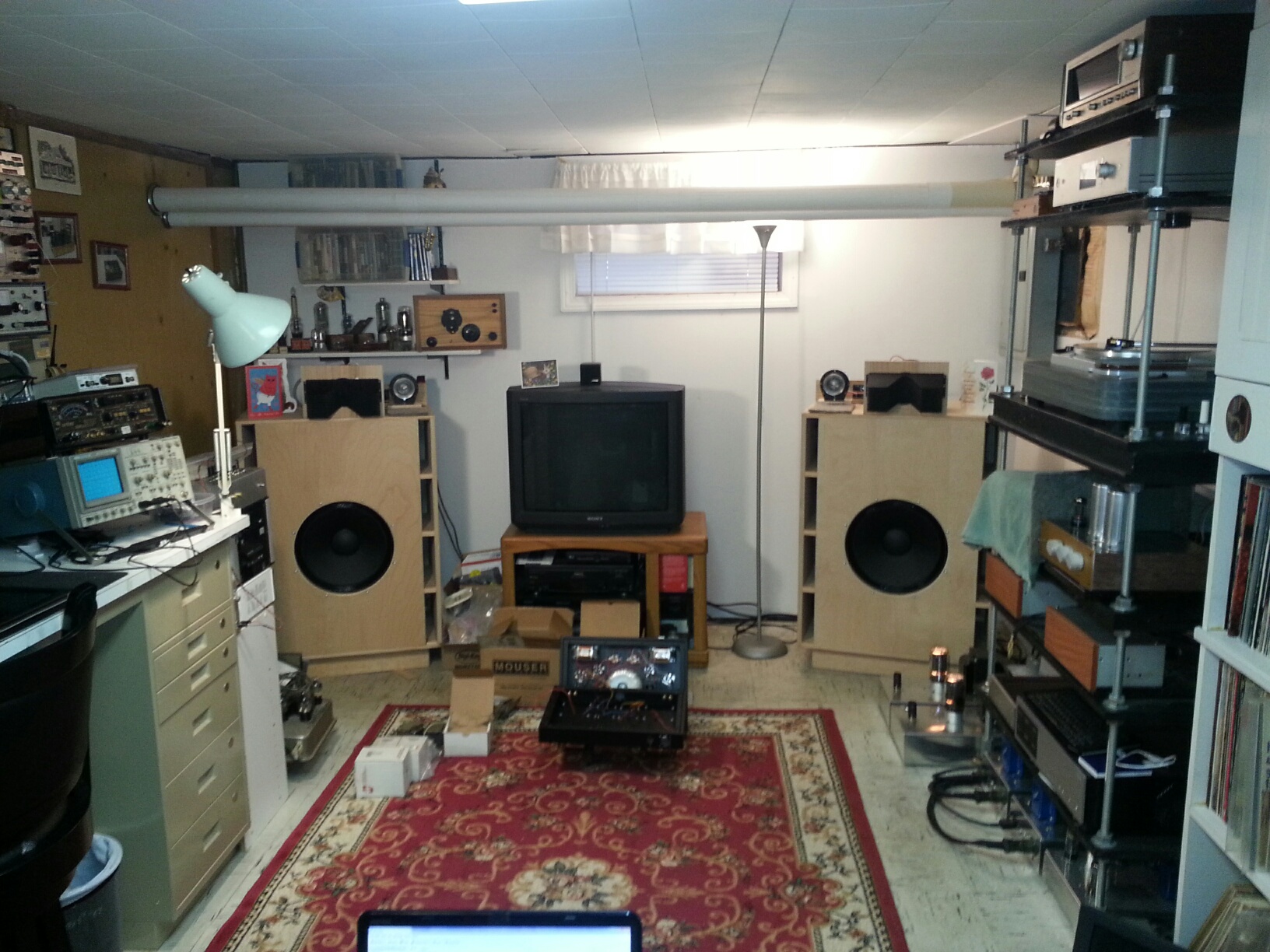

Interestingly enough the 2440 'phragms (they arrived this morning) are an improvement in some ways over the 2441 they replaced, and in about the way I expected/hoped for.
I'm thinking about other horn configurations for the 2440s in the future, and an XO respin at some point. (LR 2nd order design I did 7yrs ago)
I'm being lazy, but I really, really need to do some new room response measurements to determine what I need to do next.. 😉
The mids sound a little fuller, and the slightly etched/strident quality is now gone.
There are a lot of minor problems with this speaker system some of which can be fixed with effort, all of my own doing and resulting from lack of knowledge / experience at the time I designed them. Some are easy fixes like mounting the mid horns on an appropriately sized baffle, the current ones are too small. (coming very soon) One problem I cannot fix is the acoustic centers between the Iconic 165-8G and the 2440/2311/2308 is too great, and this I cannot fix. (I have not yet identified any audible or measurable issue at the listening position.)
I've included a picture of the room and system, it is as they say what it is. No real option for significant changes - it's the one room in the house that's mine.. 😱 Despite the obvious clutter and visible issues it's actually by far the best room I've ever had, and I have heard far worse elsewhere in recent times; somehow I got somewhat lucky, although I also put some thought into this mess I'll admit.
The sound is very immediate, and at the listening position cohesive and detailed. Imaging is very good. Bass extension is down into the low 30s, top is handled by early 075s with their original 1950s vintage 'phragms. Power available is 20Wpc and efficiency is around 100dB excluding room lift. It's quite dynamic and yes it can go very loud even in the bass.
