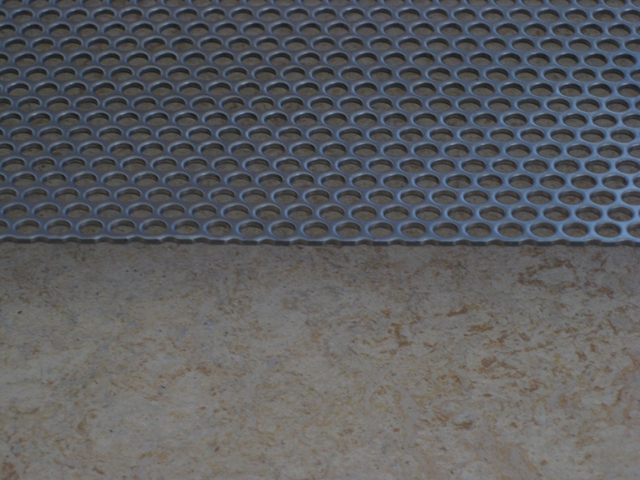

Why should I put time and effort into filing the edges on the metal sheets/stators?
The potential will be uniform through each stator and no sparks will jump between edges.
Between the stators there will be non conductive spacers so there should be no problems there either?

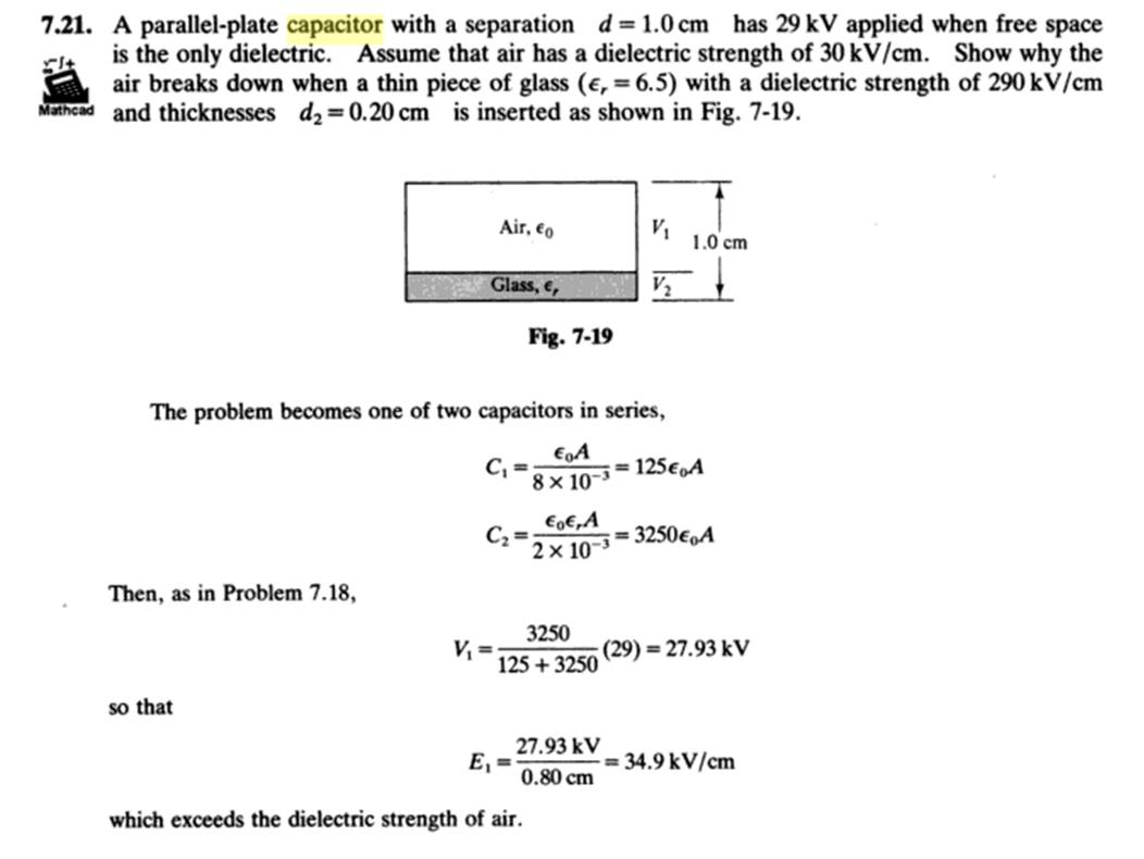

A counterintuitive fact is that inserting insulating material with high dielectric constant in between the stators actually encourages coronal discharge by pushing most of the voltage differential between the stators into the small remaining airgaps between the stators and insulator. This results from increasing the voltage gradient in the air near the stators, rather than reducing it...which was probably the goal of inserting the insulation material. This behavior occurs for both AC and DC voltages. When I first encountered this problem it puzzled me as it seemed the more I tried to insulate the stators the more easily corona formed on them. Taking a step back and thinking about what I was actually doing, and things clicked and started to make sense. See Attachment for a text book numerical example.
Fortunately, the 3M foam tape that most people use for spacing material has a dielectric constant not much higher than air, so this isn't a problem. But, if you decide to use PVC, ABS, or some other plastic as a spacer to separate your perforated metal, you will find corona forming where the stators contact the plastic spacers at significantly lower voltages than it forms anywhere else.

I'm talking of smoothing/rounding the outer edge of the stators where there are some sharp edges from cutting the sheet metal into the right size for the stators.
The outer edge will look like:
Stator | foam tape| uncoated mylar film | foam tape | Stator
I was planning on taping the outer edge with electricians tape as well and it's supposed to be good for up to 10kV?

Thanks CharlieM, if that's smooth enough it'll go pretty quick and easy but I still have 16 panels in all that I'm prepping.
4 small curved
4 medium curved
4 small flat
4 medium flat
I have 4 trial runs with the two small pairs before it's crunch-time.
