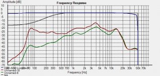

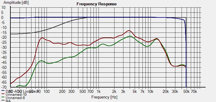

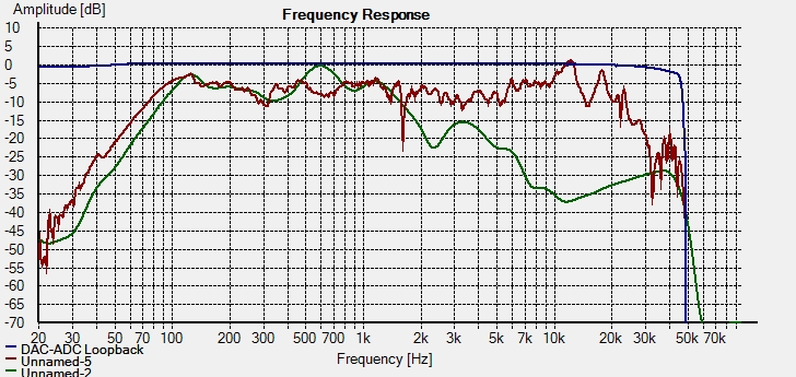

I did some quick frequency response measurments of my little panels today so maybe these can be of use to you.
These were done with no eq.
The Red plot is with the microphone (Peavey PVM520 TM) about 1 inch from the diagphram and the blue line is the signal.
The Green plot is with the microphone about 18 inches away and the black line is the signal.
I am still not quite familiar with HOLMImpulse and when I implemented Highpass I didn't notice the low frequency rolloff slope
The humps I believe are from reflections from many nearby flat surfaces off of my monitors and such.
I have found by using a digital VST crossover that I can set it as low as 240hz or 250hz without any coloration's or restrictions in vocals or instruments using Deep Purple's "lazy" as a sample running it full range (no eq ).
Below 240Hz the Diagphram resonance's start to color the sound.
The second Graph was done the other day and was EQ'ed to be flat with no dedicated crossover but biamped using the filters on my mixer as the crossover with a Sony 5.25" SS-MB150H speaker box using only the woofer and duct tape over the tweeter.
The plot of this setup is shown in Red and the woofer alone is in Green.
Both graphs were done without the VST crossover.
My panel being about the same width as yours seems to have a natural roll off around 600hz to 300hz (-3db at 400hz).
I don't have it setup to do extremely accurate measurements yet as these are just some quickies that I had done just to see where I am at.

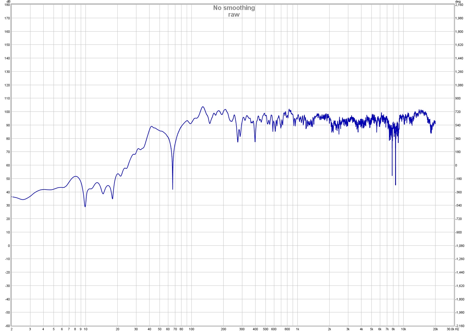

Measurements
I took some frequency response of the panels and they look pretty good to me, but I'm no expert in these matters, so your comments are appreciated.
The first graph is a measurement of the noise in the garage without driving the speakers and me being quiet.
The second graph is the frequency response of the small panel alone.
The third graph is the response of one of the large panels using four torroid transformers for step-up.
The fourth graph is one of the large panels driven by two oil burner transformers in parallel/series.
The last graph is all three panels with the large ones driven by the 4 toroids and one channel of the amp and the other amp channel driving the small panel.
The frequemcy response of the oil burners sucks, but it does go a lot lower in the bass and they do swing more voltage.

Looks like the large panels have a resonance of about 52 hz and the small one about 130 hz. The Behrenger DCX2496 crossover should be able to filter out these peaks. The response from all the panels is so smooth that I think I'll be able to use a 6 dB/octave crossover slope and set the crossover to somewhere between 600 and 1000 hz. What do you think? The other option is to use the oil burner transformers and set the ctossover to 48 dB/Octave at about 400 Hz. I guess I'll have to experiment once the frames are built and they are moved to my theater room.

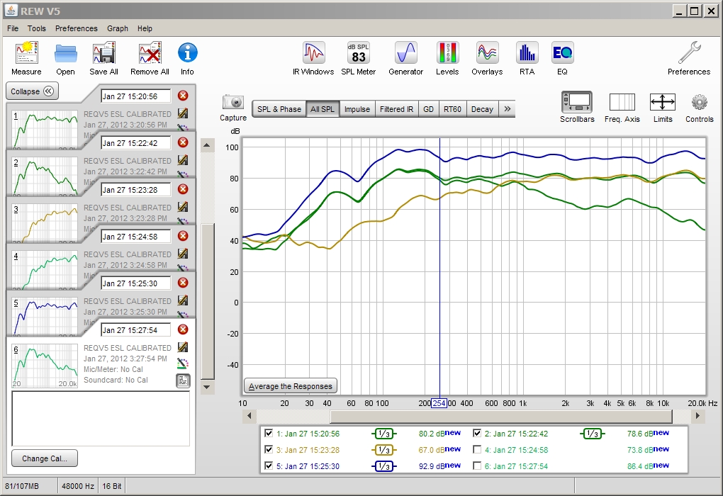

Those Graphs look real nice I just did some more measurments today as well,and I got some really flat lines by placing the microphone about 2 to 4 inches from the speakers and running them fairly loud.
This helped a lot reduce the effect of the room reflections.
The phase response was flat at 85 degrees across the bandwidth too !!!
This helps to show that the accuracy of them was quite spot on and this was with the little woofer as well.
I used REQ V5 for thes tests and I would post the graphs for you but it doesn't have a export graphics function so I have to find my Screen capture program to do this.
I have them saved so I can do this later.
Measuring at a distance will show you exactly were the cancellations start to occur.
For my little panel this was about 600hz.
Being the nature of the panels being both ESL's I think that 6db slope should be good or even 12db.
But 12db to 24db may be in order to help with the low frequency saturation limits of the high frequency step up transformers.
Also to limit the high's going into to the oile burners because those will have a lot of extra capacitance and the high frequency's will cause a very low impedance to the amplifier.
Those may need even a higher slope.

Here is the measurement from my 1.2 X 0.25 meter panel. I measure it near field with the microphone only about 2-3 inches from the panel. I always let my ESL run full range.
I think it all depends on what kind of music you listen to. For me, I really prefer mine this way and I don't use a subwoofer or EQ.
Wachara C.
Wachara C.
Yes,
The first picture is the nearfield response(red line) as I had already posted at about 2 inches from the diagphram using my large diagphram Peavy 520TN microphone.
The hump at 4Khz is an irregularity in the response of this particular microphone.

The next two charts are done with a calibrated Dayton measurement microphone and the db scale on the left is calibrated to a brand new SPL meter as well.
These measurements were done at a distance of 1 meter.
The second chart is the raw data of the combined woofer and ESL.
The third chart shows the woofer and ESL responses separately and as well as combined.
The only EQ that was used on the ESL was a 80Hz highpass low cut filter and about 4.5db cut using the a highpass shelving EQ at 12Khz.
The EQ for the woofer was the same as previously mentioned.
You can see the rising response of the ESL panel in these charts and is the reason for the high frequency cut needed to flatten out the response curve.
After this EQing they sounded much better and the fatiguing that I had been experiencing earlier had ceased.
Although I don't mind the little bit of the brightness at times.
