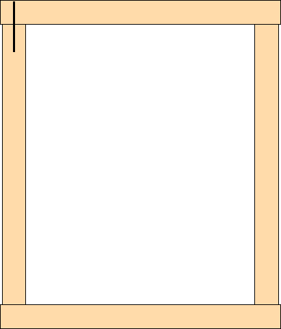

For MDF, I first assemble the 4 sides using yellow glue and pin nails or staples every 3 inches, leaving a small overhang as illustrated. After the glue is dry I trim off the overhang with a router. I then add the top and bottom in the same manner. If you are going to roundover, be careful where you place the fasteners - you don't want your roundover bit cutting into them! You could make a 4'x4' cube this way and it would be plenty strong. If you use a stapler you need a good one and about 110# of air to drive a 1 1/2 inch staple into MDF.
BTW, there is no such thing as a wood to wood bond: it's always glue between two pieces of wood. The glue joint is stronger than the wood itself.
