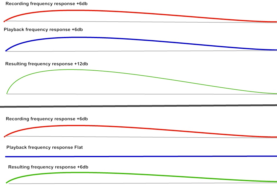

Maybe a picture will help... (See below)...
If you record something with +6db of bass boost (which is not uncommon) and then play it back with +6db of bass boost on your system... how much bass boost does that give you?
Correct, it gives you 12db ... which is NOT how it was intended.
Now if you play it back with a flat response, 0db of boost... what do you get?
Correct, you get the 6db from the source recording as it was intended.
Get it now?

6dB plus 6dB equals 9dB.

Robwells could you elaborate on +6+6db=9db as i don't follow you... edit:are you comparing Voltage and radiated power? If that is the case they don't follow same rules and shoudn't be mixed together as they are different 'things' ( voltage being 20log, radiated power 10log) but using same units (db) . In that case please specify by using dbspl and dbu,V or v to avoid confusion).
Joined 2009
Ok reread my edit on last post ;).
Doubling the radiated power is equal to +3db spl ( going from one to 2 watts for example). Doubling the voltage equal +6dbu ( doubling of voltage).
I don't know what your calculator does but for me it is nonsense. ;)
