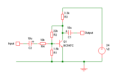

Hi ! in the meantime a kind but straight question
Does a transistor have an optimum point of work ?

A transistor in isolation? No.
A transistor in a particular circuit, with particular DC voltages and signal voltages and sources and loads? Yes, maybe. Finding it is called 'design'.
People may try to tell you that a 2N12344 always works best at 8.1342mA. This is a signal that you can ignore what they tell you.
Once again, don't keep looking for simple answers to complex questions. How long is a piece of string?

Ok but just one last question about linearity
What is the widely accepted test to assess the linearity of a circuit ?
is it the distortion test ?
Can we say that if a circuit has a high distortion is not linear ?

Linearity (or lack of it) is a circuit property. Distortion is the result of what non-linearity does to a signal. It can be measured by looking for harmonics or intermodulation. Distortion (almost) always varies with signal level, so a useful distortion measurement includes more than one signal level. Distortion often, but not always, increases with larger signals.
Frequency response is something different. It is caused by filters, intended or unavoidable. Both filtering and non-linearity can change the shape of a waveform, but on the latter causes distortion. People sometimes find this confusing, and claim that a filter has 'distorted' a signal. At some point in the ensuing discussion it usually emerges that they either don't understand, or don't believe, Fourier theory.
All of this is standard textbook stuff.
