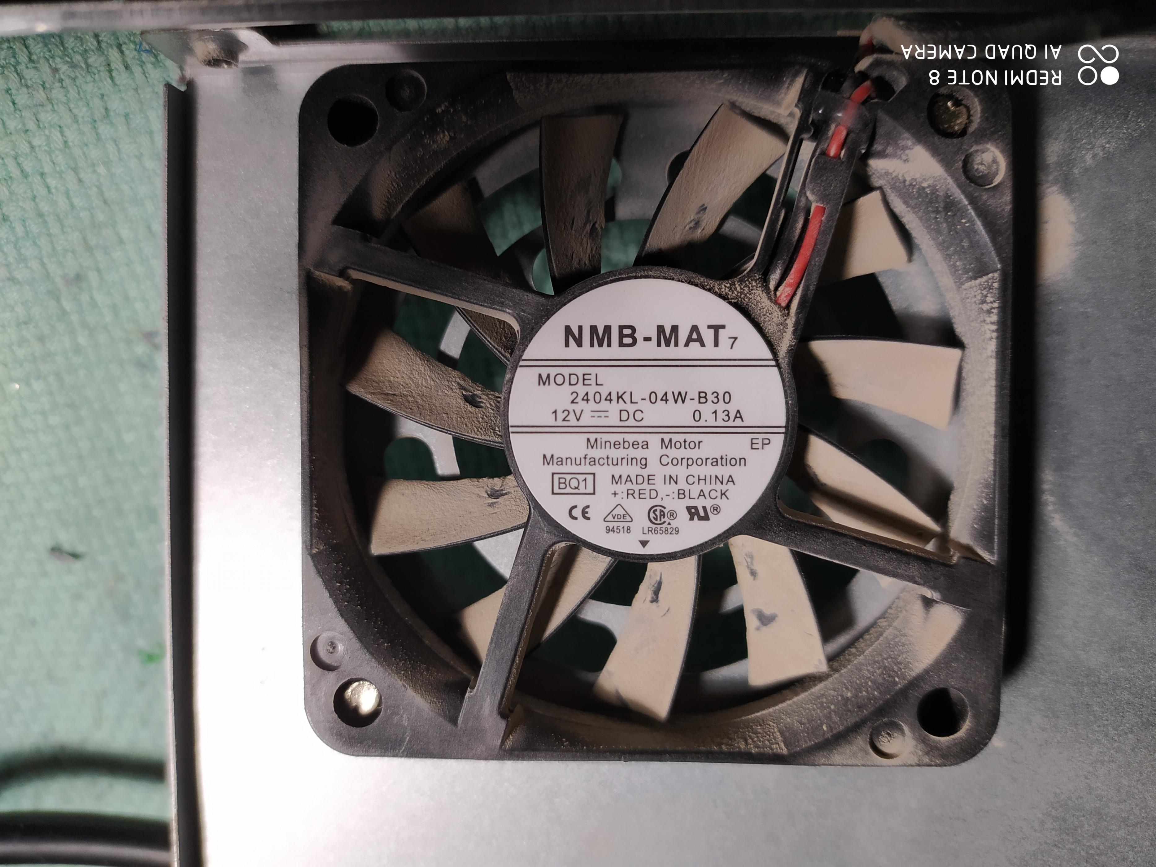

The easiest solution, if not the cheapest, would be to replace the power supply with a different, lower current Meanwell with an open, mesh type top surface. These have no fans ... If you need the 350, the only workable solution would be to open the case and disable or remove the existing very loud fan, ...

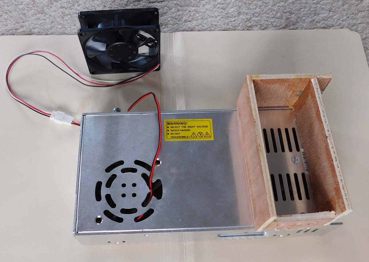

Another idea, that I used a few years back is to remove the fan and use a single larger fan for the case + power supply cooling. This pic is for a Meanwell 36VDC 350W PS ... My current project uses a similar strategy (one intake, one exhaust) now but I'm using an open mesh PS design described by ^@tubesguy.

I could take out as you say the upper lid and mount the psu inside the pc box and put a very good fan above the psu inside the box

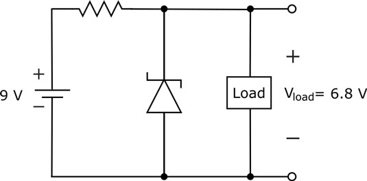

Hi thanks but sorry i am ignorant. You say that if i put a 6V zener on the positive wire in series with the fan it gets only 6V ? just that ?
Speaking of zeners i know that they are used very commonly as voltage regulator is a slightly more complex schema
This is what I was referring to.... I've used it many times to tame fan noise.

The easiest solution is to remove that tiny 60 mm fan, and install a 120 mm fan, like this:
SILENT WINGS 3 | 120mm silent high-end Fans from be quiet!
Then it can be run from lower voltage. A series resistor of suitable wattage could do.

Hi ! thanks a lot for the valuable advice. I guess that to accomodate a bigger fan a bigger enclosure is needed. This smps is quite long in size.
Hi thanks a lot. I would prefer to have some kind of control on the fan speed with a pot maybe ? i should do some tests with different voltages.

Hi ! thanks and yes ! but i have to change the enclosure
Actually now that i think better i could drill some big holes in the upper lid and mount a bigger fan externally on the lid. I will be a little exposed to dust and bumps but it should work quite ok.
