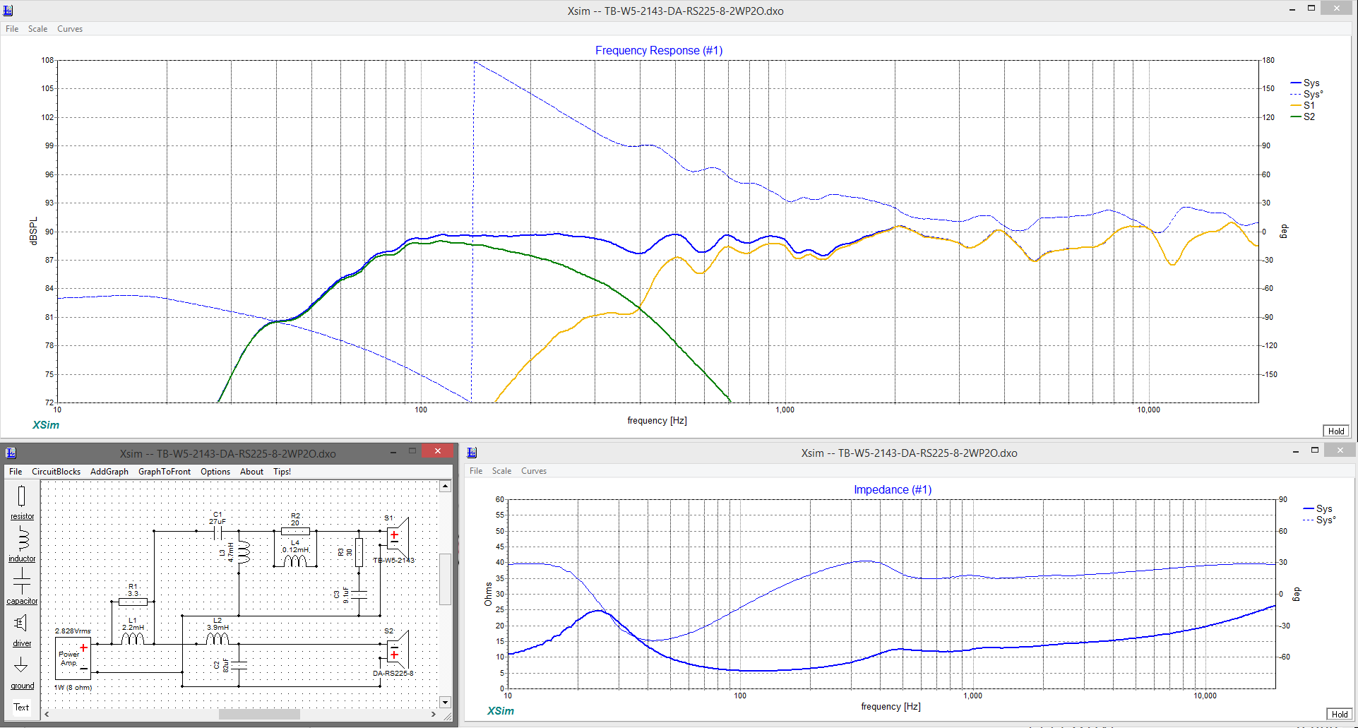

I would crossover lower, but that combo does work. I did do a prestudy for a crossover network for a friend with that combo and came to this... This is done on raw measured drivers by the owner and was mainly for having an id what it would become before he started to build the cabinets. So use this only as starting point and at your own risk (i did not build this or tested this).
