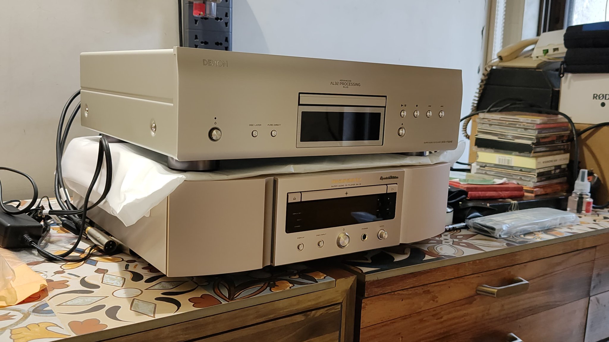

For the first time in my life, I had the following things set up in my bedroom:
I first bought one CD player. (Let's call it Player A.) I found it to be super-clean in sound, but I noticed that my brain was reacting to it by losing concentration -- I'd start one track, listen for a minute, and my mind would stray. And in objective terms, there seemed to be an etched quality, an edge, to the sound. I did not think much about it, and attributed it to the CD's mixing/mastering, and/or the earphones.
Then, due to a strange mix of circumstances (I was buying for my friend) I bought a second CD player (Player B), thinking I'll sell one anyway. I've never had the funds or the reason to do this before, in my life. And when I heard both in quick succession, the sound difference was quite remarkable. With the second player, gone was the edge, though I could hear full details. In fact, I could hear more detail now. And gone was my tendency to lose concentration. I was using exactly the same cables, headphone amp, and earphones.
I know that comparisons need level matching. So I went one step beyond level matching -- I tried to actively change the gain up and down while listening to one player, while keeping the gain unchanged when listening to the other player. The subjective impressions remained unchanged -- Player B sounded better, even when I made Player A sound louder, or softer.
I called my 18-year-old to listen. He's not interested in audio gear, but loves music, plays the piano, and has ears 42 years younger than me. I told him I'm hearing differences, and asked him to try the two players out. He used the HD650 (he diesn't like in-ears) and he played a CD he loves, which I had not used for my listening. It was "Retrospectacle" by Supertramp. He listened to just 1-2 tracks and said he can hear a difference. His exact words were "The second one is softer, but I like it more." I had not told him which was worse or better to my ears, but his identification of the "second one" matched mine.
Then I switched from the Atom Amp 2 to the RME ADI2 FS Pro, which, as you know is a complex piece of gear, and does A2D and then D2A before driving the headphones. I was not sure it would be accurate enough to let the differences come through, but it did. I could hear the same difference through it too.

- two expensive CD players, in the $2,000-5,000 range
