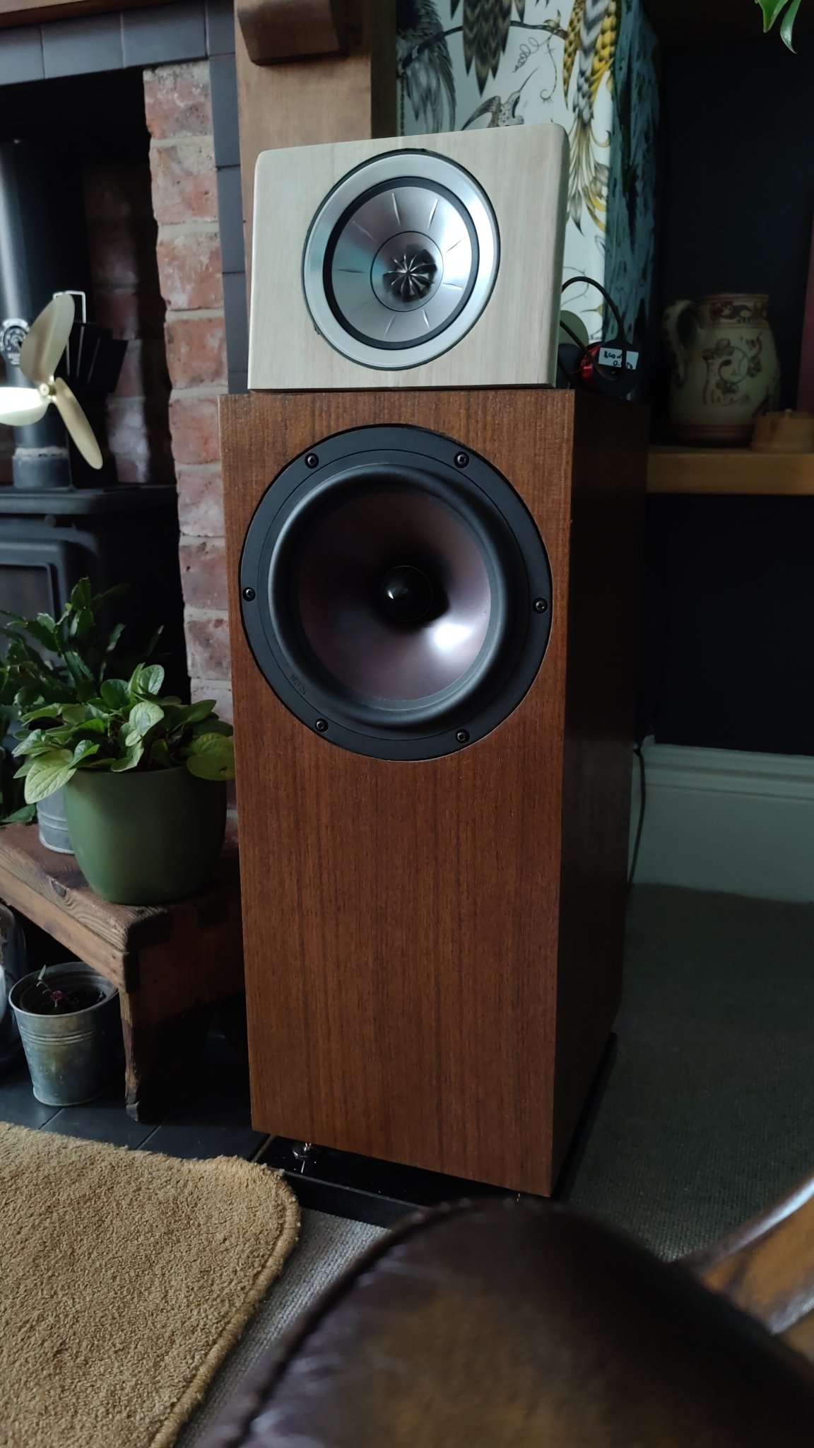

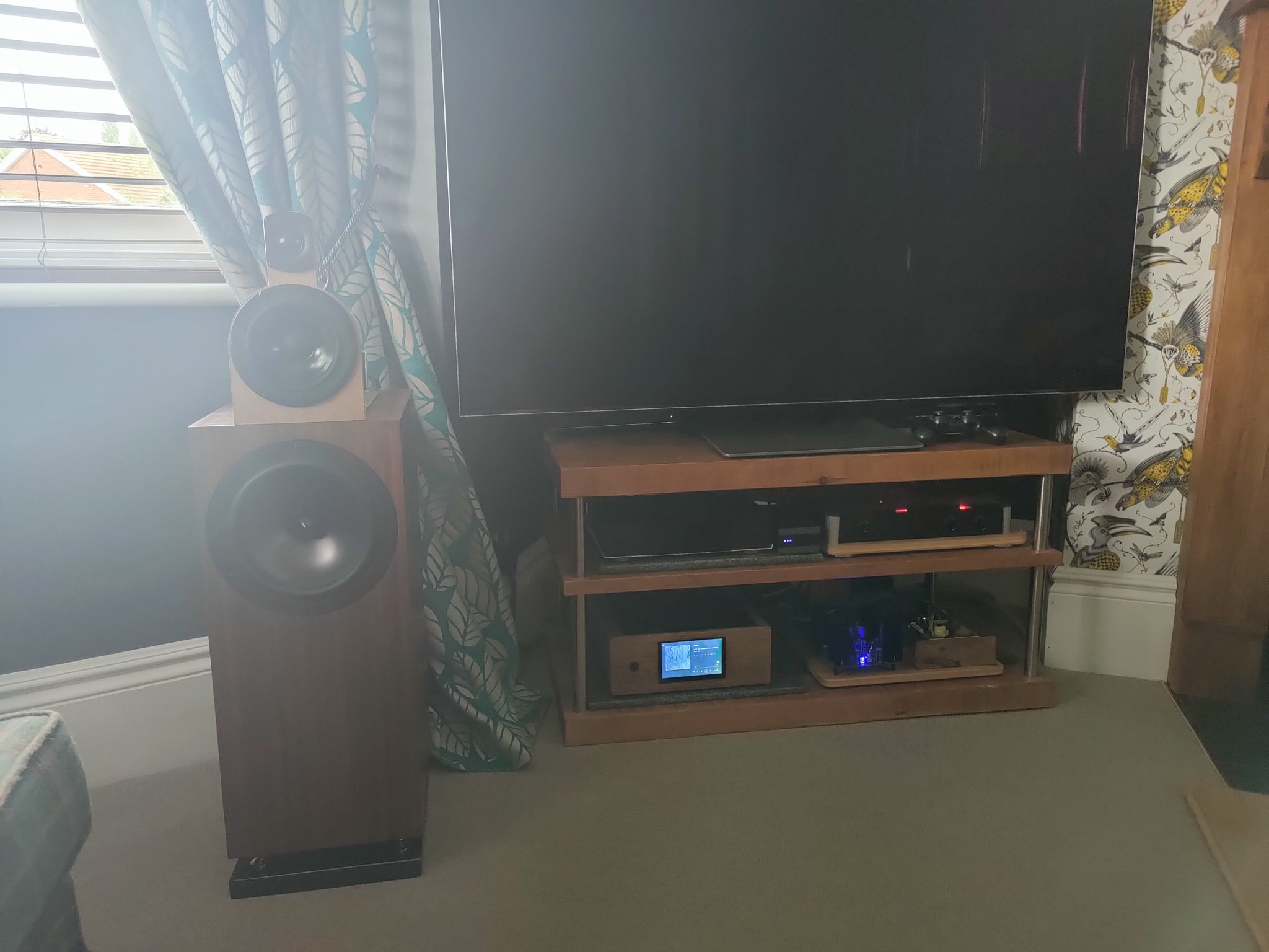

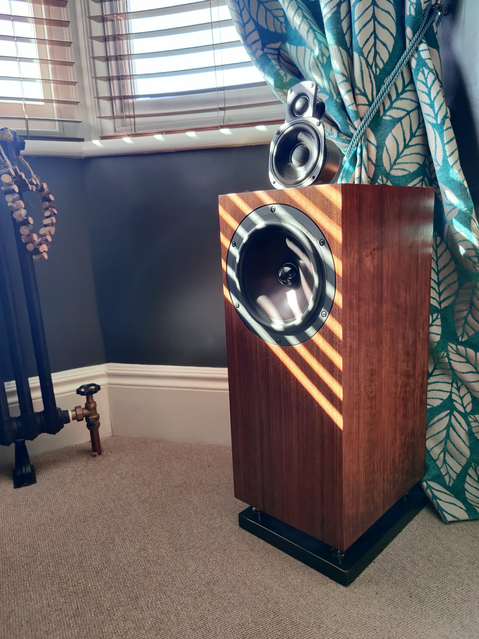

Looking forward to the progress of this project with the RS225s. I use them in a 2 way and a 3way. Currently in 28litre BR with Kef R coaxial on top in OB.
Have had MCA15 on top as well with 2 back to back Vifa BC25s. Also had a 'sort of MCA12' ( Seas drivers out of a Monitor Audio centre speaker!).
I have the SB17NBAC here too. I had them in a 2 way but the whole project lacked a little something. Would be interesting to see what they do as a mid in a 3 way. I ought to try them again.
Have read all this thread and the knowledge and experience that you guys possess is infectious. Keep it up.

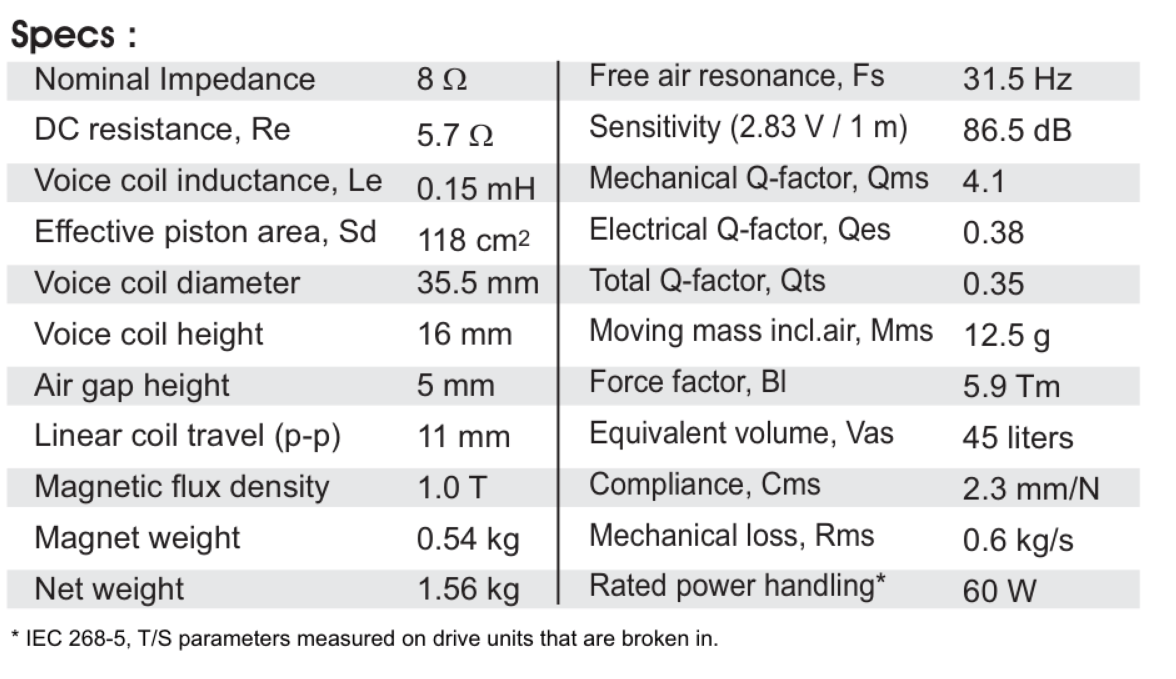

The motor used in the SB17N(B)AC and possibly other SB17 drivers is not very linear above about 2.5mm excursion from memory. This was from a Klippel measurement, maybe one of Vance's. It could explain why as a bass transducer, the quality isn't that good when playing loud or low.
I recently used the SB17NBAC 8ohm version in a 2-way speaker. It was a sealed box. I thought the quality of the bass was pretty good... tight, articulate... Of course it would stumble at higher SPL, you can only ask a 6" sealed box driver for a moderate amount of bass before the excursion starts to hit the limits.
I never tried to use it in a vented box, and I don't think it would be a good driver for that. The spec Qts is on the high side for BR, and my measured Qts was even higher.
