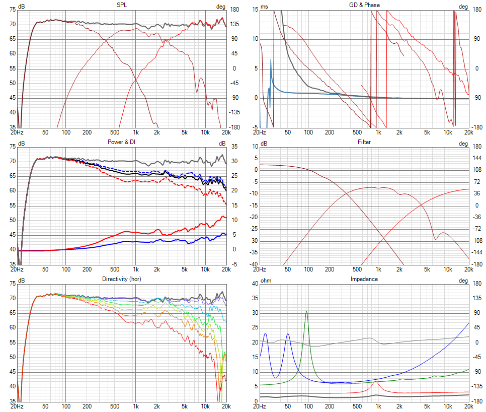

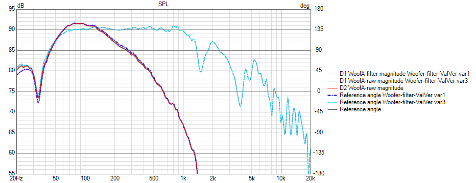

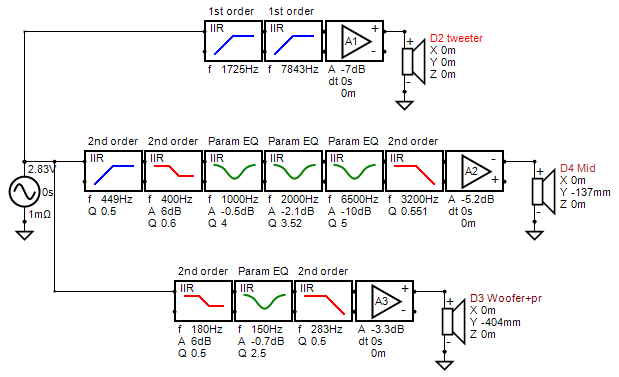

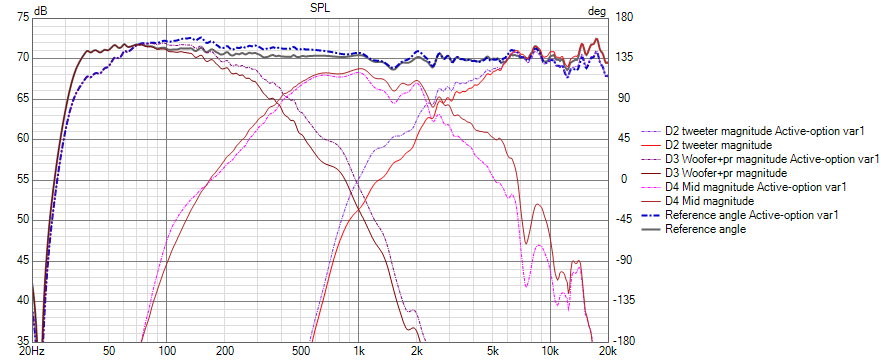

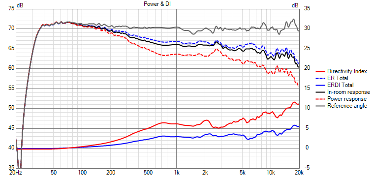

On the subject of active systems... If I were going to apply active DSP 3-channel amplification to this project, this is the filter I would start with.
Comparing this to the as-built passive crossover is interesting, and it shows how the increase in control can lead to a higher performance.
Dashed line is the passive
Notice how the passive low pass filter on the woofer boosts the signal from 80 - 200 Hz. I think this is responsible for the warm character of the speaker. An active filter does not interact with the woofer impedance, so the filter acts in a more idealized way without the extra gain.
An active filter allows me to tame the 2k peak in a very precise way. This allows the whole balance of the midrange driver to be different, and I am able to optimize the PIR response a bit better.
As I said, if this were an active speaker, this is the filter I would start with to do the subjective voicing process. ....... j.

@hifijim As you mentioned, you used some PEQ on the midrange to attenuate its peak at 2kHz by 2.1dB. Did you consider boosting the frequency response at about 1.5kHz by about 1.5–2.0dB instead? Looking at the response curve of the midrange, this would have smoothed out that region quite considerably. I guess some attenuation at 2kHz might still have been needed, but it might have been expected to be less than 2.1dB.
The rise in the passive system's woofer output in the 80–200 Hz region seems to be a very common occurrence when using a passive filter on the woofer with a relatively low cut-off frequency, something that is typical of a 3-way loudspeaker system. It looks like it is some sort of series resonance circuit created by the capacitive behaviour associated with the reducing woofer impedance with increasing frequency in that region, interacting with the combination of the series filter inductor and the voice-coil resistance.
Hi, this has been a thoroughly interesting project, thanks for sharing. Can you explain for me why you have cascaded the two high pass filters on the tweeter circuit?
The acoustic slopes on the midrange and tweeter drivers through the crossover region are quite shallow. The resulting midrange/tweeter crossover region seems to be quite wide as a result. I'd be interested to know more about why such a design choice was made. Was it to try and get a more constant directivity through that frequency region?
I tried a lot of different EQ strategies, including that one. The 2k peak is caused by a well damped resonance, so it seemed more intuitively correct to cut the peak rather than raise everything else up to the level of the peak.Did you consider boosting the frequency response at about 1.5kHz by about 1.5–2.0dB instead?
Yes, I talked about this in post #422 https://www.diyaudio.com/community/...ivers-a-new-3-way-project.413182/post-7775930The rise in the passive system's woofer output in the 80–200 Hz region seems to be a very common occurrence when using a passive filter on the woofer with a relatively low cut-off frequency, something that is typical of a 3-way loudspeaker system.
In post #428 I showed this plot. This is the measured near field response of the raw driver (light blue dashed line) and the measured near field response of the woofer with filter. You can see the 1.6 dB gain from 60 -120 Hz.
As you say, almost all 3-way filters will have this sort of issue. The only way around it is an impedance compensation network, and any such network in the 50 Hz range is going to require massive inductors and caps. It is just not practical.
I was trying to mimic the transfer function of the passive filter, but moving the crossover frequency up closer to 3k. Someone on this forum (I think it was @fluid) advised me that waveguide tweeters often respond well with a first order filter at a high Fc, and I have found this to be generally true. The first order filter counteracts the natural 6 dB/octave rise in output as the frequency drops, and then combines with the natural rolloff of the tweeter to give a combined 2nd order acoustic rolloff. The second lower 1780 Hz first order simply maintains the desired response down to 500 Hz. With real world drivers in a real world baffle, I don't expect the filter network to be idealized or mathematically derived. It is simply a collection of compromises which work well enough.Can you explain for me why you have cascaded the two high pass filters on the tweeter circuit?

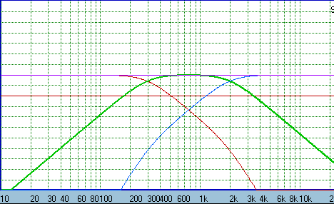

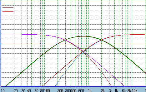

"The first order filter counteracts the natural 6 dB/octave rise in output as the frequency drops, and then combines with the natural rolloff of the tweeter to give a combined 2nd order acoustic rolloff. The second lower 1780 Hz first order simply maintains the desired response down to 500 Hz. With real world drivers in a real world baffle, I don't expect the filter network to be idealized or mathematically derived. "
Yes, this is the nicest thing with dsp. Loudspeaker's output is acoustical and the acoustic response is what we are modifying to match, with far more liberties than passive cirquits can. Of course we can make hybrids with coils and caps to eg. provide protection for the tweeter (pops occur at startup). Low order xo requires good slopes far beyond nominal Fx
I have noticed that with 3-4 way speakers slopes come rather naturally to 2nd order Duelund type (elliptic slopes), like this case of hifijim's.
https://musicanddesign.speakerdesign.net/Duelund_and_Beyond.html
2nd order Duelund
Modified 4th order

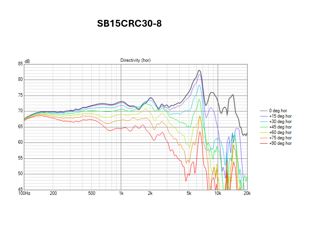

Regarding the SB15CRC30-8 midwoofer.
Several people cautioned me about using this driver as a midrange, particularly @wolf_teeth . Now that this project is nearing completion, I can say that this driver is a challenging driver to use effectively, especially in a passive network.

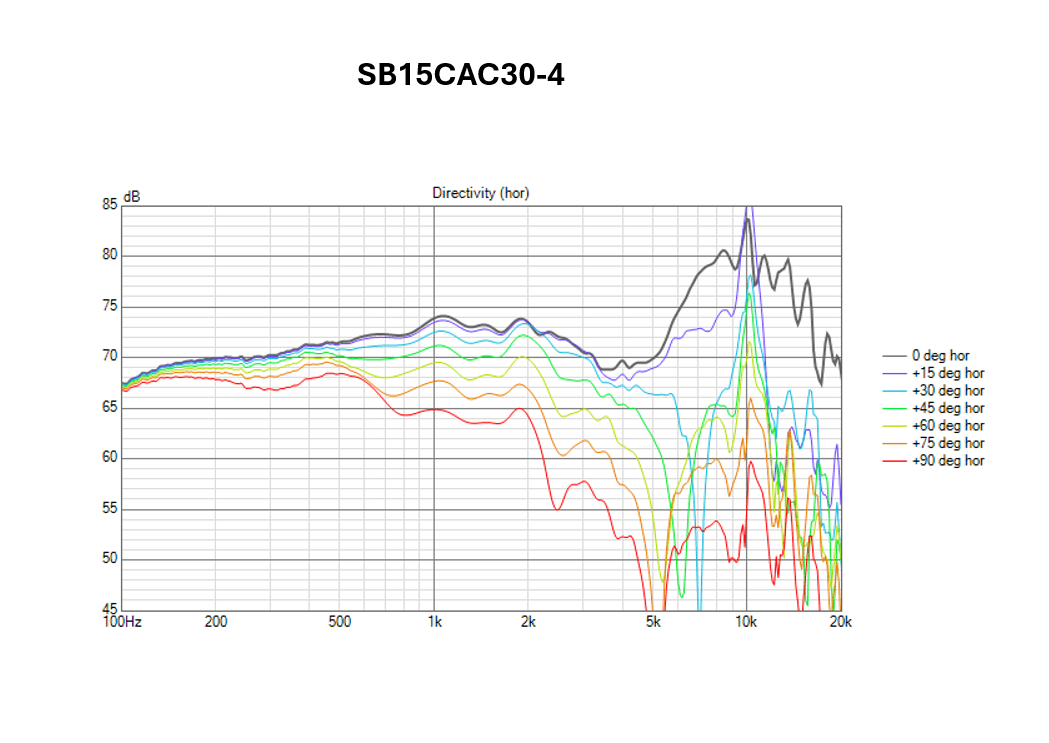

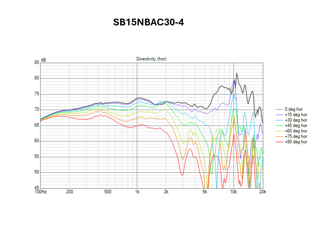

For comparison, I will show the 0-90 degree polar response of the SB15CRC, the SB15NBAC, and the SB15CAC. These are all gated far field measurements merged with near field scans. Each driver was measured in a cabinet, and all three cabinets are different, so the baffle step will be different and the higher frequency diffraction effects will be different. Regardless, I think it will be obvious why the SB15CRC is a more challenging driver than the other two. The first breakup mode on the SB15CRC is a half octave closer to the typical crossover frequency of 2.5k – 3.5k compared to the other two.
I have no regrets about using this driver. Part of the goal of this project was to learn about and use new drivers. And the fact that it was challenging means I learned something.

Some people assert that measurements won't tell you the difference between cone materials.
You can only listen with your ears... etc
Clearly @hifijim can.
Thank you for unwinding, even if just a little bit, the mysteries of different cone materials...

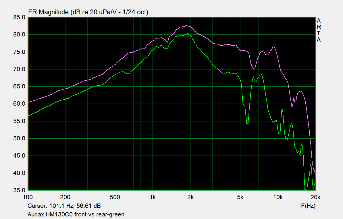

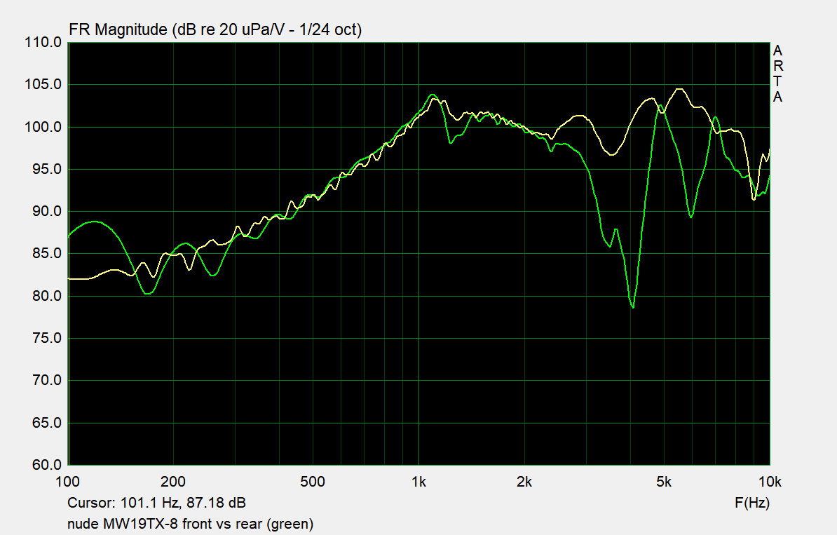

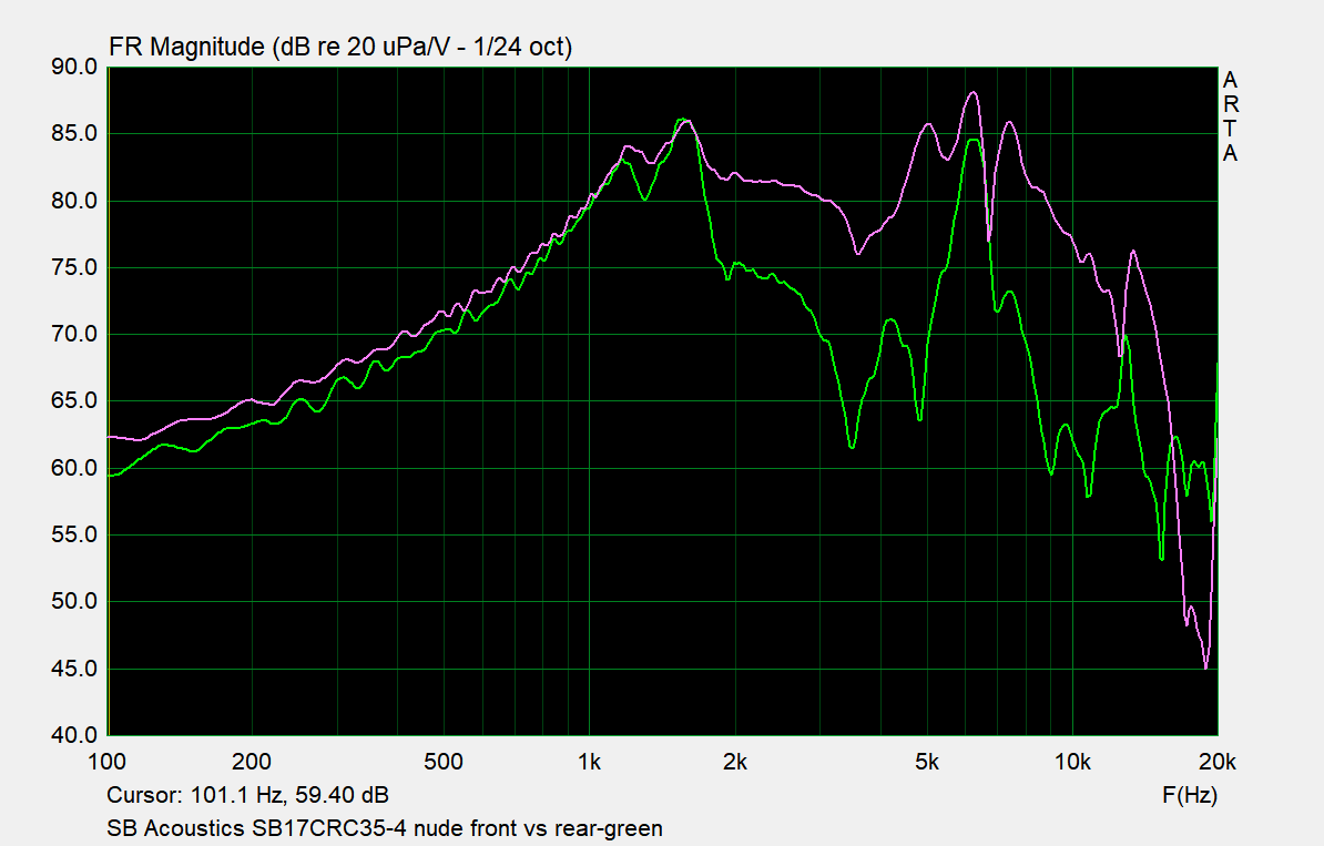

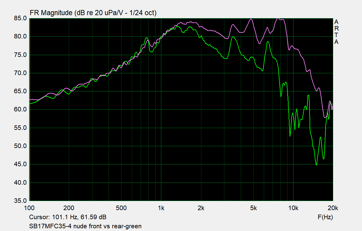

My projects aim to have a dipole radiation characteristic, so I look for drivers with as similar a front and back radiation pattern as possible. There was a "quick" measurement I would perform, where I would use a panel of that 1x1 vinyl coated steel wire material that was formed into a shape looking like this: "∩" that was about 1.5m tall and 50cm wide. The curve of the ∩ was gentle enough so that I could just rest a driver on it and it would stay in place, and as a driver support it is acoustically transparent. I would take an on-axis measurement at around 16-20 inches away and then rotate the driver by 180 deg and do the same from the rear. I could then immediately compare the two responses in my measurement software.
Here is that measurement for a couple of the SB17 family drivers, the CRC and MFC version. I also threw in another standout, the Audax HM130C0. Oops and here is the Textreme cone MW19TX that has very good matching of front vs rear output. It's a little on the large size for use up to 2kHz due to beaming, but you will get a very nice dipole pattern from it. I use it in a project and hope to again. It's much more expensive than the other drivers shown.
I was searching for a nude midrange for my project and could not cross over below 2kHz. A little higher would be even better and would put less strain on the tweeter. The MFC version was best in this regard and of the tens of drivers I tested was a great combination of smooth and extended response as a "nude" driver. It's quite affordable and has decent performance all around (e.g. distortion). The Audax has a smoother FR but the distortion, especially IM distortion, was definitely worse. It's another good option and a cool looking and well built driver, just with an older motor design. I was very happy with the MW19TX and being a bit larger it could also be used to a lower frequency compared to smaller drivers (that start to have too much dipole cancellation as high as 600-700Hz for the 130mm Audax).
As soon as you put the driver into any sort of baffle, the response around 2kHz and other places will change. If you are making a PAP-style or any large planar OB speaker, then your needs for a driver are different. This is really only important when you are using the midrange nude, or in a very minimal baffle. It's my particular niche interest in DIY loudspeakers I guess...
