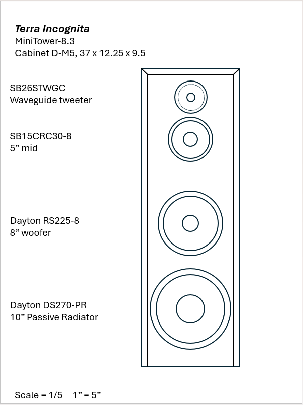

Some Interesting Drivers, a New 3-way Project
