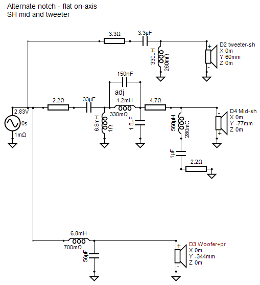

For whatever reason, the amp-side R was dissapating about 4x as much heat as the two driver-side Rs in this particular layout. But you got me thinking about this a little more, and I have tried a combination of amp side and driver side R and it works better.The amp side resistor won't waste any more power than a resistor after. It's highpassed, so it won't dissipate the full bandwidth.
Thanks for this suggestion. I could not get the "series cap and coil, then shunt cap and coil" to work out. Cascading the tweeter after the mid high pass is interesting, and I was able to get a good result. I am not sure it is better, but it is nice to have this as an option.Have you thought about the other midrange layout? Series cap and coil, then shunt cap and coil? Some people prefer this. I have a feeling cascading the tweeter and its filter after the midrange highpass could also be beneficial.
A tanking cap across the lowpass coil (when used by itself) introduces a sharp high-Q notch that is very deep, in the range of -40 dB. However, because it is high Q, it does not have a broad range. This mid driver needs a more shallow Q notch, something that suppresses from 6k to 12k+. This is why I originally used a parallel notch in series with the driver.I also find that breakup peaks are easier to kill off with a combo of tank-cap across the lowpass coil, and then the LC across the driver. Same parts count as you have currently, and you still add resistance at breakup.
You seem to be advising something here
and I am not sure what you are getting at by "LC across the driver". Could you describe this in more detail?tank-cap across the lowpass coil, and then the LC across the driver.
Again, thanks! Your suggestions are making me think about things in a different way, which is helpfull.
j.
The tank cap across the series coil can have a series resistor with it alone to shape the response as well. This essentially makes a parallel notch with the coil and cap. Essentially, connect leads in a triangle, and the in and out on the coil leads. Usually this is a broad-range filter, from coil cutoff to upper treble. This is because there is bleed through in the top octave that increases the larger the cap gets. This can also cause low impedance drops in the upper treble because the impedance comes back down in the upper treble. Normally I have seen and used nothing larger than 1.5uF here, smaller the better, and the series R keeps the impedance benign.
An LC or bottomless trap (or pit, because of how it works) across the driver of an L and C in series, or series notch, though sometimes an additional R is added, is more capable of breakup and energy storage suppression not unlike flushing the frequency range down the toilet.
In my experience, sometimes a parallel notch like you have on the midrange will not even touch a bad resonance, and it takes the shunt/trap/series notch to actually kill the issue.
The LC across the driver looks like a short in impedance, save for the coil resistance or added R. If you have a lowpass ahead of it, or a series resistor, then this short is compensated as the amp sees it, but still is very effective at its job. However, it should be noted that without the voltage divider out front of either type, that the LC shunt will not affect the freq response.
It should also be stated here that the Purifi document about reducing HD by using a parallel notch placed in series with the driver calls it a series notch. Most electrical textbooks will be at odds with this classification, calling the circuit as they are arranged; parts in parallel = parallel, and in a string = series; no matter a transducers relation to the circuit.

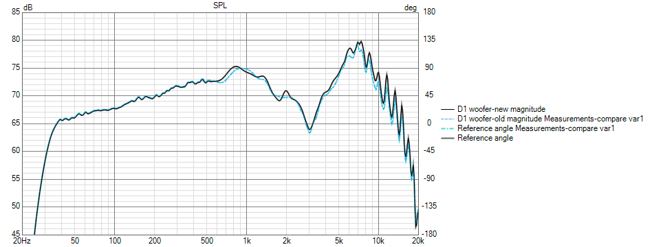

When I selected this driver based on the prototype testing, I considered the 2 dB wiggle in the response between 1.5k – 3k to be minor. Now looking at the response in the full cabinet, it is a 3 dB wiggle, and to me it seems no longer minor. It now seems like something I will have to design around.
Looking at the inCab Frequency Response there is a dip at ~1600Hz and a peek at about 2100Hz.
I am thinking about what I call Tsunami Effect, the trough of the wave comes on shore before the crest of the wave.
Seems to me that passive filter equalization may not do so well at attempting to remove a resonance.
In testing, so far the driver has been held constant but the prototype enclosure has changed to the new modified "finished" version.
I suggest just for A x B testing that the driver be changed out with the aluminum sb15nbac30-8 driver. It will drop in the enclosure cut out. Same everything except the cone and dust cover material. The A x B testing holds the enclosure constant while the driver variable is changed.

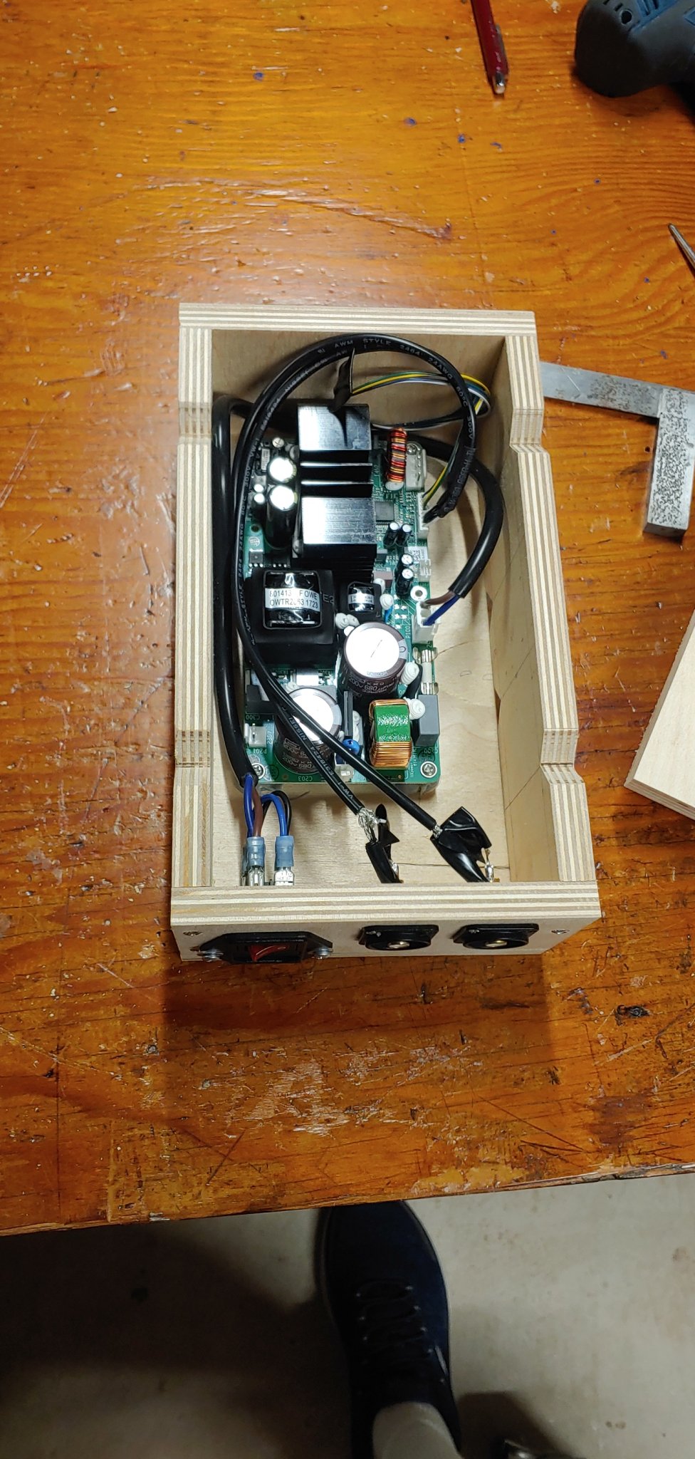

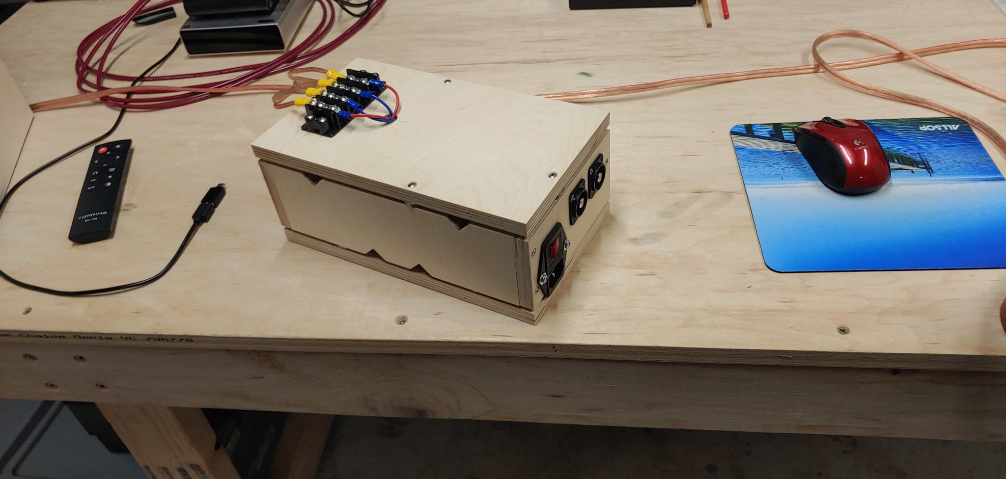

New measurement amplifier. IcePower 125ASX2.
The V-notches on the side panel are for ventilation, but after running it for a few hours, I decided I need more ventilation. So I added spacers on the top and bottom panel to create a 4 mm gap around the whole perimeter. Now there is plenty of air flow.
Well that was optimistic... more like 5 hours and 45 minutes. I am happy with the result though...
I already have the necessary connectors, fuse holders, switch, and power cord. I can zip together a case in about 45 minutes.

In the following plots, the solid line is the current on-axis scan with the 5.5 ms time window and the new amp. The dashed line is the older on-axis scan with the 3.3 ms time window and the older amp. The difference in high frequency response is clear to see, even with the woofer. With the tweeter, the difference is substantial.
Woofer
Midrange
Tweeter

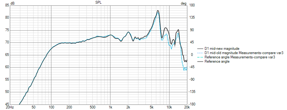

I need to clarify the plots in the previous post #390. I was in a hurry to get to lunch and I posted too quickly...
These plots are far field gated measurements merged with near field measurements. The near field part did not change, only the far field measurements were re-scanned. In the "old" dashed line plots, the merge frequency was about 700 Hz for woofer, mid, and tweeter. In the "new" solid line plots, the merge frequency was about 500 Hz for woofer and mid, and 700 Hz for the tweeter.

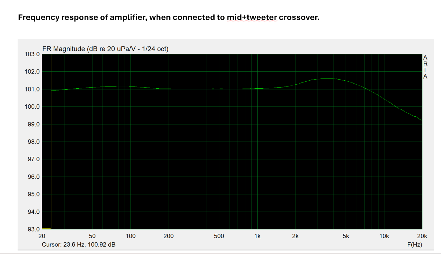

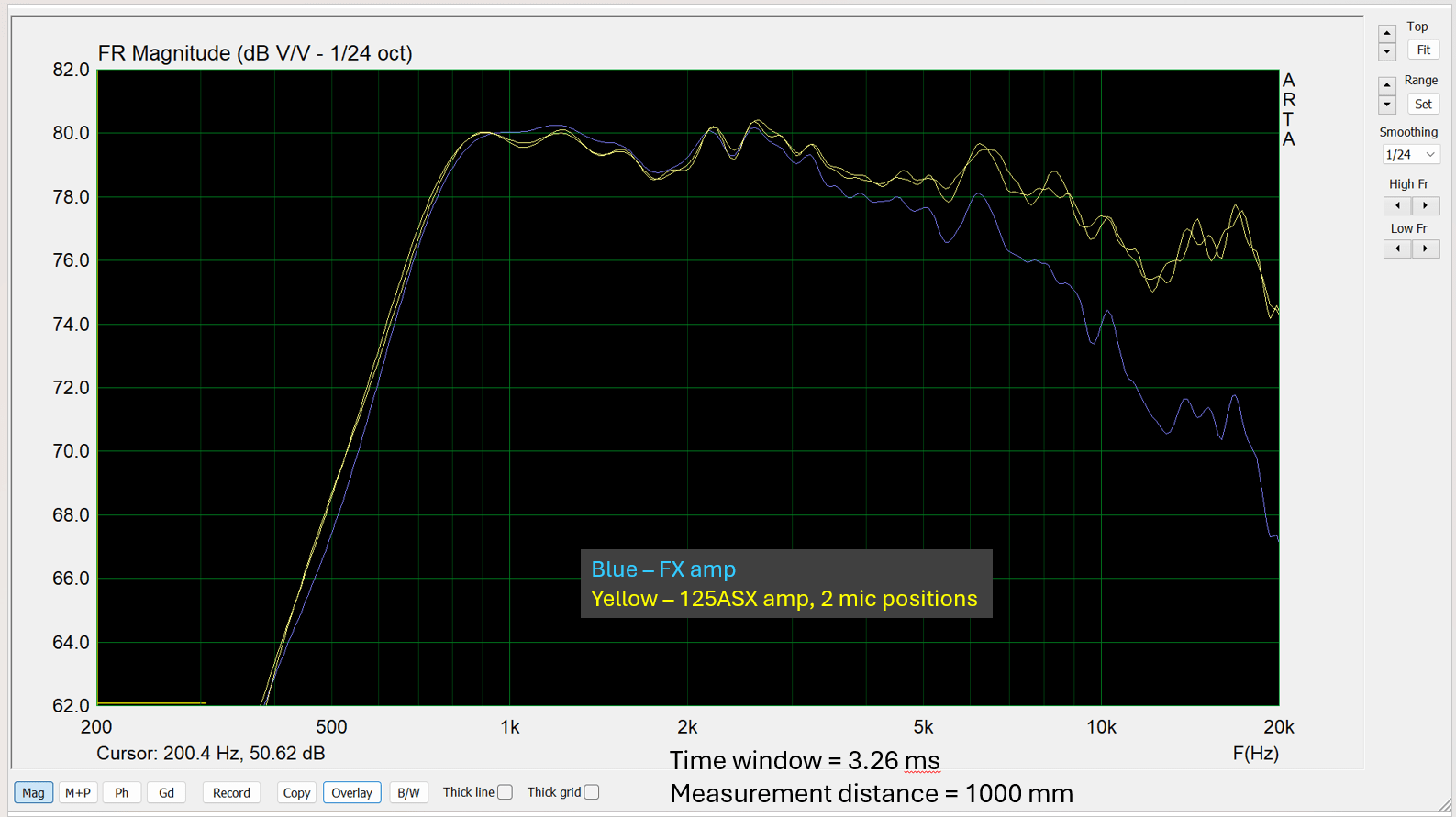

Perhaps I should have been more clear. Referring to the plots in post #390, the solid line is a frequency response scan, on axis, distance of 1 m, made with the new ICEpower amp. The dashed line is a FR scan, on axis, distance of 1 m, made with the old FX-audio amp. This old amp uses the TDA7498E chipset.I am very confused about the difference above 5kHz.
In a previous project, I measured the frequency response of the FX-audio amp while connected to a midrange + tweeter + crossover filter. This is a different set of drivers than what we are discussing in this thread, but this data illustrates the issue with this amp.
In yet another earlier project I measured an even larger frequency response deviation when the amp was connected to a tweeter with no filter network. At that time I did not understand what was going on, and I thought I had a broken microphone.
In this case, with the SB26STWGC-4 tweeter and no filter elements, I am seeing the largest frequency response deviation I have yet measured with this amp. The FX-audio amp is -1 dB at 5k, -2.5 dB at 10k, -4 dB at 12.5k, as shown in post #390.
Here is another way of looking at the tweeter data shown in #390. I imported the on-axis impulse responses into ARTA, and used a consistent time window of 3.26 ms. The blue line used the FX-audio amp. The two yellow lines used the ICEpower amp, with two slightly different microphone positions. Note that the y-axis is expanded to 2 dB/division.
Why two mic positions? After I made the polar response scans of the mid and tweeter, I wanted to get a longer time window, so I elevated the speaker as high as practical, and made a second set of polar scans. After reviewing the data, I discovered both sets of data had approximately the same reflection-free time delta, so the two sets are equivalent. However, they do show a slightly different tweeter response, particularly in diffraction effects. I have noticed that when waveguide tweeters are measured on-axis, they are very sensitive to small positional changes of the microphone. I first discovered this with the Satori TW29BNWG, and it drove me crazy for about a week...
So bottom line, if the FX-audio amp is used above 5k, it needs a calibration curve.
j.
It needs a calibration curve for every new change in load impedance ... which makes it very annoying as a piece of test equipment...So bottom line, if the FX-audio amp is used above 5k, it needs a calibration curve.

That is a rather poorly designed amplifier, even for a simple Class-D
Personally, I would recommend getting a proper Class-AB amplifier.
Ideally one of those flavored composite amplifiers.
In that case you know for sure that you won't bump into those kinda issues anymore.
Even a simple 2nd hand receiver or so won't have these kind of issues.
I personally wouldn't even recommend that IcePower amplifier.
I have worked with those in the past, and they also have all kinds of funky stuff going on.

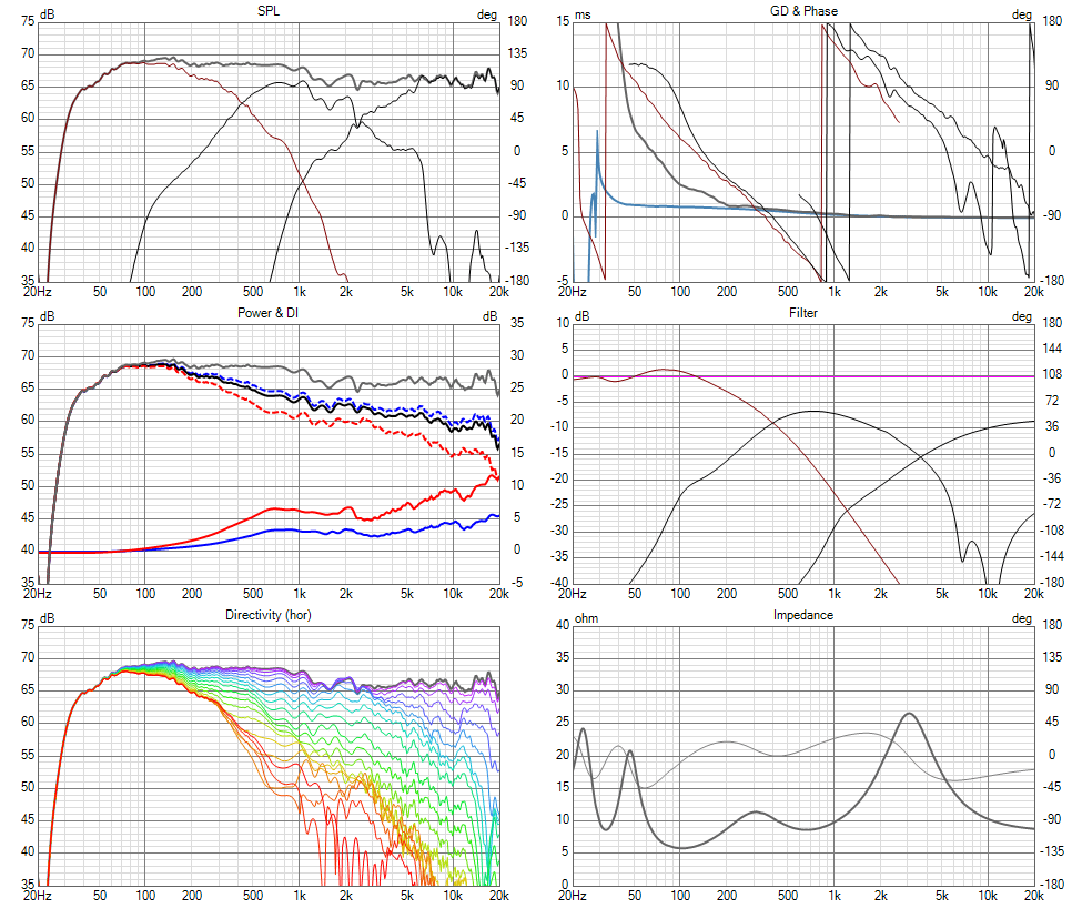

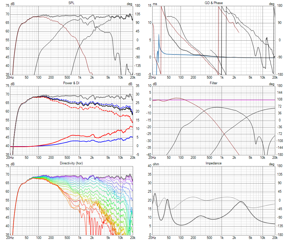

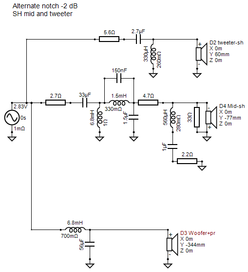

Here is an interesting crossover design, using the latest measured driver responses. This layout incorporates the alternate notch filter that @wolf_teeth recommended. I show two versions, one which is nearly flat on axis, the other which is sloped down by about -2 dB. My experience is that the second one will be close to the final subjective voicing.
Now the -2dB sloped response:
My one thought is that the upper rolloff of the midrange has a shelved look. Where the breakup is at about 5-6k may not be attenuated enough. It only shows at -10dB from nominal, and -40 or better is preferred.
