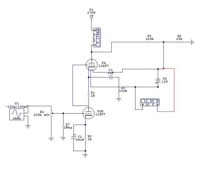

in last image (just now I realize that's almost same as "Anzai " line stage from Elector .....) you need 10UF across R6 (47K-lower resistor in divider)

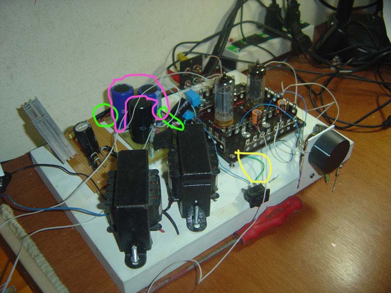

like EC sez-twist wires for heater
route all DC paths away of AC lines ad ,if you must cross DC and AC lines,do that in 90^o angle........
have you enough capacity in main DC supply?
Yes! I have some 330uf on the DC Supply. I think this is enoght.
EC8010, I didn't wired the heater with a twisted pair. What is the difference in using a Twisted pair or not using a Twisted pair?

Tightly twisting the wire makes the stray magnetic fields cancel. If your heater wiring isn't twisted, then it could well be the cause of your hum. The only way you can say for certain what's causing hum is to cure it, then you know what the cause was. Without having it right in front of me to peer at it from all directions, probe it with an oscilloscope, and listen, it's hard to make predictions.
A new photo.

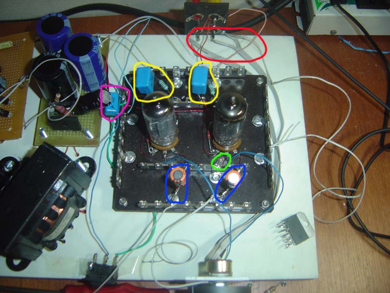

In Rose - The decoupling cap with 0.47uf 400v rating
In Yellow - The C1 and R3
In Blue - The R2 and C2
In Green - R7 - I put the 1meg resistor in only one channel to see the difference in the Headphone
In Red - The IDE cable who I used to conect the INPUT to the Potentiometer.

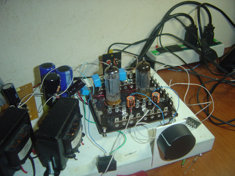

In this photo you can see better the WIRE who I have putted underground the board. This wire is B+

choky said:
you still need 10UF cap across R6
but-first-try to move these xformers at least 20 cm further

Choky,
In here I have a 47uf 200v capacitor across the R6. You can see this capacitor. The black capacitor with a FJ.
I willl move this Xformers, but now I haven't solder :x Tomorrow I will buy more solder and make this.
