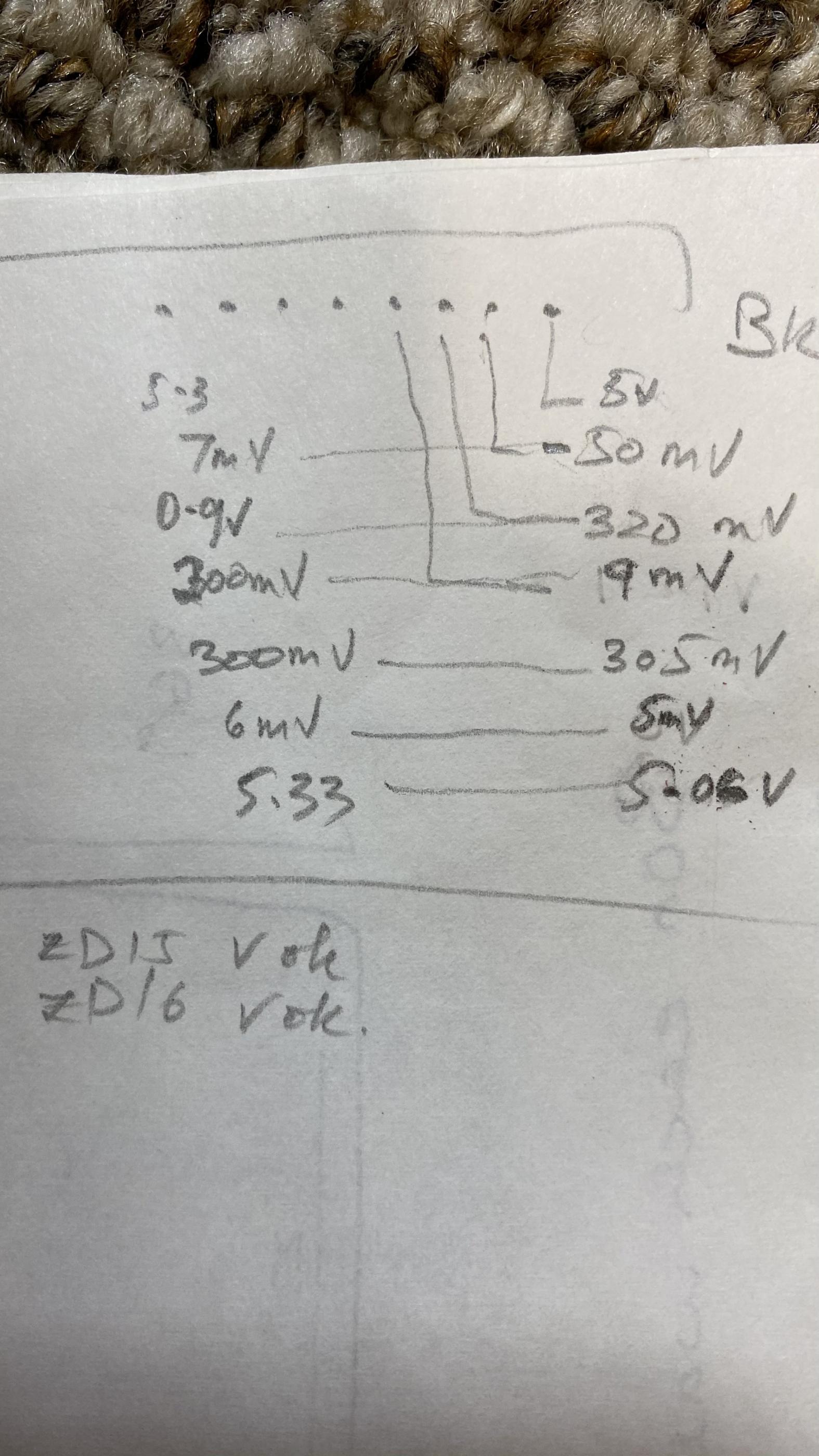

Got this Kenwood M2 power amp off eBay, hoping for an easy fix. Does not look that way. Hoping to get some helpful tips on this amazing forum.
Its a weird issue that I have not experienced before.
  • All outputs are ok. Amplifier powers on fine and relays click in etc.
  • At very low volumes there is sound (less than 1vac RMS), then gets distorted in both channels as volume is raised.
  • Pushing a 1kHz sinewave yields a distorted waveform that traces all the way back to the upa68h input differential.
  • There is No bias in the output stages, little to no DC offset.
  • I have replaced the upa68h and it makes no difference.
  • The distortion is in both channels (slight variation) not just one.
  • please see attached pics from my scope. At 1vac the sinewave looks good, and above that starts to clip assymmetrically.
  • Here is a hint, with NO load, the sinewave looks like a sawtooth, but with an 8 ohm load connected (my speakers), it starts to look like a sinewave.

This is a flakey design. Look at the first page of the manual. If something has to kick in then in your case it prolly doesn't. Your best bet is to check the voltages marked in the schematic. From the bias V(BE) multiplier Q19 through IC1 (that seems to do something magical) to the weird output transistors Q29-35. No idea what those designers have been smoking...
Edit: the fact that it occurs in both channels is an important clue. Look for things that are shared, like some aux voltage that is missing.
Edit2: This procedure requires differential probes. Or scope with math capabilities (Ch1-Ch2).

Vbe voltage is absent.
There are two relays that click in, both work ( I get signal at the outputs)

Exactly, it’s some shared supply... just need to figure out where.
So you have no bias on both channels? As in base voltages of Q21/23 and Q22/24?
Shared are the power stabilizers around Q46 and Q47 for the front end, and the rail smoothers around L1 and L2 for the vas and bias circuits. So check all involved components there thouroughly. As proper bias is missing, I'd check the L1/L2's first.
Less likely are the limiters doing wrong through R55-57 / R56-58 from their own channels, though shared with the protection circuit from Q45.
