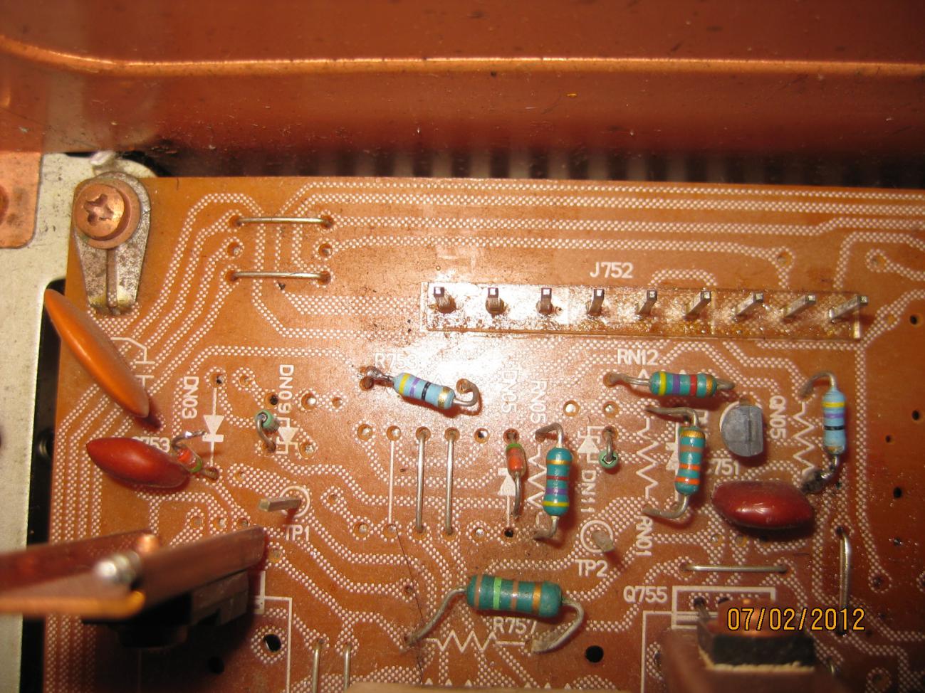

same amplifier different problem
Dear all,
I would appriciate your help to my current problem with same amp PM84 mkII. One channel is faulty and I have tried to replace several FETs but without longtime success. Actualy it last for several hours and suddenly right channel burn. Friend of mine is better electrical technician and we follow all specifications with bias tunning and did lot research and we have replaced meny parts but unforthunatelly without final result.
Could someone help out of his experiance or give any advice in what direction we should go.
Other problem is that SM scheme that I downloaded is bit different to mine amplifier. Therefore I can not find type of zener diode DN09 and DN11 (visible on picture). Colud someone help with this issue?
Thanks in advance!
Best regards and many greetings from Croatia.
Goran
