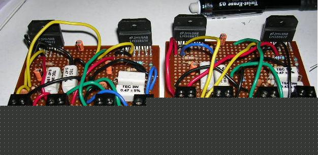

i would suggest making a pin 2 pin board instead of buying the kits.
kits cost more. and other thing is that the gainclones are so simple to build that u dont even need a pcb. Incase if ur building an amp with descrete components then maybe u need a pcb, but not here
that is if u have the patience to do proper p2p.
and be sure that u use good wires otherwise they'll smoke if ur tranny is big.
i have recently made a stereo lm3886 gainclone with p2p it sounds amazing.
if u want surround sound just make 5 lm3886 amps and add a common psu. ur trafo. should be more than 500va 20-0-20v.
remeber that after rectification the voltage increases by -- square root of 2 times.
that is if u use 25-0-25v trafo output is 35-0-35 approx.
so be sure to check the peak voltage of the chip ur going to use.
i am personnal thinking of building a surround amp. by useing lm4731. which a 25watt stereo. and they also operate at lower voltages. and if u want more power u can simply bridge the amp and get 50w.
u can even think of this chip. it will be easier. and sice ur just using the pc as the preamp, i would not suggest higher end chips like the lm38xx which operate at high voltages and will really need a pricy trafo.
