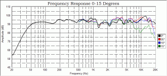

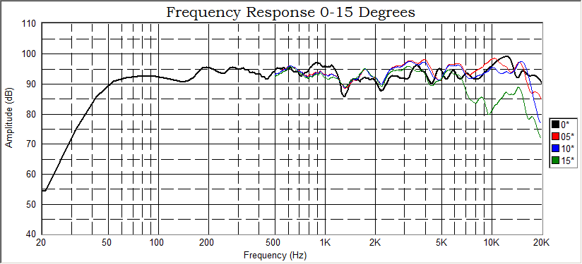

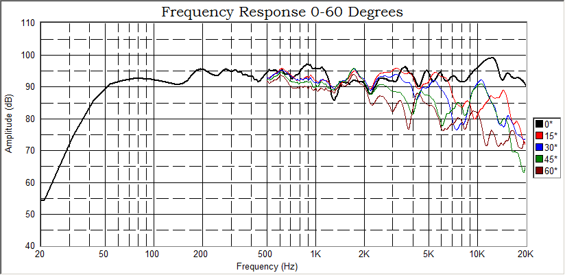

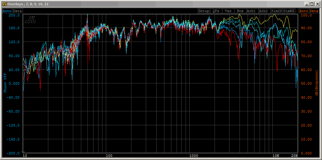

I've been working on a new MLTL cabinet for the FE166En since the FE167E went away and the 166 needs a smaller cabinet. I took the following at 0.5m in a large garage. Usually, I normalize all of the different angles to 1000Hz, but that did not fit what I was seeing, so I simple spliced at 500Hz. The bottom end below 250Hz is combined nearfield driver and port. I scaled the whole thing to match calculated SPL, so take absolute SPL with a grain of salt. All plots were smoothed 1/6 octave. (For those of you who insist that detail is lost in the smoothing, I added the raw plots.)
Above 500Hz, my on-axis plot agrees favorably with the Fostex factory plot. The 5* and 10* plots are darn near flat from 3kHz to above 15kHz. My first impressions of the 166En were that this is a very smooth sounding driver. I can see why. No peaks 5-7kHz and some 3dB of BBC dip.
So, for your enjoyment:
Hmm, as smooth as it measures and BB says it sounds, damping its little spikes runs the risk of raising any perceived sibilance at the expense of critical mids 'life', so doesn't seem like a good plan to me.
GM
Hi Bob, maybe it is, I guess, due to the FF166En has a higher distortion figure, so that loses favour of yours. Frankly the measurement pictures impressed me very much. For a long time, I have been looked for such a driver, but only find it here. And you tell me that yours are still in boxes, do you mean unpacked? Looked at the FF165WK datasheet. Compared with FE166En, the FF165WK looks less efficient, but extends further in the supersonic range. I have got an impression that high efficiency rarely go with low distortion side by side. That might be the case here for FE166En. By the way, what other full range drivers that you would recommend for listening to Rachmaninoff and/or Chopin's piano works? Thank you.

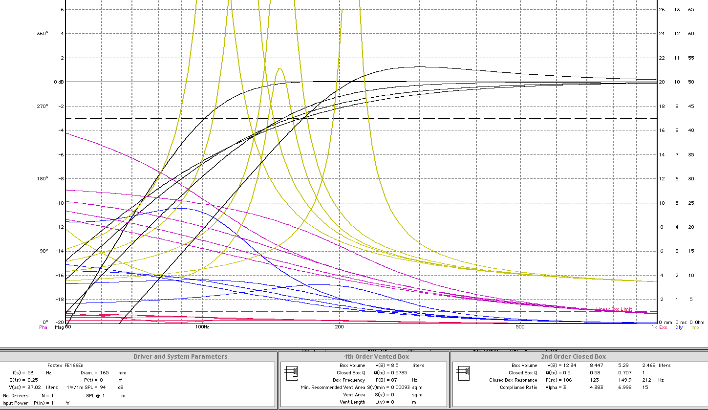

Here is your sim, standard set of sealed boxes and a sensible BR.
attachment.php
dave
