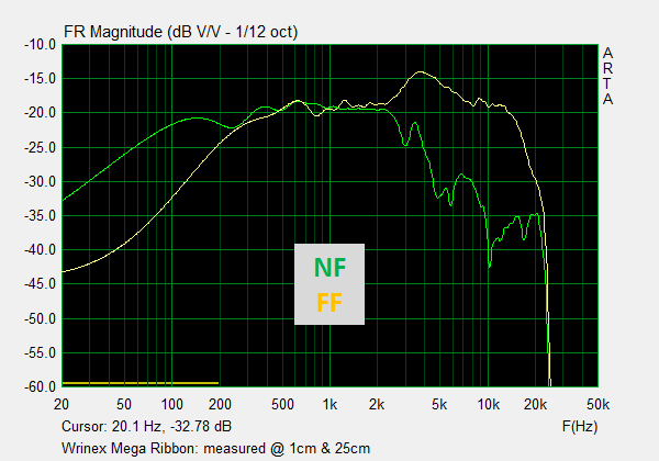

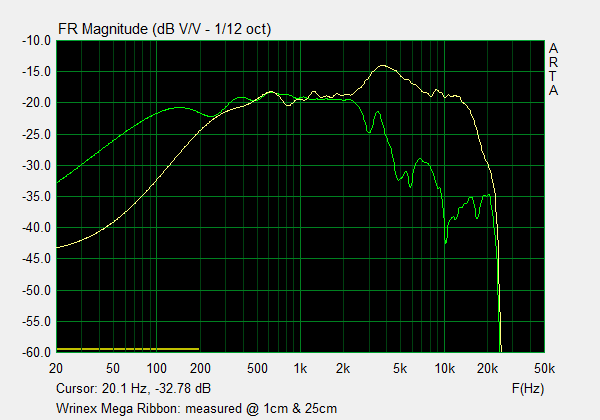

Here a 1 cm distance measurement.
Thanks for the NF measurement 🙂
Comparing with the FF measurement really makes we wonder what is causing the 3-4kHz hump in the FF response. I thought perhaps baffle diffraction, but if the size is as 15cm x 20cm I don’t see how that is possible. You are running it as a dipole correct?
My experience leads me to think the 3k hump may be bending mode of the rigid corrugated structure that is nulled out in FF.
I would move the mic around in front of diaphragm ( close mic )and see if that hump is gone in some areas of diaphragm (a null point)
you may need to get the mic really close to see it, like 10mm

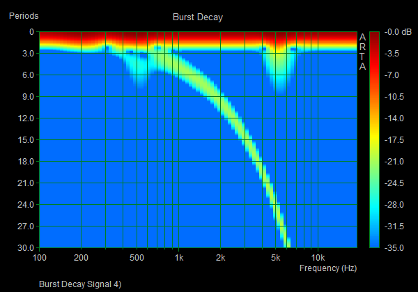

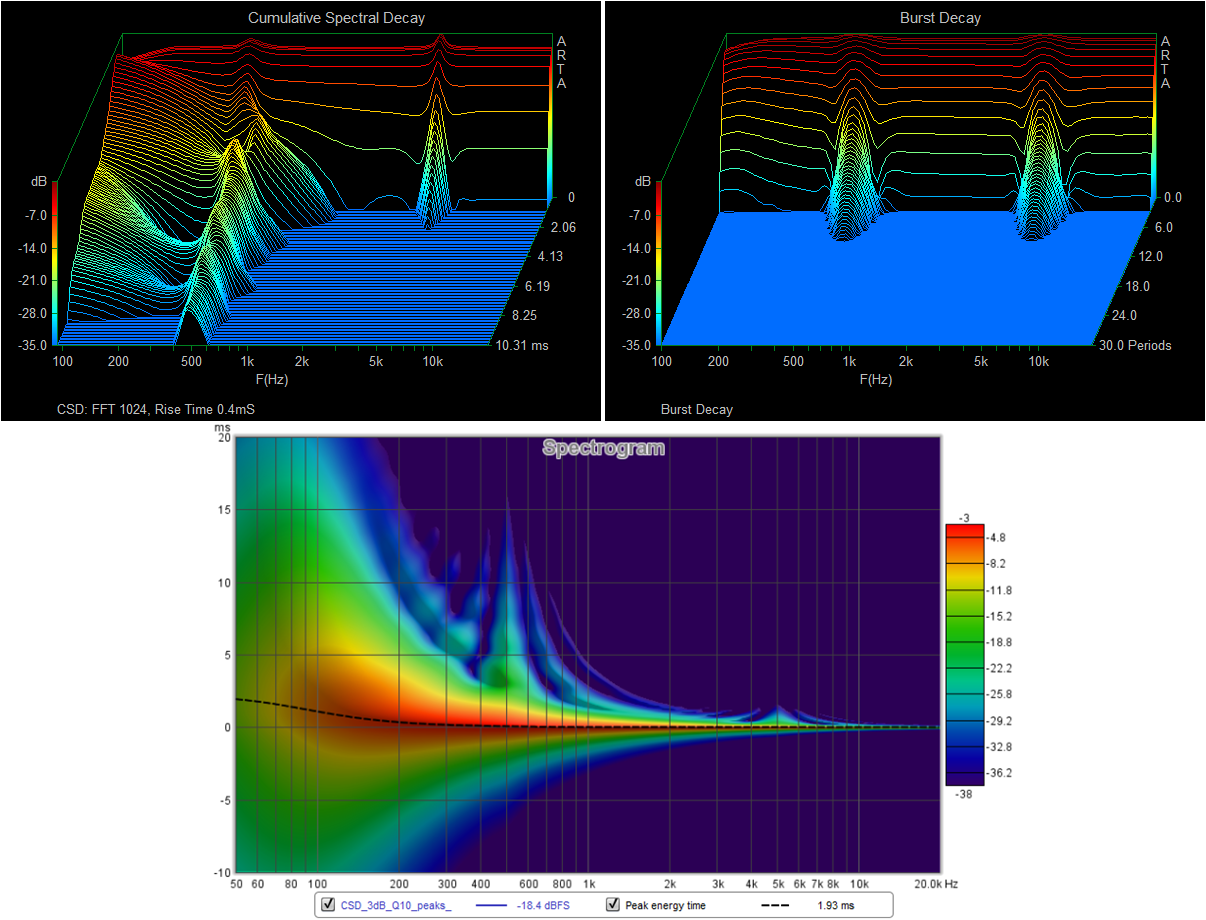

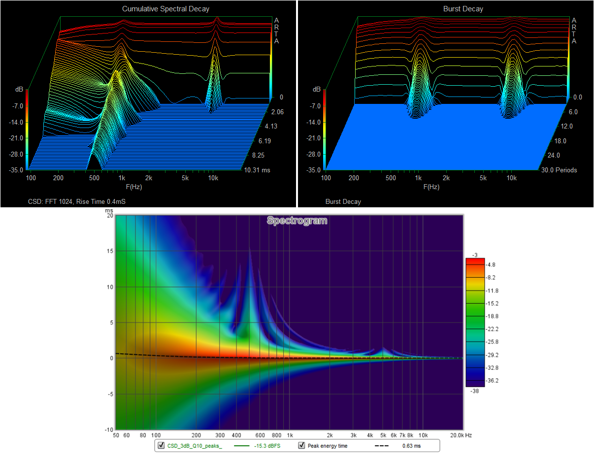

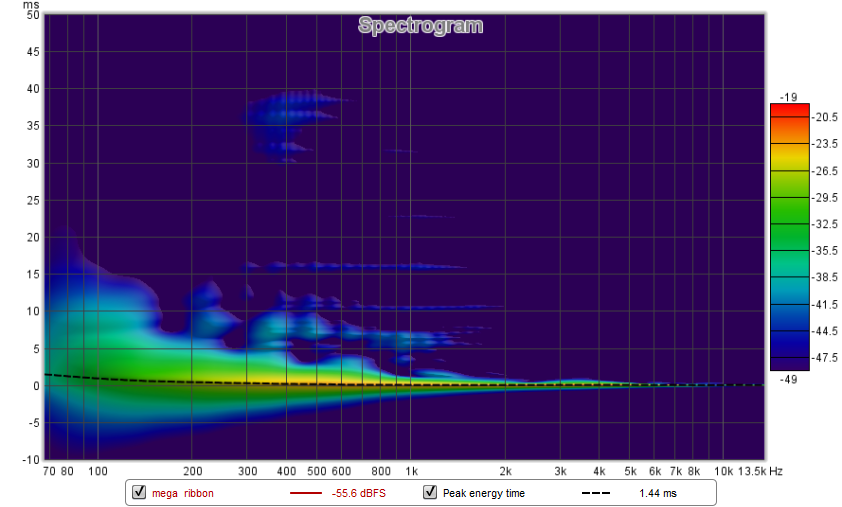

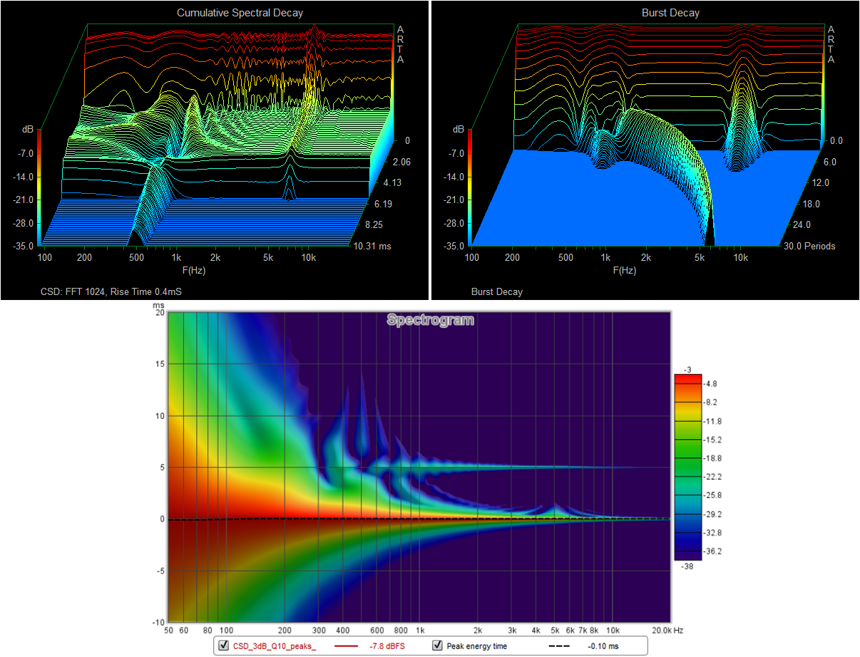

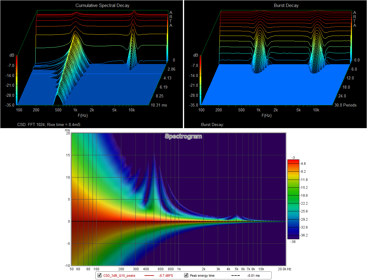

... put together a few different plot trends to help explain what the different CSD settings do and how best to use them. Will also try to explain the pros and cons of CSD vs Burst vs Spectrogram
To compare and contrast the information displayed by CSD, Burst Decay, and Spectrogram plots I decided to create a set of 4 test signals.
Attachment #1:
1) Flat response with +3dB/Q=10 resonances at 500Hz and 5kHz
2) Same as 1) + first order HP filter @ 100Hz
3) Same as 1) + second order HP filter @ 100Hz
4) Same as 1) + reflection at 5mS and -20dB level
Attachment #2: Plot Comparison of signal 1)
CSD clearly shows the two resonances, but the 500Hz looks more severe because CSD has resolution that decreases with frequency. Also, since display axis is time, lower frequency resonance that decay in the same number of cycles as higher frequencies will look like they are worse as they hang on all across the plot. By comparison Burst Decay shows both resonances with equal resolution dying out at the same rate. The Spectrogram is a mix in that it shows both resonances at the same width(ie resolution) but since display axis is time, again the lower frequency resonance looks worse.
Attachment #3: Plot Comparison of signal 2)
Adding a simple first order HP filter 2 octaves below the resonance is pretty disruptive to the CSD plot making it look like there is another resonance involved. This is often the cause of the LF messiness of published CSDs. The Burst and Spectrogram plots look mostly unchanged as they should be.
Attachment #4: Plot Comparison of signal 3)
The second order HP filter is representative of the natural roll off of most transducers. Again, the CSD display could easily be misunderstood. Note in the Spectrogram the dashed line following the peak energy gives you a visual display of the group delay. This can be quite useful in more complex systems with crossovers.
Attachment #5: Plot Comparison of signal 4)
Most measurements we take include some reflections. If not windowed out, they can add shelves or steps in the CSD plot depending on the length of the FFT window. Usually they have a rather mottled or boiling appearance. The Spectrogram will clearly show reflections as horizontal bars, as shown at the 5mS time axis. Reflections show up as curved traces on Burst Decay plots since signal is plotted in cycles not time.
Attachment #6: Alternate Burst Decay plot of signal 4), which often makes it easy to see you have a resonance AND a reflection happening.
Attachment #7: Your 25cm Mega Ribbon measurement shows a few reflections arriving at roughly 6mS, 10mS and 16mS.
Let me know if you have any questions.
Next posting(tonight?) will go over each of the settings for the each plot type and show how they affect what is shown.
Sorry, I should have labeled the plot curves. The 3K hump is in the FF, not in the NF.
I agree about the possibility of NF measurements picking up local peaks from resonance modes in the diaphragm. Not sure if you had seen it, but I posted some plots and a short video showing model behavior using NF measurements along the length of an ESL pretty much all of which cancel out at the FF listening position. Another segmented ESL
Yes its running dipole. Further in the room the peak is less.
Ok ill try that this weekend !
Attachment #1:
