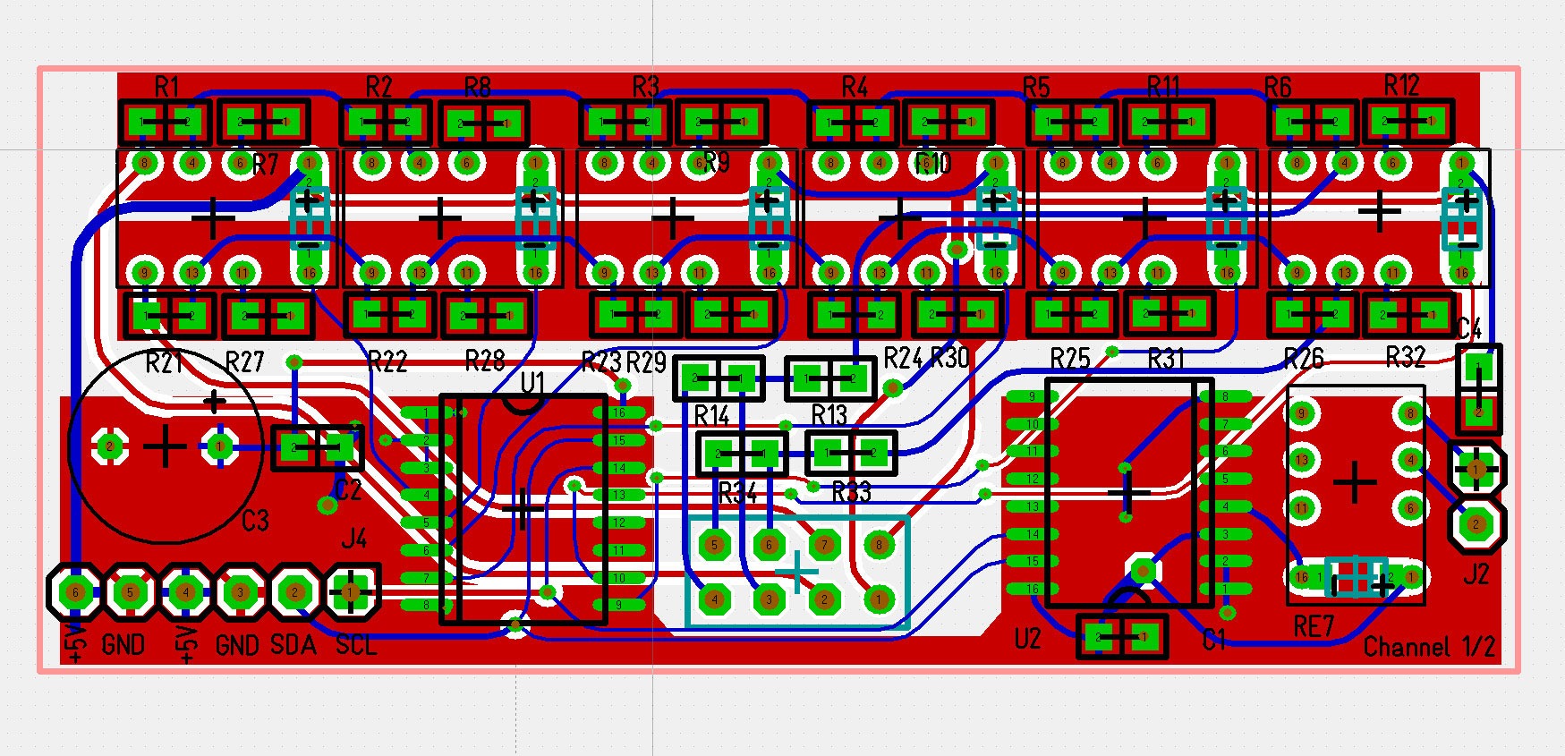

I use it for several years without problem as my daily pre, after that i built a dam1941 and used the integrate volume controller, no i nearly stop using the bpbp but keep it "in case". Approx 6 month ago i get a new chassis for it, to make a cleaner build. I tested if everything was ok and it was working fine. A few days ago i assembled a dsc dac, so i needed a volume controller. Surprise, the bpbp wasn't working, so i did some check.
The first input have a very low sound, second input no sound at all. The maya is powering up but changing the attenuation doesn't do anything, i also don't hear the usual little "click" noise of the relays in the hans board when i change the attenuation. I check the connection but i don't see any problem... and again nothing changes since the last time when it was working.

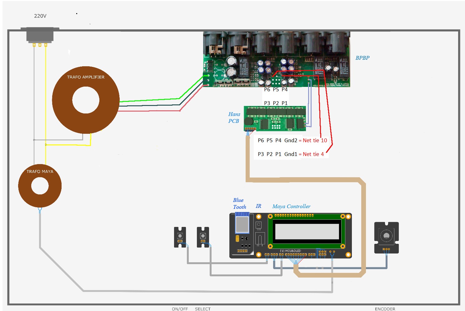

In my build i use a custom transfo with 13v dual and the hypex low noise reg. Speaking of the hypex reg, they seems to power up as usual as the led are powering up.

My uneducated guess is the problem doesn't come from the bpbp or hans pcb. The maya control the switching of the bpbp input and the relays of the hans pcb. The fact i have no sound when i connect something at the input 2 seems to indicate the maya do not toggle input 2, same for the hans pcb, attenuation is stuck to maybe -40 or -45 db.
