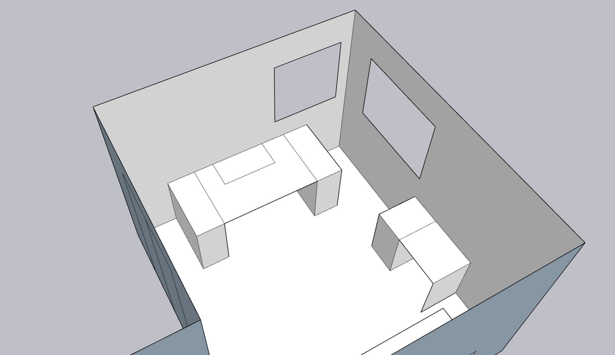

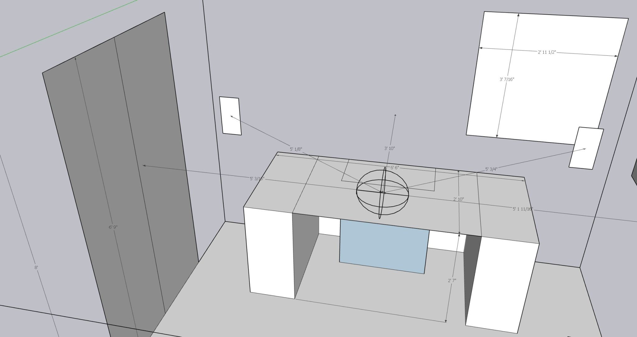

Hi all!
I'm hoping you'll be able to point me in the direction of some resources to help with a project I'm looking to take on.
To start, I have a degree in electrical engineering and have taken numerous analog electronics courses and a specific course on speaker design that included crossover networks. I am comfortable with the underlying theory of this wide world of DIY audio but not sure where to begin with applying it for my own needs.
I have plenty of tools for electrical and woodwork and access to a maker space at my university with anything else I might need. Consider my time free because I will enjoy the journey; I'm looking to get as high performance as I can with as little actual money spent, meaning besides the drivers, I'm open to building anything and everything if it's cost-saving without reducing performance significantly. If I can stay under $500 that would be ideal.

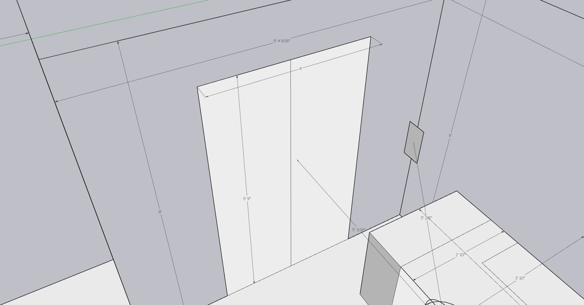

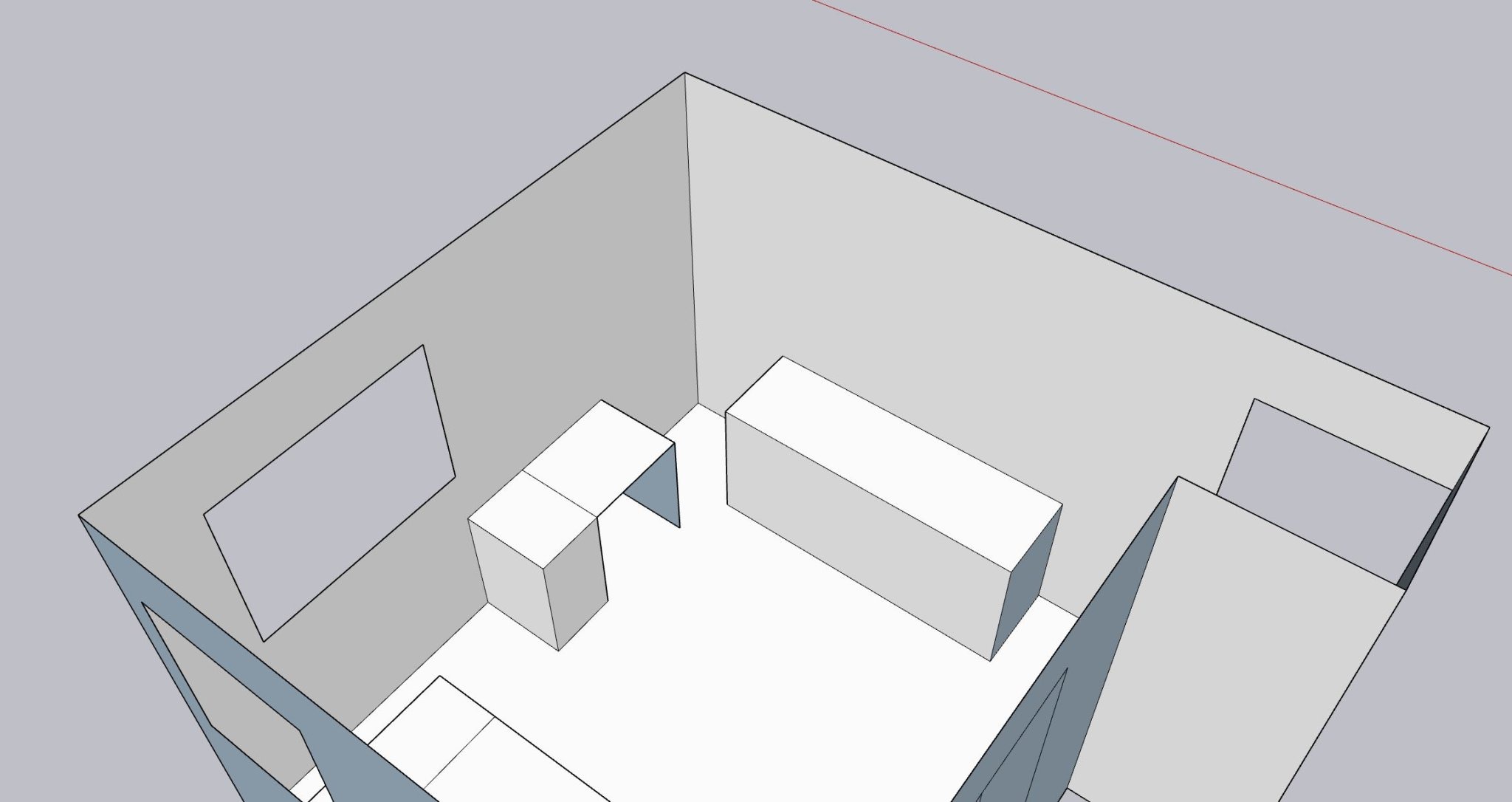

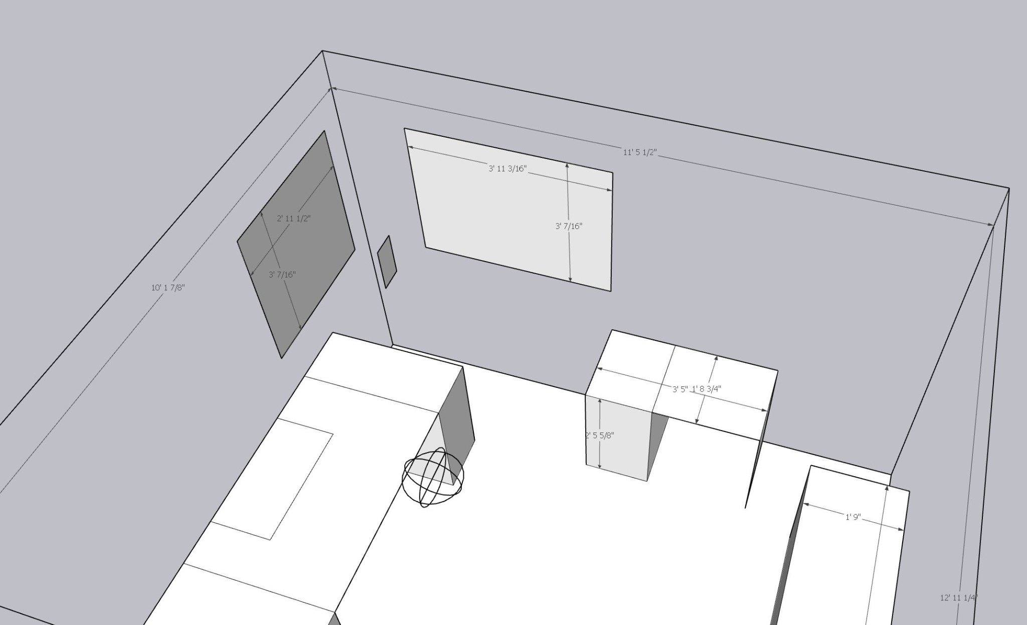

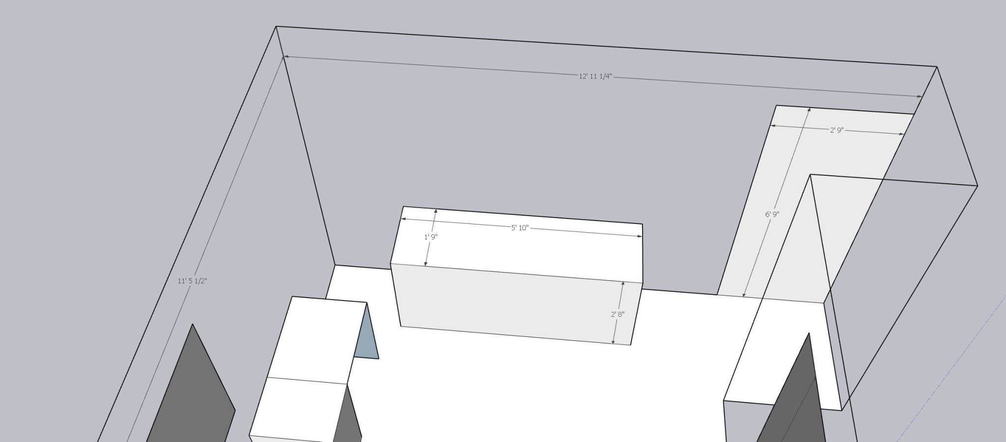

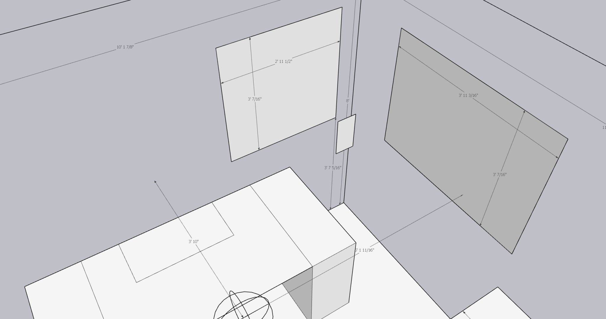

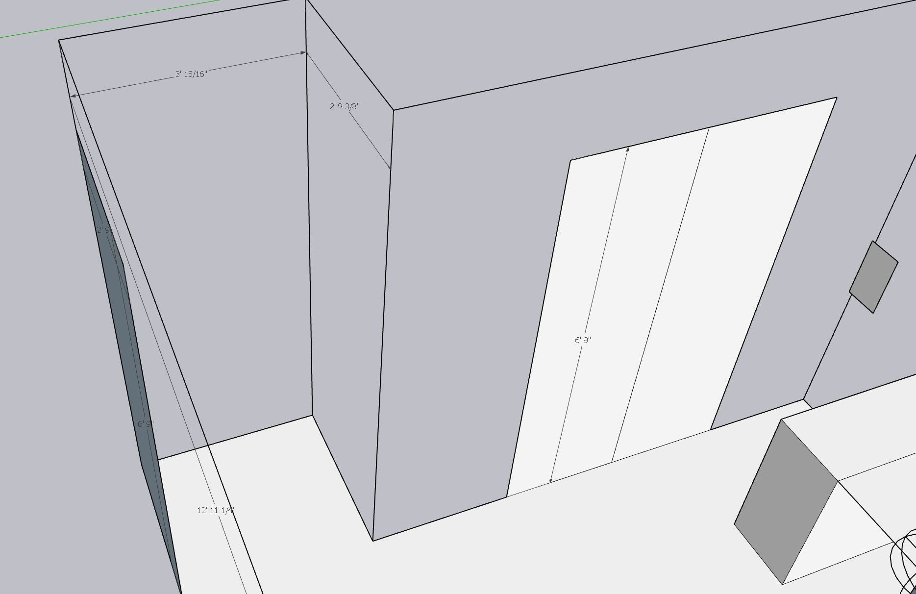

Background out of the way, I'm a bedroom DJ looking for either 2.0 or 2.1 studio monitors. Below is the layout for the room I'll be in with windows, doors, and current furniture. I realize the size and window placement are going to be somewhat of a nightmare, but I'll work with what I've got. The floating circle is about where my head will be.
The room is currently untreated, but I have a reference mic and will use REW to work on that once I have the system built.
Hopefully this covers everything, but if I've overlooked anything please let me know!

I would move the speakers closer. Cover the side walls with blankets and drapes. Put carpet down. For speakers I would use a 4-6” full range or a WAW with a 3” fullrange to an 8” woofer. You could use the more typical 1” tweeter with a 5-6 1/2” woofer format too. I think you need to do more research to find what you need. You are in the right place, there will be lots of suggestions here.

I would move the speakers closer. [...] I think you need to do more research to find what you need. You are in the right place, there will be lots of suggestions here.
I could bring them up some, but getting anything closer than ~3ft would most likely break the spouse approval based on where they'd end up standing. Agreed there, I'm already piecing together some ideas based on the feedback so far!

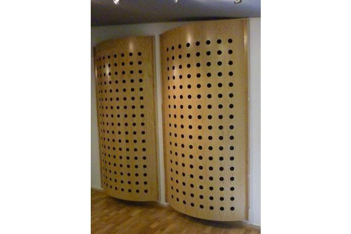

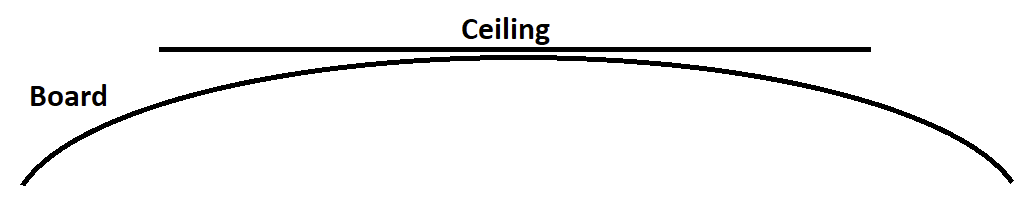

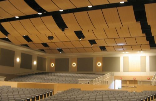

For the cloud, I'd been thinking of just a box above me, but the curved plywood sounds interesting. I'm not able to search accurately for what I'm imagining, but it's not something like this, correct?
What I'm visualizing is a very wide / gently curving parabola with the apex mounted to the ceiling, something like this:
Why? You don't want to lose volume, at least in that place.
Exactly like that but upside down. The bend goes down not up. You don’t want to focus the sound you want to diffuse it and absorb it. The large area will damp bass and you can add fiberglass on top to change the frequency. Like these but on the ceiling. The holes absorb midrange frequencies, you don’t necessarily need those. The large area absorbs bass the smooth curve diffuses the mids and highs. In a 10x12’ studio you can put in one 4x8 and two 3x8 diffuser/absorbers on the ceiling. Skyline diffusers don’t do much in a small space, they look cool though. Look under room treatments for some more ideas. Here’s a word of caution, the better my room got the worse my speakers got. My speaker building got a lot better
These diffusers are bent the long way. Auditoriums use them for a different reason, to bounce the sound evenly around the audience.
This is a cloud cluster to stop echoes in an area with a high ceiling. You might want to try something like this directly overhead.
