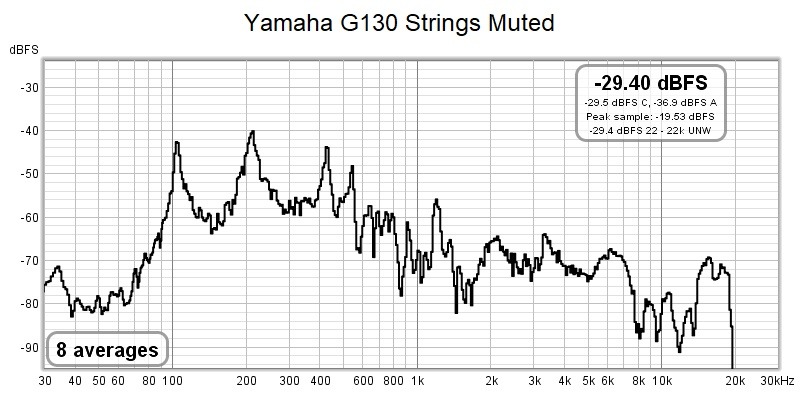

Here's an older Yamaha I picked up recently. This one "tunes" to concert pitch; that peak just above 200 is 219 Hz.

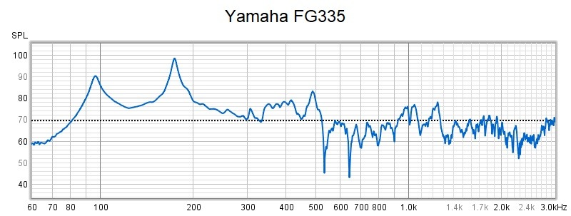

Here's a Yamaha FG335 lefty dreadnaught I bought for my son as a beater, so he can stop taking that Gibson out of the house. It's peak is remarkably lower than the other guitars I've measured and at 174 Hz, remarkably close to concert F at 174.61.

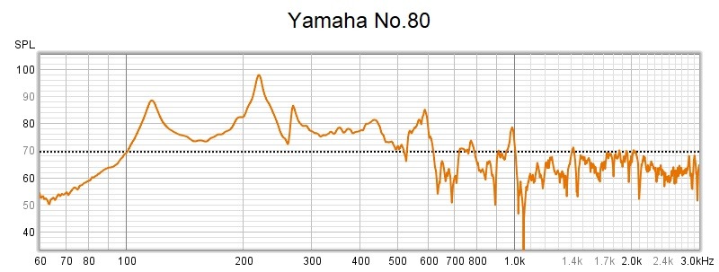

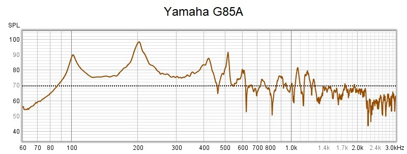

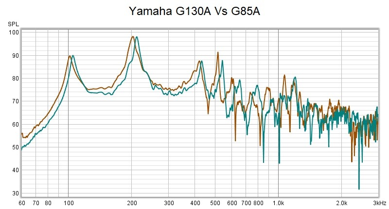

And my G130A (higher resonance; 211 Hz) vs the G85A's "202". What were you doing, Yamaha? If I get the G280A - top of the line "G" in one year's catalog - would I get 110, 220, 440, vs 105, 211, 432? In this old G series, they have model "values" from 50 to 280, the higher the better. I wonder if they built the guitars intended for a certain class-range first, then graded and labeled them? Probably could have used a tuning fork and see how loud the guitar's body speaks when excited.

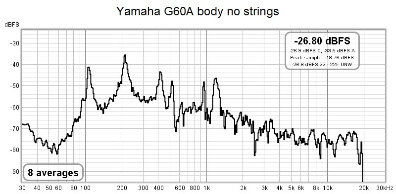

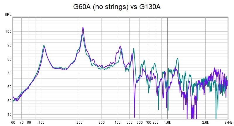

Alas, if I put my G60A over the top of my G130A... There's no string tension nor bridge bone in the G60A. My Wife and I dont think it sounds as good as the other two G series guitars, FWIW. However we think the old No.80 sounds pretty good.

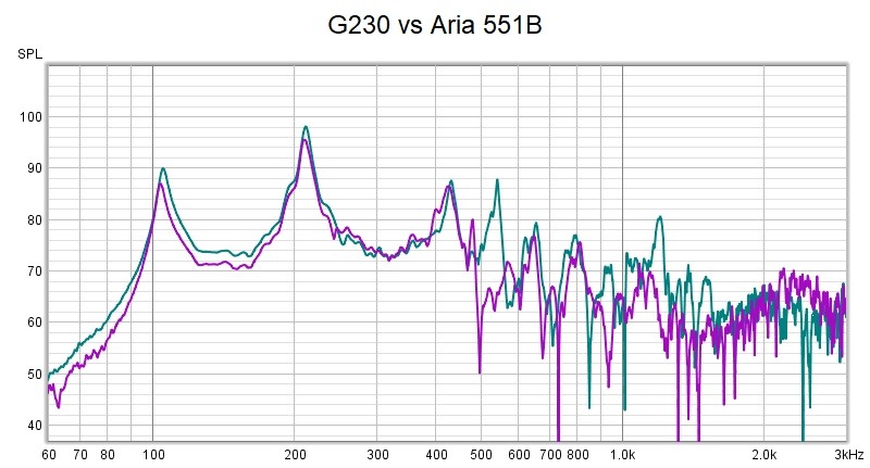

The Aria A551B (purple) vs the Yamaha G130A; quite similar for a couple octaves, at least... Both resonate just short of concert pitch; both are good sounding guitars AFAICT. Maybe one day I'll get to hear and test a "good" one.

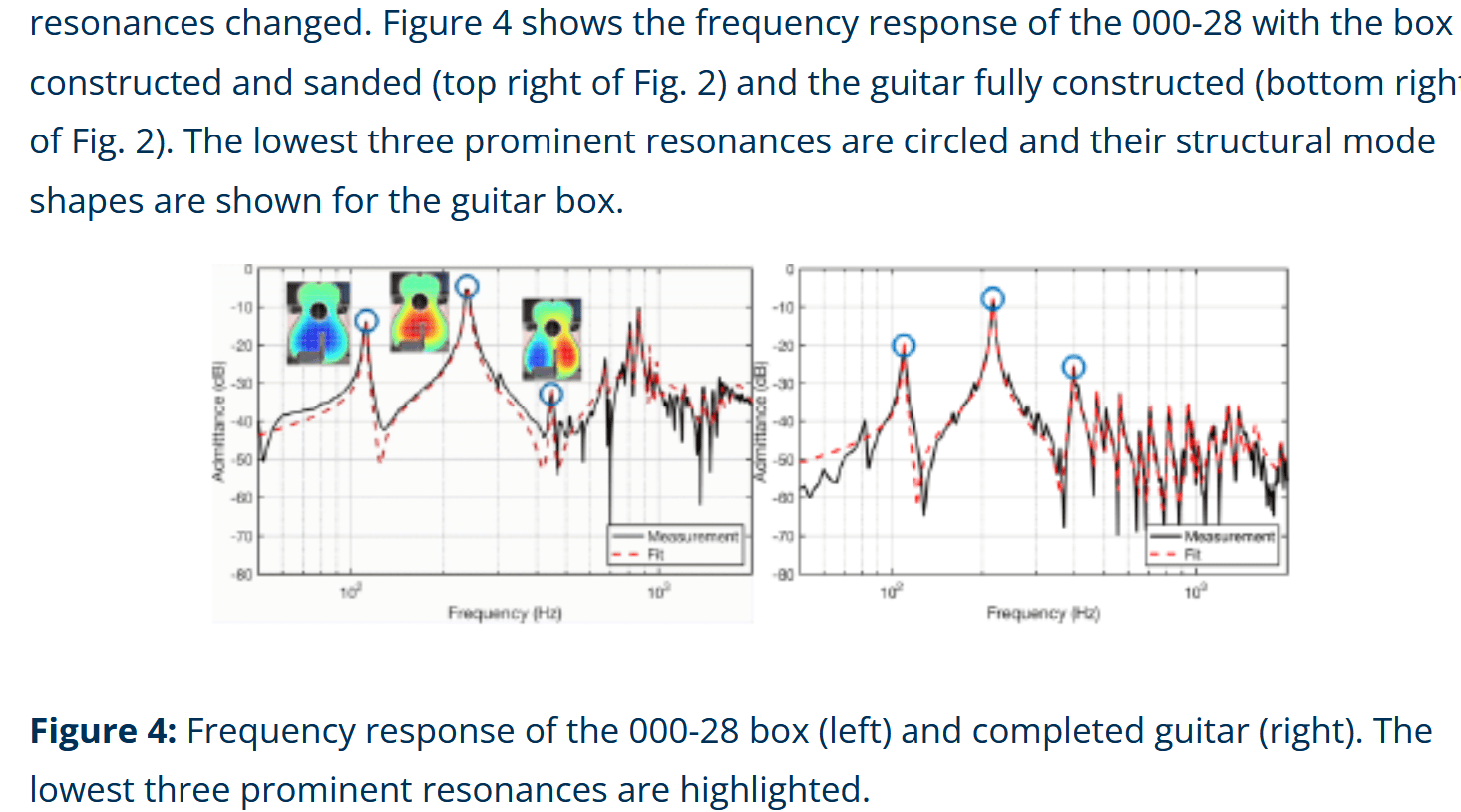

Looking through the we I found "Measurements and Analysis of Acoustic Guitars During Various Stages of Their Construction" a 2021 ASA paper by Mark Rau. Let's just say in his measurement setup, he's using better equipment than I have access to. I couldnt download the paper .pdf. Perhaps I can ask.
Yet I'm pleased to see in his analysis, there's distinct similarities to what I'm getting. The guitars he tested are probably good guitars!

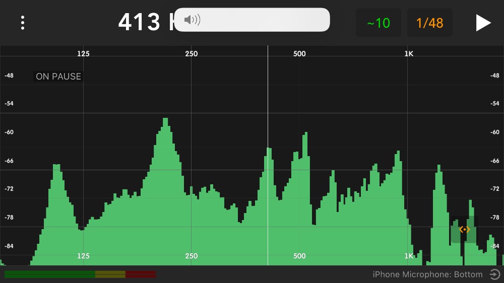

Finally, with the very slightest "what if?" effort, I fired up the iPhone app "Spectrum-Eye" and made a pink noise plot of the Yamaha G-60A body. Then, noticing a switch in the preferences panel "Pink Noise Generator", I enabled it. Connecting the little Dayton exciter directly to the headphone output (iPhone 6S+), it made audible noise. Turning the volume up about 3/4, it made enough sound to produce the following plot;
It's conceivable that one could screen guitars for how they sound in this way - at least for the triple peak part - and where those fall relative to concert pitch - with just an (old) iPhone, Application, a Cable and Transducer. Of course, the analysis isnt entirely definitive, but if I was able to put that Alvarez to this test, knowing what I know now, I could have avoided a disappointing purchase and subsequent sale cycle.
Furthermore, if the old iPhone has enough snot to drive a 4 Ohm transducer and get loud enough to make a sonic picture in Spectrum Eye, it's entirely conceivable one could test * Ohm loudspeakers they happen to stumble upon in this way. At least you'd quickly know if one of a pair is blown, when one has no output above 2kHz and the other does.

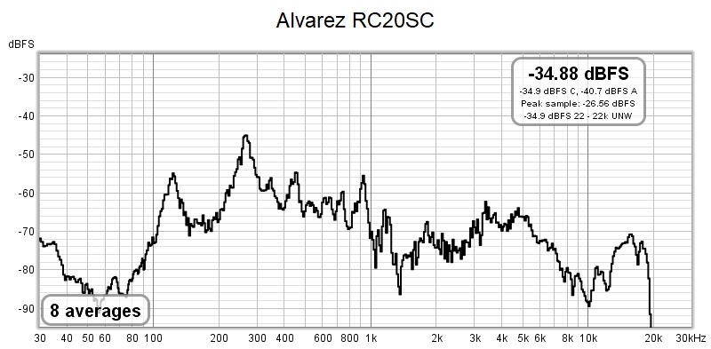

Now let's look at that guitar I didnt particularly care for;
It's clear that the body resonances are shifted higher in the construction of this model. One wouldnt think so by looking at it - it's got a big, deep body. I've read on line that there's pretty much nothing one can do, without risk to the guitar's mechanical integrity, to change this. Better off to sell it and just get something you like.

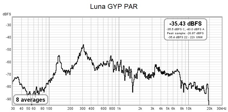

I have a guitar that's labeled a "parlor" model, a bit smaller in size. One would expect a higher frequency comb pattern. Let's see;
Sharper yet, with a discernable notch even at ~440. My wife and myself doesnt think this guitar sounds particularly good. Hmmm....

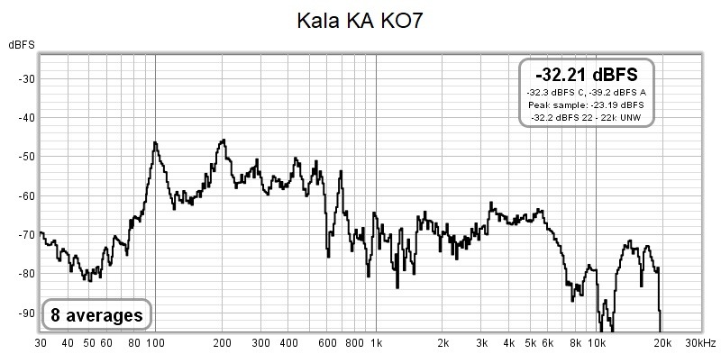

I also have a Kala nylon, which I picked up at a yard sale where someone had a whole pile to pick from. Its bridge had torn free, so I epoxied it back in place. It tore off again a couple few years later, so I really laid it on thick for the repair. It's a thin line body, I'd guess all mahogany. I really like the way this one sounds; it's my favorite to play; of course, this particular guitar is unobtanium - there's one steel string variation I can find anywhere.
Clearly this one has resonances flat from the "110" sub-multiple of the A440. So the "A" ends up just on the integrating side of the bandpass, versus the differentiating side. Interesting.

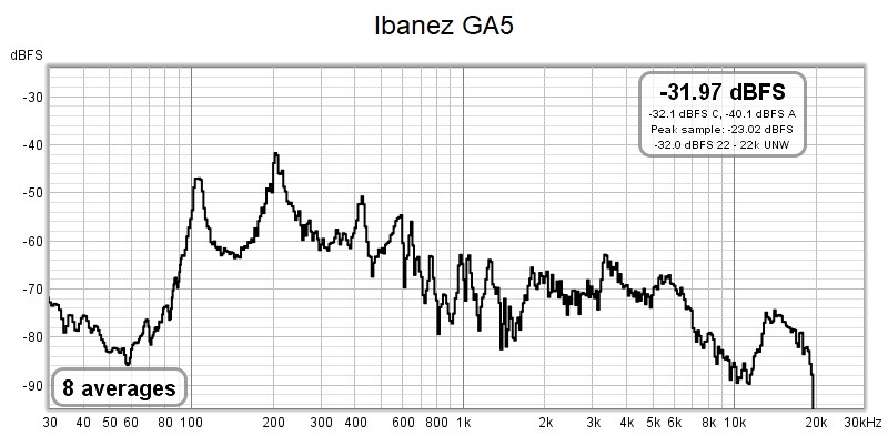

I also have a Yamaha "Silent" nylon string electric and an Ibanez classical, similar in shape to the Yamaha guitars. The Ibanez pulls off a pretty good copy of the Yamaha's "fingerprint";

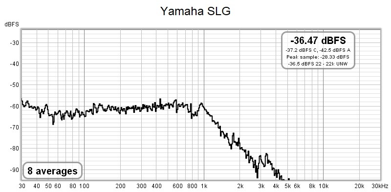

The silent guitar has signal processing for delay, echo etc and I wondered if they did any analog modeling of a guitar body, you know, to make it sound like an acoustic at the output jack;
Nope - but how interesting!

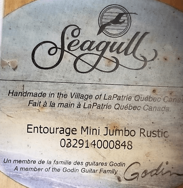

I got the Seagull after a visit to Guitar Center to pick up another instrument I purchased from them. I played one there and just was awed by how it sounded. I looked on line, saw one used for sale at another GC elsewhere and bought it; got a nice deal too. My wife told me last night "you should measure that one".
Until my measurement technique becomes standard practice throughout the industry (fat chance, eh?) I see no way to obtain a guitar that will sound good unseen, unhandled, unplayed. Even instances of the same instrument can vary in sound. Personally, I hate the upper-mid boxy sound of parlor guitars, though not all parlors do that. I have a rare Kala nylon thinline that goes deep - it's one of my favorites to play. Unsure if I could trust a YouTube demo - the Alvarez sounded fine to me on one vid, but when I got it, everyone in the house could hear something was very off.
Well, thus started the investigation so far. Would have saved me a lot of money and obsession if that particular instrument just "sounded like the Seagull".
