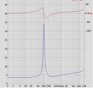

preliminary measurment data....more to follow
Preliminary results of the 5 inch extended range driver (1" Kapton voice coil, full copper sleeve, coated paper cone, 5mm lin-Xmax p-p )........
1) The near field test was done from a distance of .5cm from the cone surface.
more results to follow......
