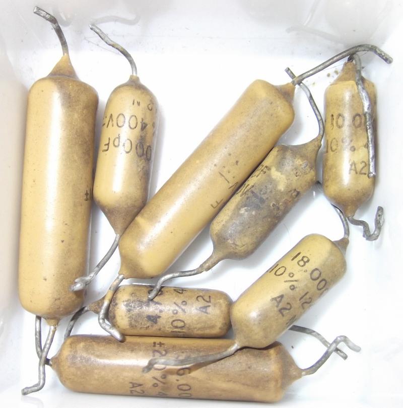

What I would do is to check C21 and C22 and in most cases they will need to be replaced otherwise they will destroy the audio transformer and valves. Perhaps also replace C25 and C26 but these are less important.
There is only one safe type of capacitor that rarely needs to be changed out.
These are known as Mullard Mustard capacitors and hardly ever fail. Check that they are the type shown in the photo and replace them if they are not this type.
Always replace wax and tar types if seen in this position.
Use yellow 630 volt types only from reputable suppliers as replacements.
The cartridge will be dead. They absorb moisture from the air over the years and the output fades out.

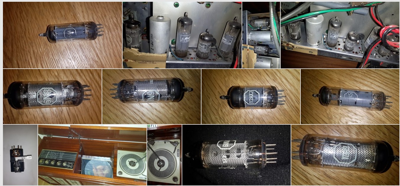

A photo of the under side of the chassis where the 6M8 valves are would be very helpful so that I can identify the type of capacitors that are fitted in the C21 and C22 positions.
I will then be able to see if they are types that need to be changed out or not.
If they are faulty the 6M8 valves and the transformers could overheat and burn out. The sound does not distort until it is too late.

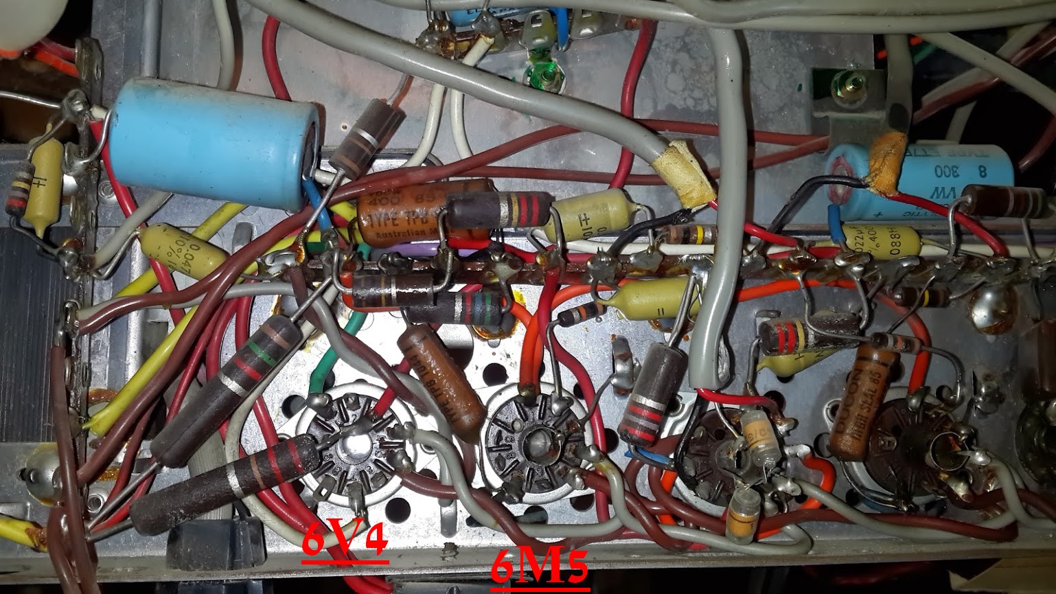

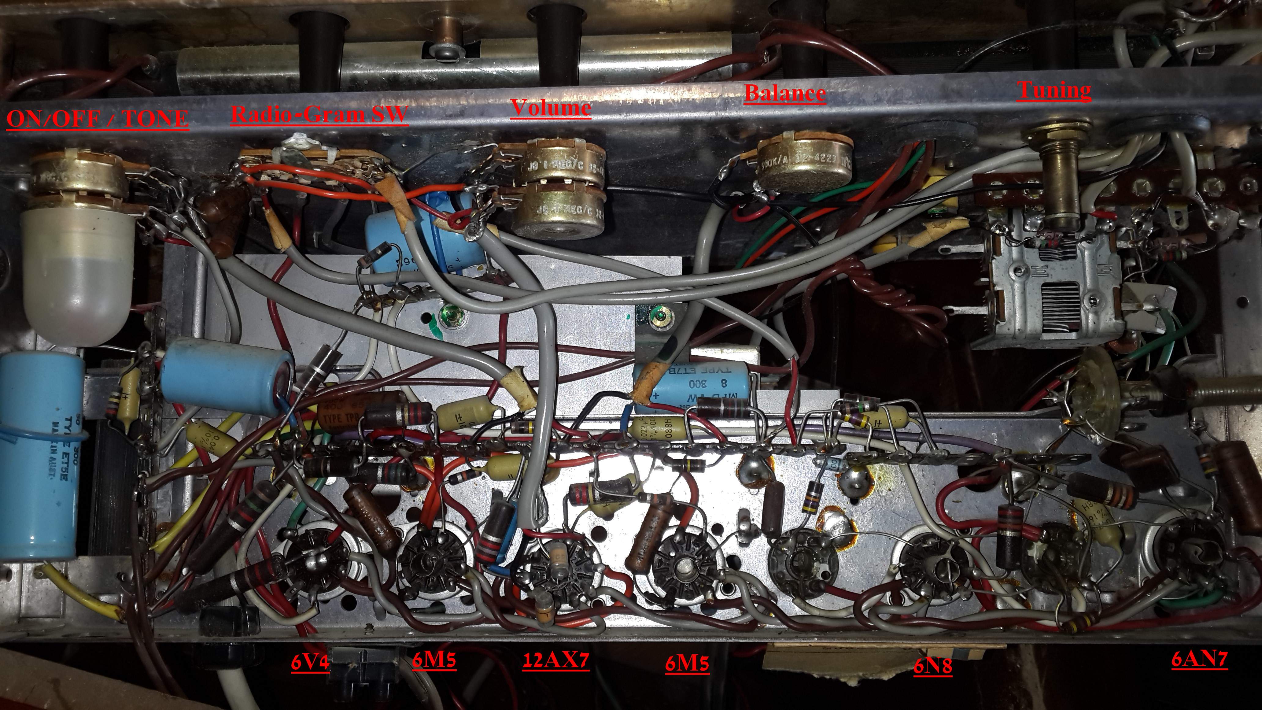

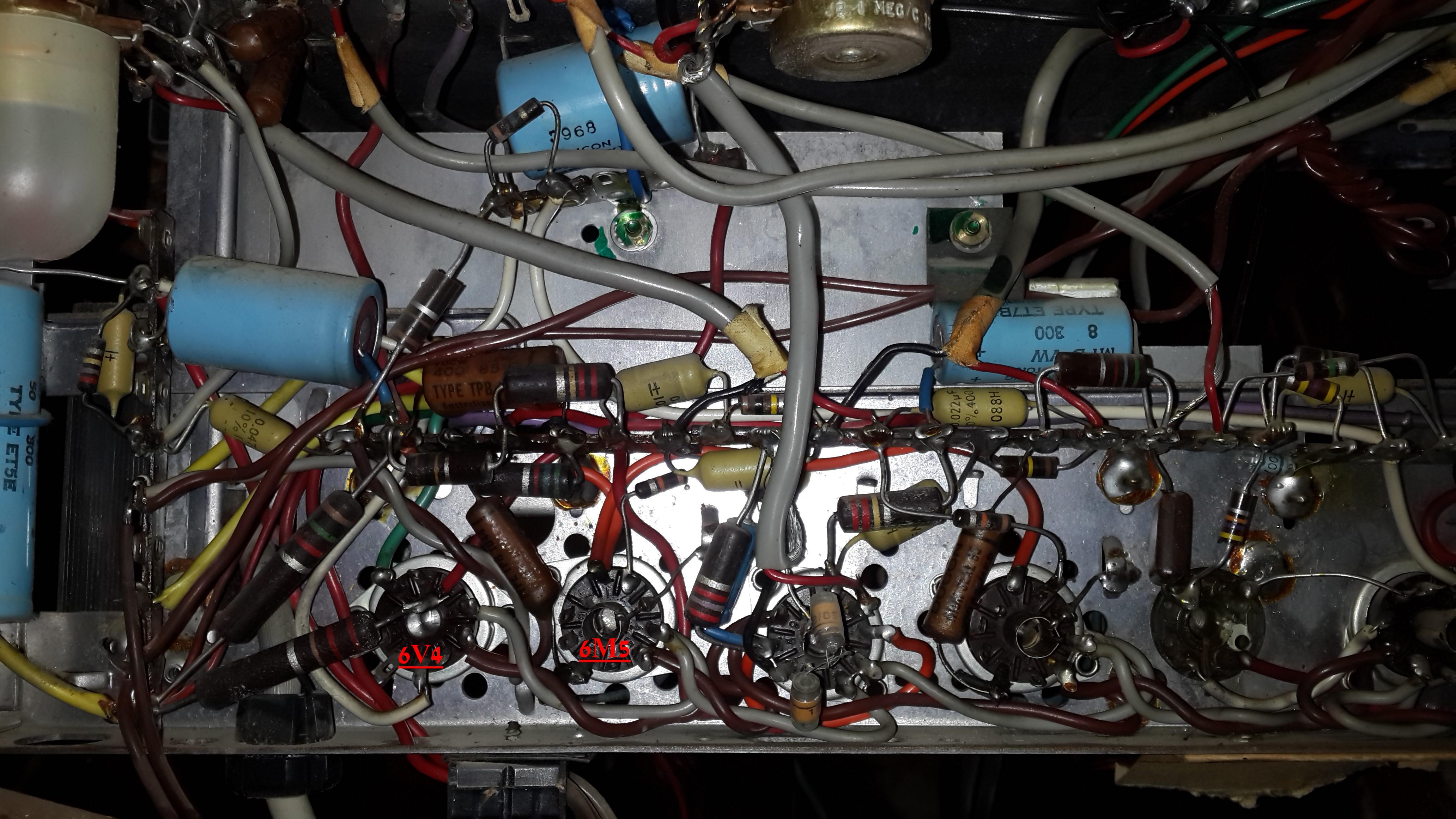

Hello !
i've attached a photo, i hope the resolution is enough for understanding..
thanks again
and another close up to 6v4 , 6m5
With all the power off, and the switch set for phono, do you have an ohm meter to measure the resistance from the top of the volume pots through to the jacks J1 and J2 and then to the 2.2M resistors going to the cartridge? This would indicate if the switch and jack switch contacts are ok, and that the 2.2M resistors are ok.

From the photos C21 and C22 look like Mulladr Mustard types and will be fine.
There are three tone correction capacitors that look like the old wax types and these will go leaky and make the sound tinny.
They are C25 and C26. Also C28 in the tone control bias.
They will not do any very nasty damage if they are a bit leaky but they could get very bad and burn a resistor if the set is run for too long with them faulty. Replacing them will improve the tone control operation.
All the others are good types and should be fine.
Those 2.2M resistors will make the gram sound low and very tinny if they have gone open circuit.
