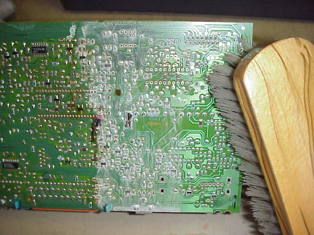

I use pure methanol.
Indeed the pcb becomes grey/white.
I rinse it with methanol after scrubbing it very well with the brush. Polishing it with a hard brush makes it shine like new.
Left of picture unwashed, middle washed and right washed and polished with my favorite brush.
Some may have other tricks, I'd be happy to hear them.
/Hugo🙂
The picture is a great help. The methanol sure does seem to work!

Hugo,
the middle/right part of this PCB looks like if You haven`t washed clean enough.
When You brush or polish those areas (as on the middle of the PCB) this does not mean that You have removed the flux entirely - it just looks nicer.
I use spirit (in German it`s called Spiritus, not sure if "spirit" is the right word in English, ) and a stiff (shorted) paint-brush to wash my boards. After washing once, sometimes areas of the boards still look similar (those white veils) to the middle part of Hugo`s PCB on the photo - this means there is still flux residue and I repeat the procedure. Sometimes in extreme cases I have to repeat the spirit washing several times.
Spirit is cheap and not aggressive - it never happened to me that the spirit solved any kind of parts plastic materials - most other solvents are much more aggressive (in contrary for example it happened to me with a special flux-cleaning liquid that it solved some plastics).
After that I apply ordinary washup liquid (also with the brush) onto the entire board and brush it until it is very spumy and then I flush the boards with hot water.
Then I dry the board with pressed air until even the smallest drop of water has disappeared from everywhere (also under parts etc.).
After this the board looks perfectly clean and shiny without the slightest white veil of flux (or any other) residue.
The washup liquid takes care that the water drops off from the board easily (just like You do when washing up a wine glass very clean).
Thereafter I put the boards on a warm place (sun, heating, radiator etc.) for some time.
The repeating washing with spirit may take some time but it`s save regarding solving plastics, it`s not toxic (well, it doesn`t smell perfume but it does not have such penetrant or toxic odor as many other liquids have) it gives excellent results and it is cheap.
