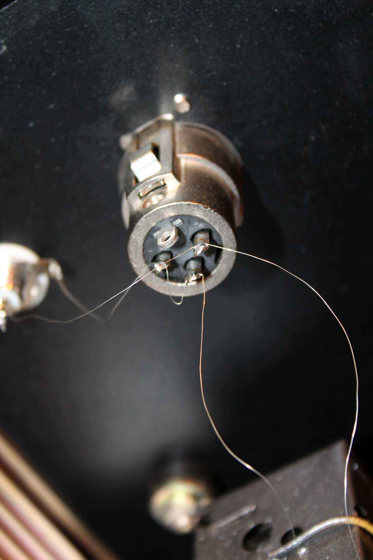

regarding #5 - I'm using spongy rubber for that , strictly as anti-zzzzzz procedure
while for #7 there is sole proper solution 0.1mm dia silvered copper , nude or tefon isolated twisted :
