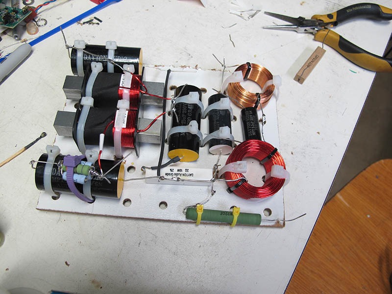

I have been working on these cabinets, finished the veneering a week ago.

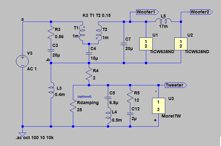

The design was subject to a modification by Modafferi to incorporate his XO design (infinite slope).

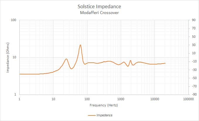

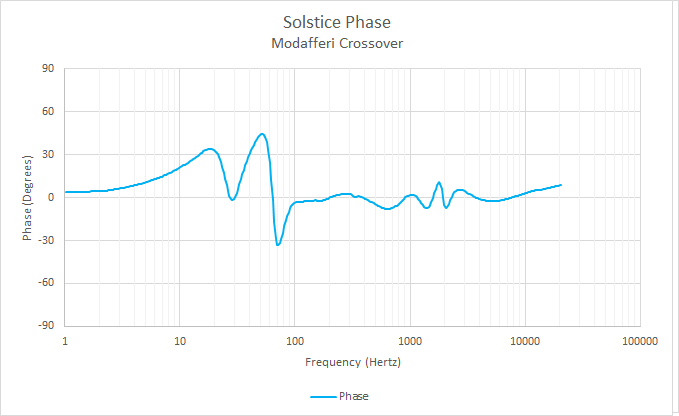

I have both XOs. Just to illustrate the electrical responses:
