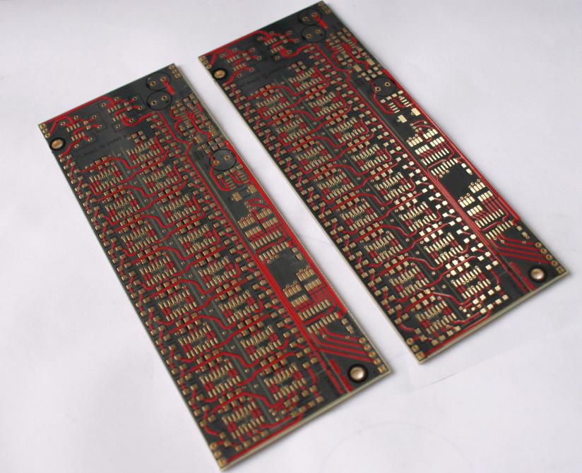

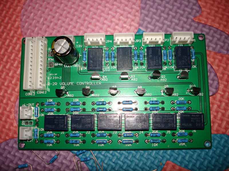

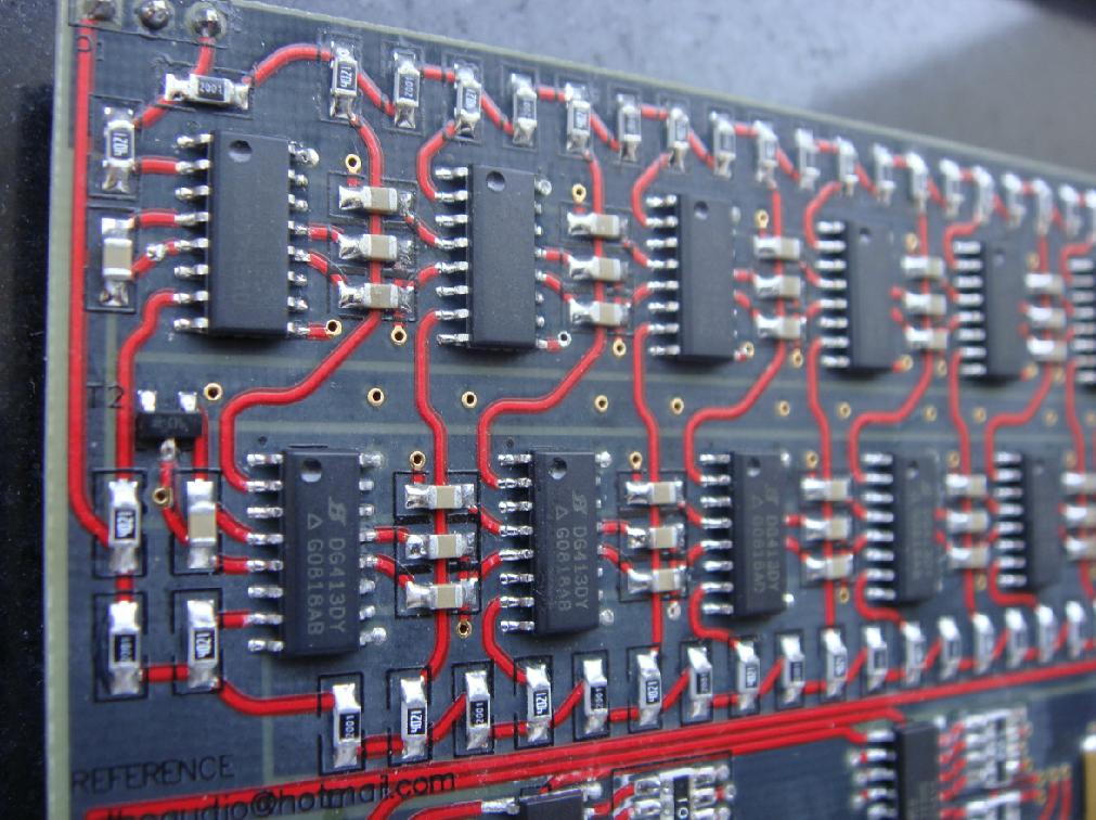

How about my attenuator ?
It based on R-2R network , but it has a high output impedence 🙄
